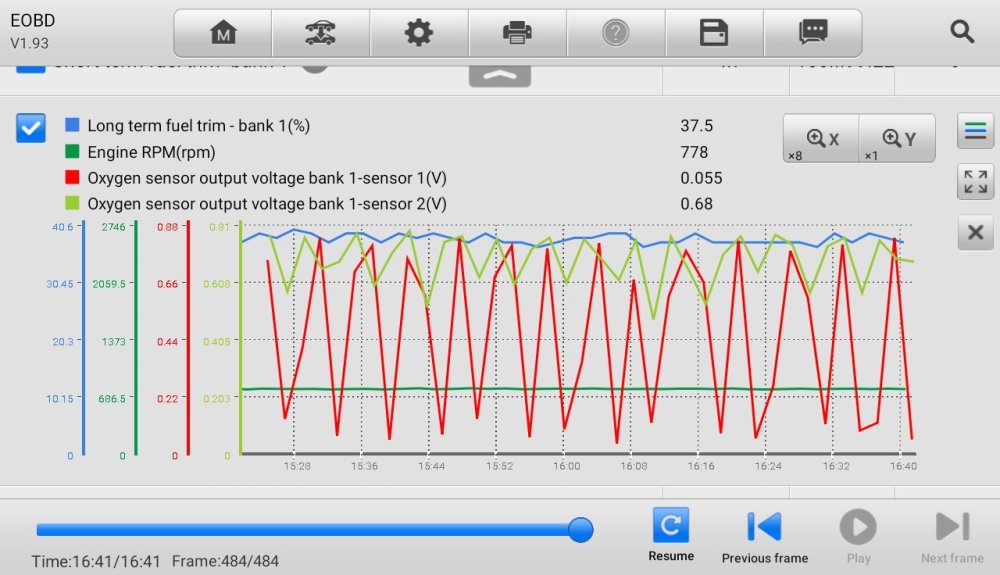

I attach some live data of the O2 readings. So O2S1 is alternating as expected approx 0.1-0.85V which seems fine and looks to be well centered around the 0.45V mark, so I cant see this requesting +37.5% Long term fuel trim (LTFT). There's a separate "Lambda Control" figure that I suspect is the lambda instruction to fuel trim, and at idle doesn't go above +/-4%, which if true would suggest the O2S1 is doing its job.
(Just as an overall update, the LTFT is approx 37-39% at idle, and drops to 9% at 1600rpm, down to 0% at 2500rpm currently, theirs no fault codes present, which is surprising as I though 25% is the limit for LTFM, in terms of driving, its going 100% with no signs of an fault apart from the obvious volume of smoke from the exhaust, the PCV to Oil separator broke over the holidays is now blanked of temporarily, new battery installed also)
What could alter the LTFM at idle apart from the O2S1 itself on a MAP only engine? I've read that a MAP only engine's LTFM doesn't get affected by air leak on the intake side, besides a high idle (which isn't occurring as the idle is at it usual level), Fuel pressure is checked to be within normal range.
I can check the MAP readings which is returning 25kPA at idle, but I don't know what the target would be for 1500rpm/2500rpm?
02S2 is between 0.55-0.75V approx, average is likely 0.68V. Its zig-zagging a bit but that probably due to the sample rate of the scanner? Not sure what the Skoda spec for this is? Would anyone know if this indicates a good or bad CC1 or CC2?
For CC1/CC2 I can see 2no temp readings of ranging from 484-750degC (ish) depending on the RPM and run time (PDF attached). The second CC seems to be around 200degC less at any given time, I assume the higher temp is the CC closest the engine, its not well labelled. Would this be an indicator of CC condition?

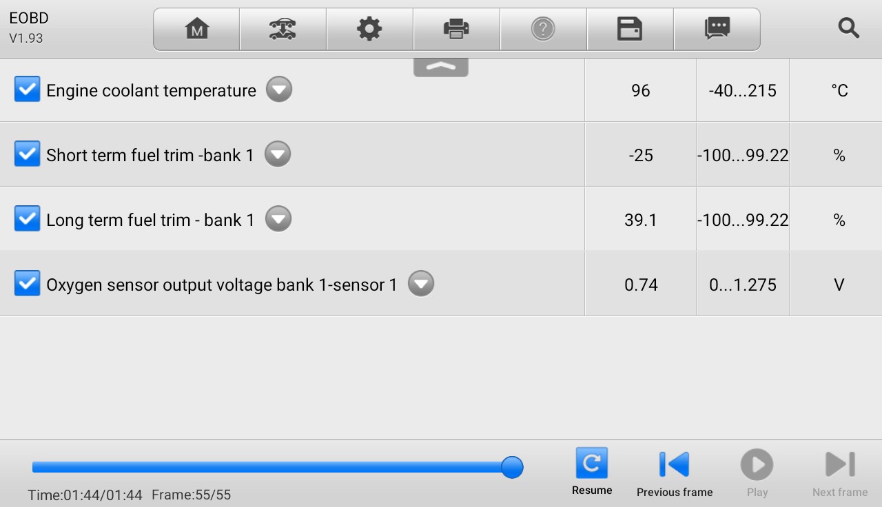

I did a a couple of flight recordings while driving to work;
intake temperature was 8degC at turn on so that would be the ambient outside air temp.
during driving it reaches 20degC Intake air temp.
With ETC at 84degC (stationary idle)
LTFT was 39%, MAP was 24kPa.
O2 was oscillating similar to the previous graph upload. Does the above look correct apart from the LTFT figure itself? Are these the only factors that affect fuel trim possibly resulting in overfuelling/ high CO at idle or am I missing something?
