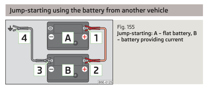

If your car is early enough, this may not be the issue it is on current Skodas. What does your handbook say on attaching charging leads? The same points can be used for jump start leads.

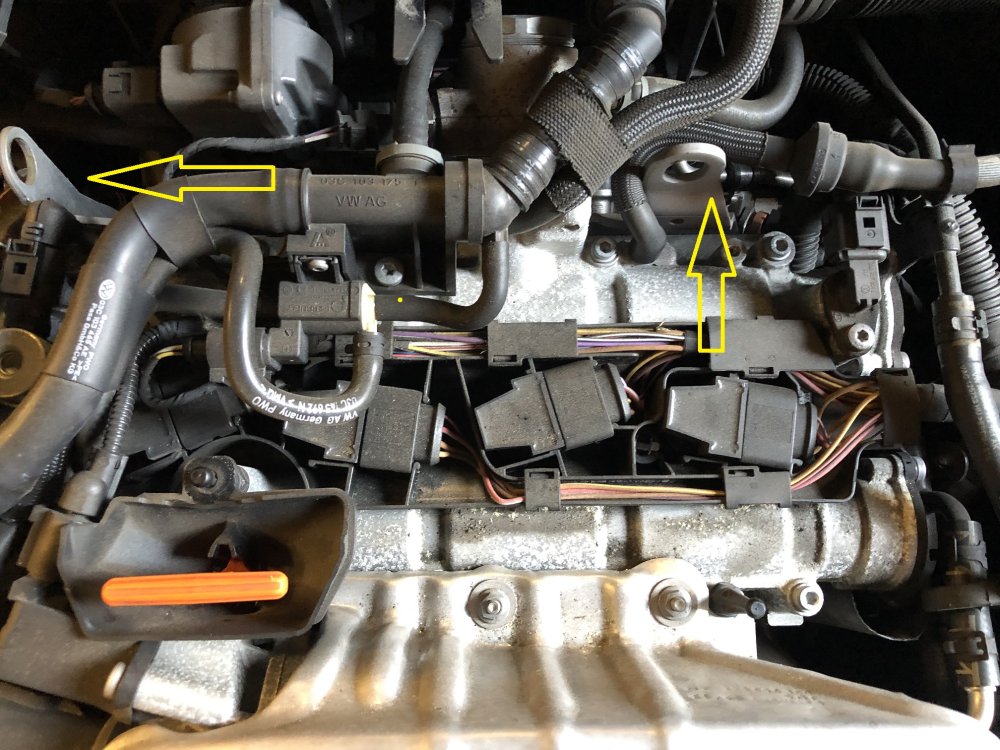

Just pop the engine cover off and connect onto either of the engine lifting eyes in the image below.

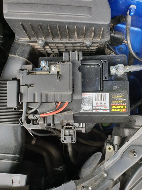

Commonly with a Mk2 vRS Fabia it is where to put the positive that has people dithering.
  • Sponsor
The clamp on that positive post looks really loose? Trick of the pic? Looks like massive gap on the left. Whose car?

@UrbanPanzer has given the only info the OP wanted.
It's a really good place to earth the recipient car for best chance of good cranking speed
