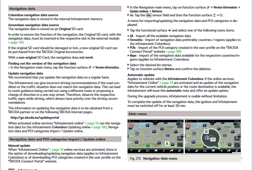

It sounds as if you have Amundsen and not Columbus.
Afaik, Amundsen stores its maps on the SD card and not internally. The Amundsen SD card uses the SD protection feature so only a genuine Skoda card will work in it.
Check the system info section of the menus to confirm system information.
You will need to consult the Amundsen sections of Briskoda for help if I am right.

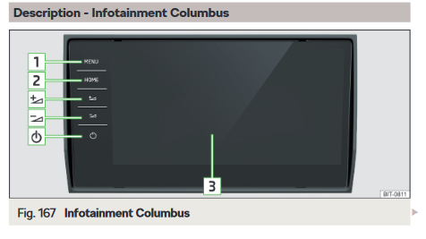

Thanks xman - how do I check? The front panel LOOKS like the Columbus, but that would explain the issue"

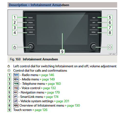

Sorry, Stonekeeper, missed your post. The puzzling bit is that the screen/buttons appear to be exactly like the Columbus. Will the version info tell me?
Edited by mjp99
Screenshot2024-02-11at10-41-51OwnersManual_pdf.png.960119528c24e71000cac94a15458d7c.pngScreenshot2024-02-11at10-41-38OwnersManual_pdf.png.6c27d0fe5e9c00dd01cc4835c5aee299.png
Yes, that image of the Amundsen pretty much clinches it! That is my panel. Off now to find a reasonable price for the SD card!

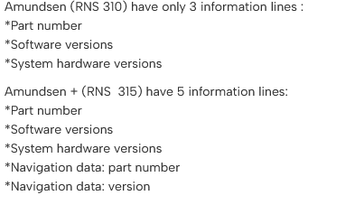

need to check whether
RNS315
or
RNS310     Last update (final?) was 20/21

Stone - my screen has more lines than 5.............
