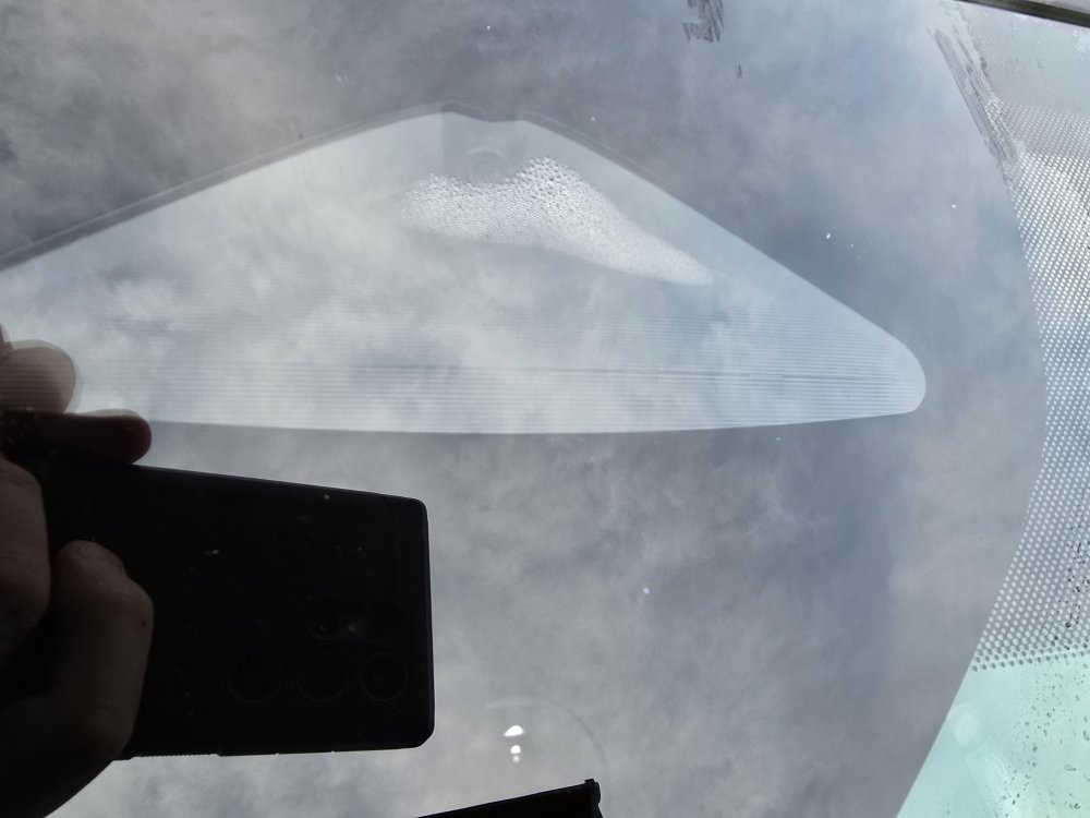

First time it happened was with trailer... i dont know if there was connection.
Overheated camera module... something wrong in the fan of the camera module. Fan stop spinning (unknown reason) -> overheat -> shutdown.
Remove rear mirror and covers. If the fan is hot, remove the module and remove plug.
Wait module to cool down and reassemble.  tech skills 8/10 needed.
Allso P2422 coming and going...
