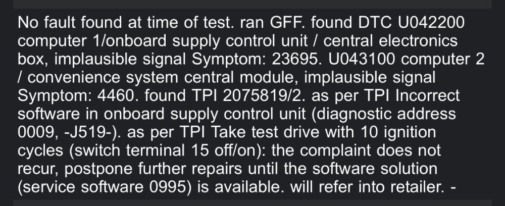

I have recently picked up a Skoda Scala SE 1.5 tsi, registered in July with 1000 miles on the clock.  Had it three days( bought it on 01/11/24)  and the engine management light came on, then epc. The fault is intermittent and sometimes no warning lights and everything starts as normal.
I called out Skoda assist and on
their  second visit in three days the technician found a TPI saying it’s a known software fault see below.
Edited by Manxonia
Thank you for that. Always good to know. It seems Skoda are returning to the bad old days of a skip on wheels
4 hours ago, Manxonia said:
I think that a whole host of  software issues are appearing all across the Skoda range.
As an aside, does anybody understand the TPI reference numbers?  The technician remarked about it being ‘2’. What does the ‘ /2’ mean?
