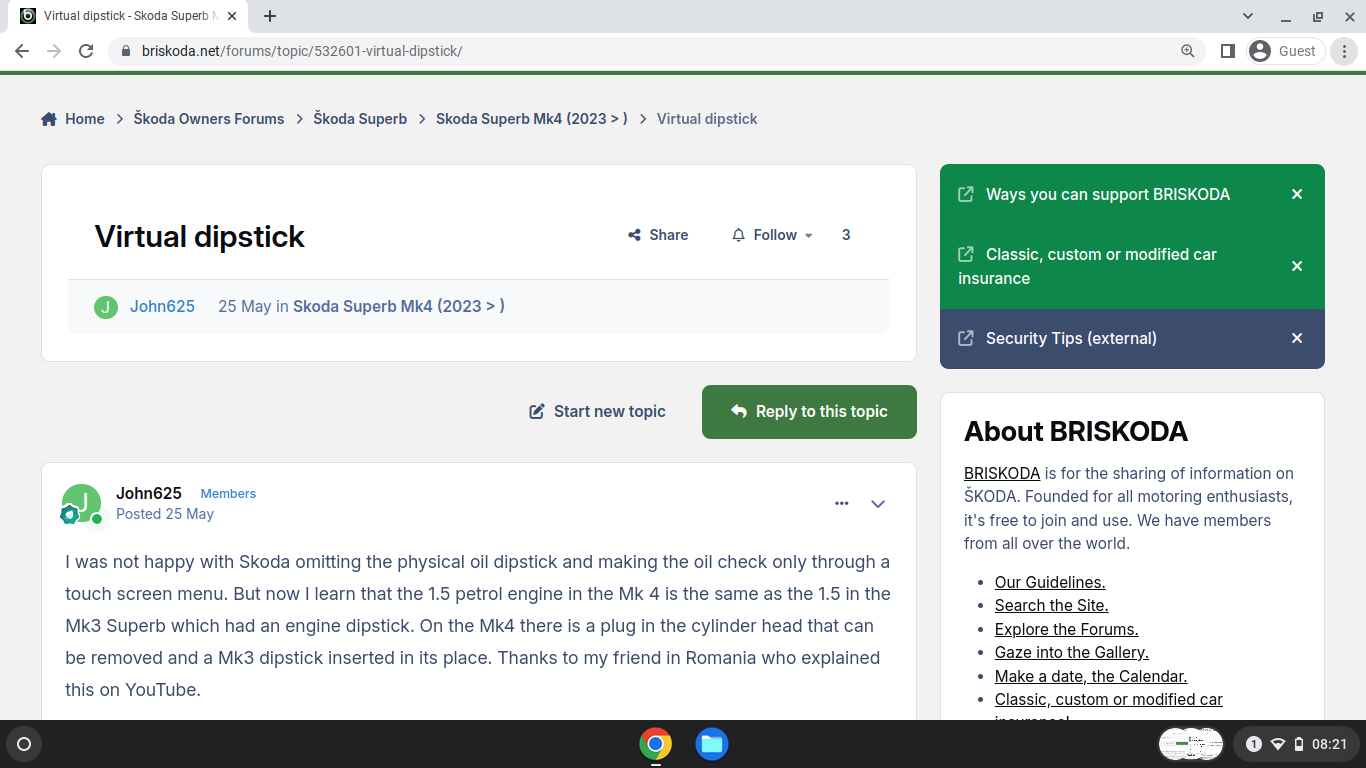

Can anyone remember th post about using a Mk3 Superb dipstick in the Mk4 which it is not supplied with. Just a blanking plug on the Mk4 1.5 petrol engine.
Not a Recall or FACTORY RECALL if the Registered Keeper was not told there was a Recall.
So just a TPI and people might get told if at a Dealership, if they use them, like because having an issue.
So a Skoda Secret Service, on a need to know basis, Workshop campaign. 'Recall action' Kidollogy.
You can always look at your own past posts, or others can or a simple search works.
http://briskoda.net/forums/topic/532601-virtual-dipstick

Octo, earlier this year you posted on replacing th blanking plug in th eMk4 1.5 engine with th dipstick from the Mk3 engine. I have spoken to my dealer who said he can order it on the part number. Do you have the part number for it
Dealer has the part number, no idea why he didn't check in the system and asked you to provide it.
Man I spoke to wanted the PIN or reg no of the car to look up the relevant part for it. I will try again with a different man.
