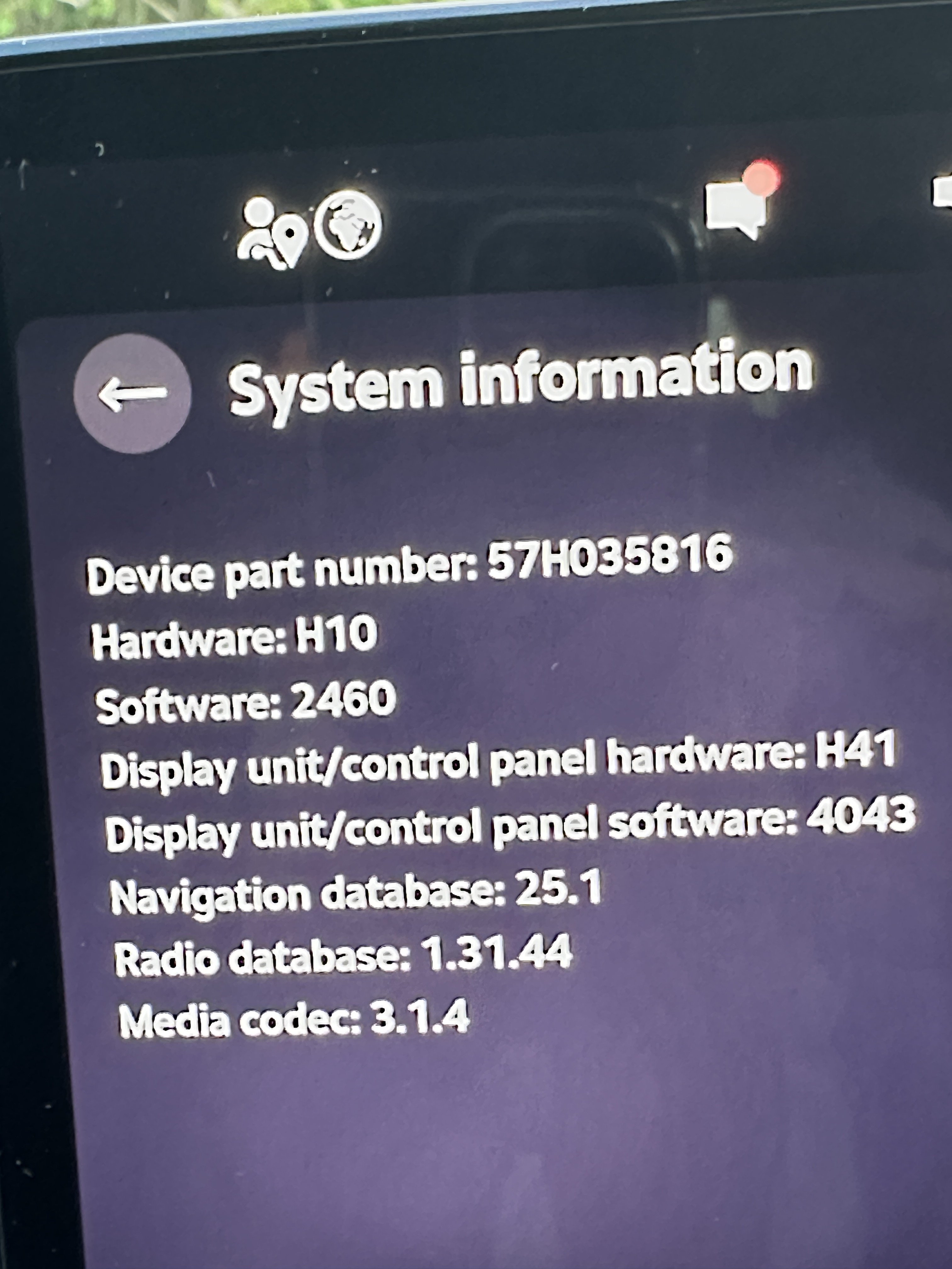

Thanks, that version is still higher than mine, which is 2460. Is there a list of what the higher version fixes / updates and if the issue I have persists after cleaning, what should I be asking the dealer to update?
No, as far as I know this is all quite obscure. Going back over posts on this forum, it appears that the dealer software updates don't change the software version you see on your display. That software version seems 'locked' to the car and related to the production date, is my guess.

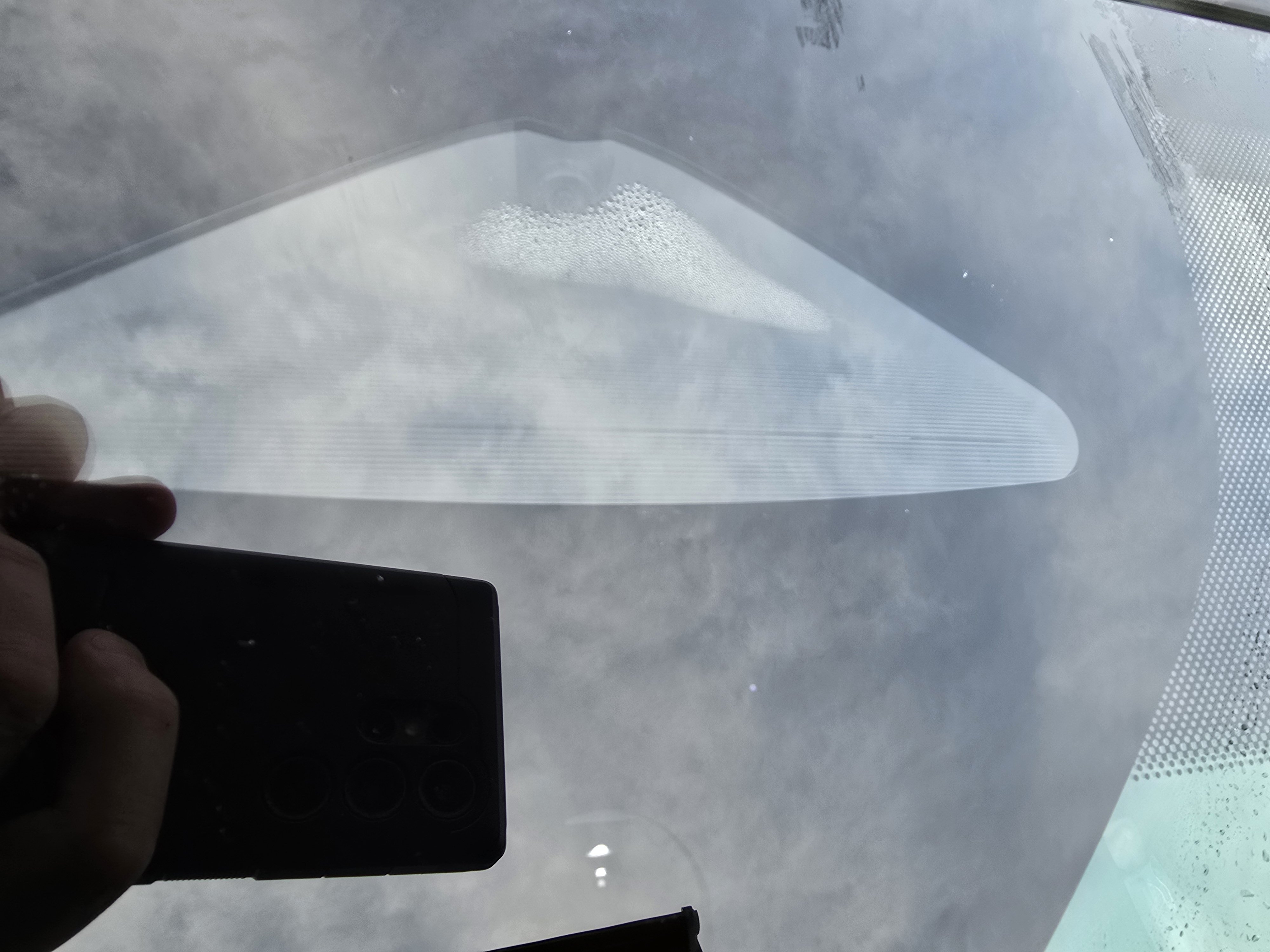

I think i may have found the problem, condensation under the glass near the sensor... will need to check if this remains
Edited by teppum
Yes, then it is likely a 'true' error.
