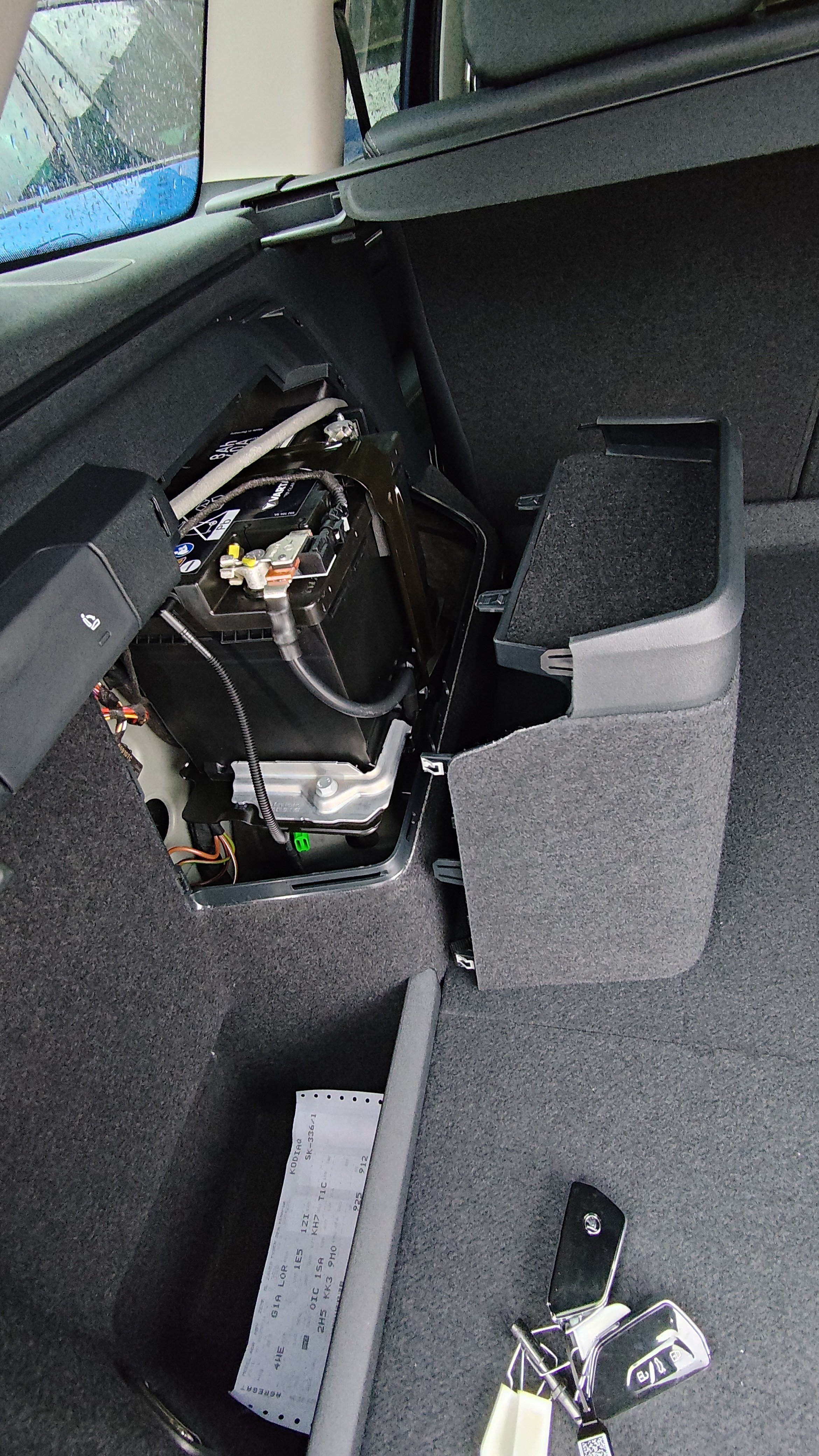

Can anyone tell me where the 12v battery is on the PHEV model, I have yet to do a thorough search but pretty sure its not under the bonnet - no space (unless its buried ) and the hdbk says there are terminals under the bonnet should the battery need charging.

The issue regarding the maps not loading on the instrument cluster is a know fault by Skoda, there is no fix yet released for this yet.
Regarding the 12v battery it is the same for PHEV and BEVs and charging the high voltage battery should also keep the 12v battery charged.
On the new Kodiaq PHEV the 12 battery is located in the rear left behind a cover that you have to pull off, just held on by clips.

Battery must be in a different place on the Superb estate.

I just saw your thread which I did make a replay to just now, hope it helps.

On my left-hand-drive Superb IV PHEV the battery is behind a panel in the boot on the left. Very similar to the photo above of the Kodiaq. Just unclip the panel and you can access the battery. (I have one time disconnected the battery to force a 'system-reset' when I was getting all the assistance system warning messages. Since I did that, the warning messages have not returned.)

I have the L&K PHEV estate and the 12 v battery is behind a cover in the boot on the left side.
Found it thanks. Now facing more serious problems - see "no electric drive" thread.

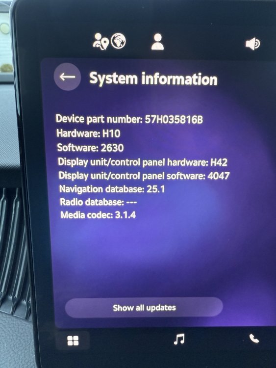

Picked up my L&K from the dealer today. They assured me it had the latest software available. Fingers crossed🤞🏼
I picked up my SE L four days ago and had the same software version. Unfortunately driver assist errors appeared on the drive home from the garage and now all assist systems are unavailable.
I took it into the garage yesterday. Was told they applied a ‘short term fix’ but a permanent solution has not been made available by Škoda. The short term fix made no difference, with assist systems still unavailable. They hadn’t heard of the software update mentioned earlier in earlier replies.
