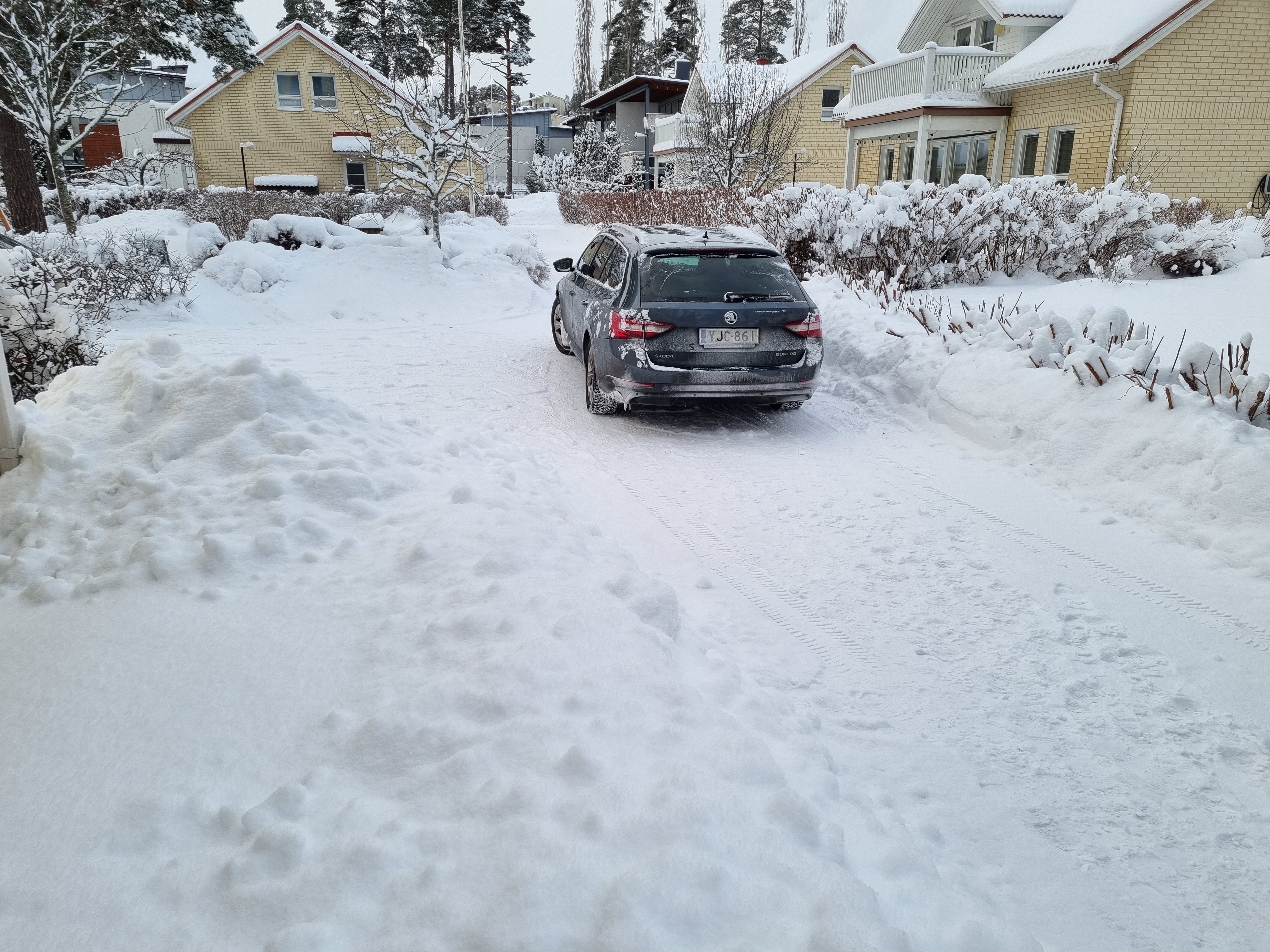

I dont know the rules in the UK in detail but in Finland these assist warnings wont cause any MOT fails or anything else. In the deep of winter our cars are covered in snow and ice and ofcourse then the camera's and sensors dont work. I had this on my MK3 and fully expect on my MK4 in the next months. Anyways they are bloody annoying so i turn them off anyways every time drive.
