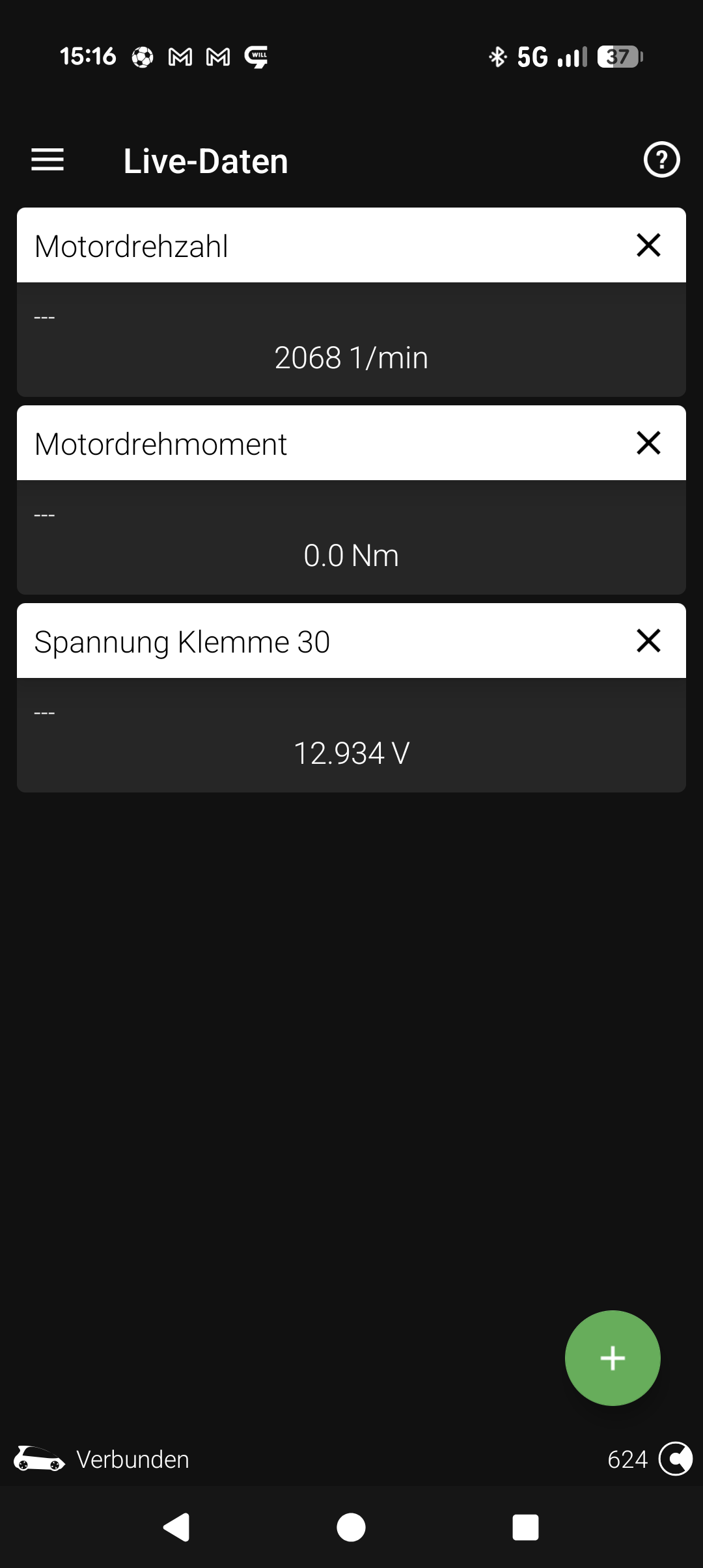

@nta16
Look hat speed und rpm
5 hours ago, Cairus said:
@nta16
Sorry, you have me at a loss, do you me me or someone else?
In your image I see 2068 1/min for revs(?), no speed and 12.934v at something(?) something(?) 30 - I can barely read English let alone another language.

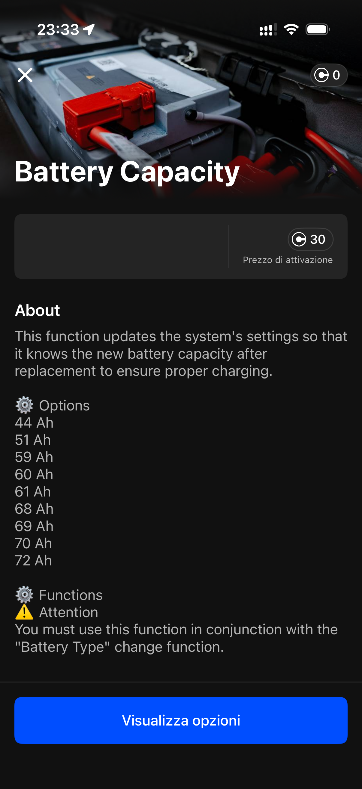

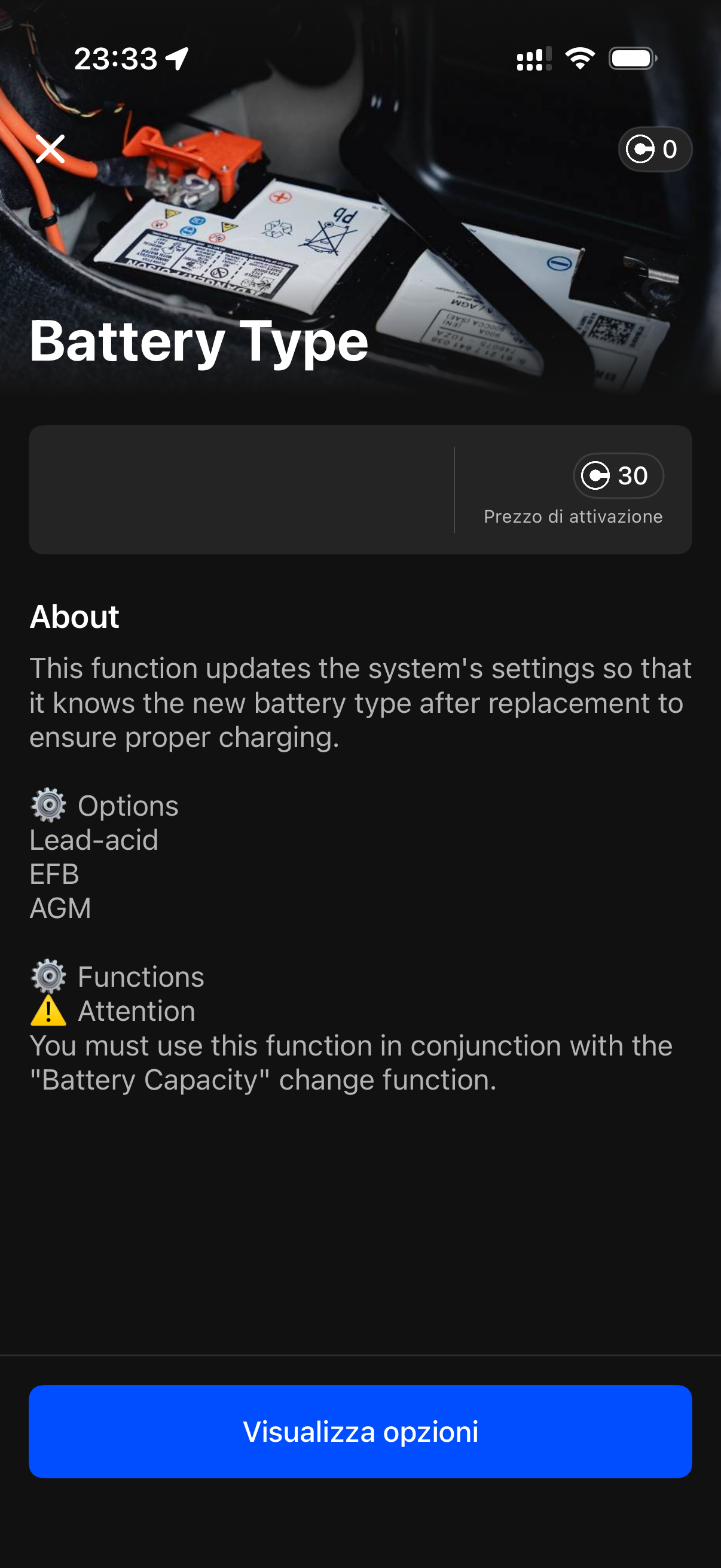

This evening I carried out a new test with ODBeleven and noticed that, while driving, the voltage stayed at around 12.5 V. In my opinion, that’s not a normal value. On the few occasions when I was coasting, I recorded readings of about 14.3 V. This leads me to think that something isn’t working properly, most likely linked to the fact that I haven’t yet registered the new battery – which could make sense.
On this point, I tried exploring the various “Applications” of ODBeleven 3 through the iOS app, but I realised that they’re paid and need to be activated individually. For example, the Battery Capacity application costs 30 units (I’m not quite sure whether they’re credits or something else), and the same applies to Battery Type.
What I haven’t managed to figure out, however, is where the battery’s serial number should be entered. That part isn’t clear to me.

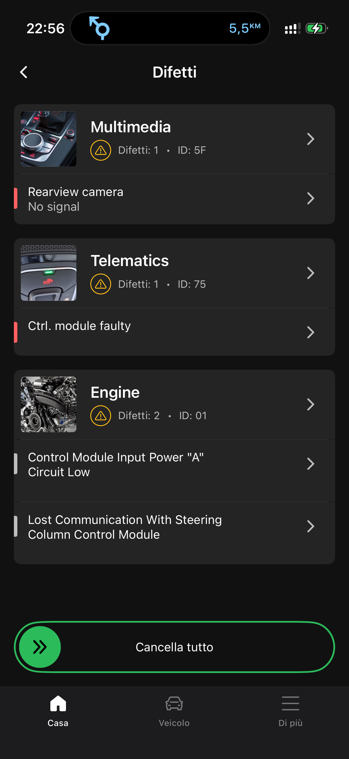

Lastly, I ran an error scan and several alerts came up. The next step will therefore be to check whether, and to what extent, they might be related to the battery issue, even though the battery itself has just been replaced.
Check with OBDEleven but generally you want the correct and up to date program for your make model and (part) year /VIN other than generic OBD codes.
