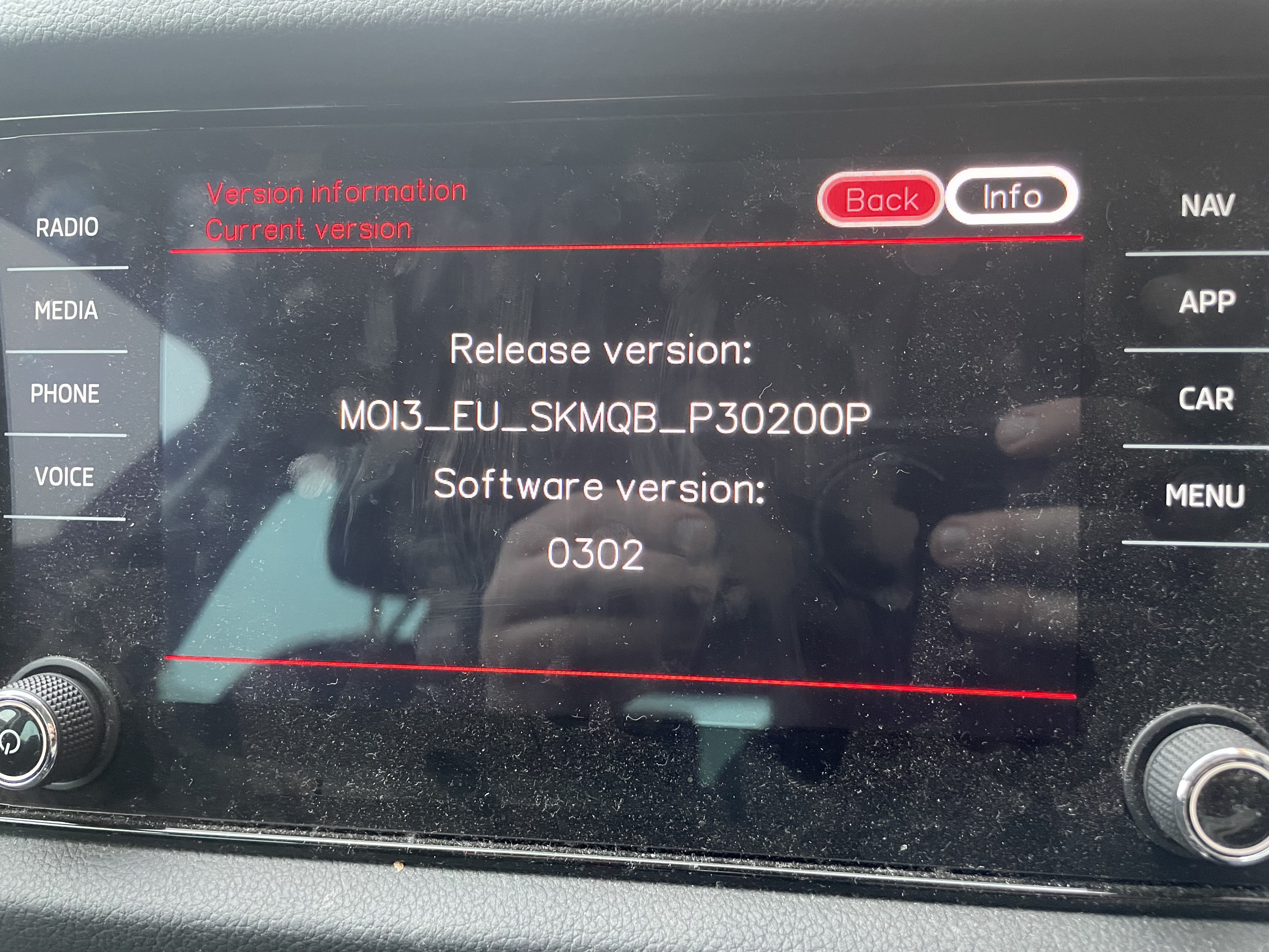

look ok to me. DAB is the black one top left in the photo and easily snagged when putting the unit back in. Do you have any cheap USB chargers plugged in? They were knocking out my DAB signal. Bought some slightly more expensive ones from amazon and it solved the issue. I'm thinking of doing the MIB2.5 upgrade at somepoint but the screens seem really expensive. Where did you get yours from?
