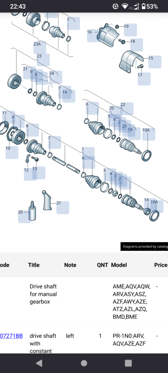

Fabia 1 front wheel bearing kit
From what I can gather its the outer o-ring seal for the half-shaft, also called deflector ring, fits on drive shaft end before inserting splines into front wheel bearing Part no 6Q0407623E Item 10a here Item 3 here
