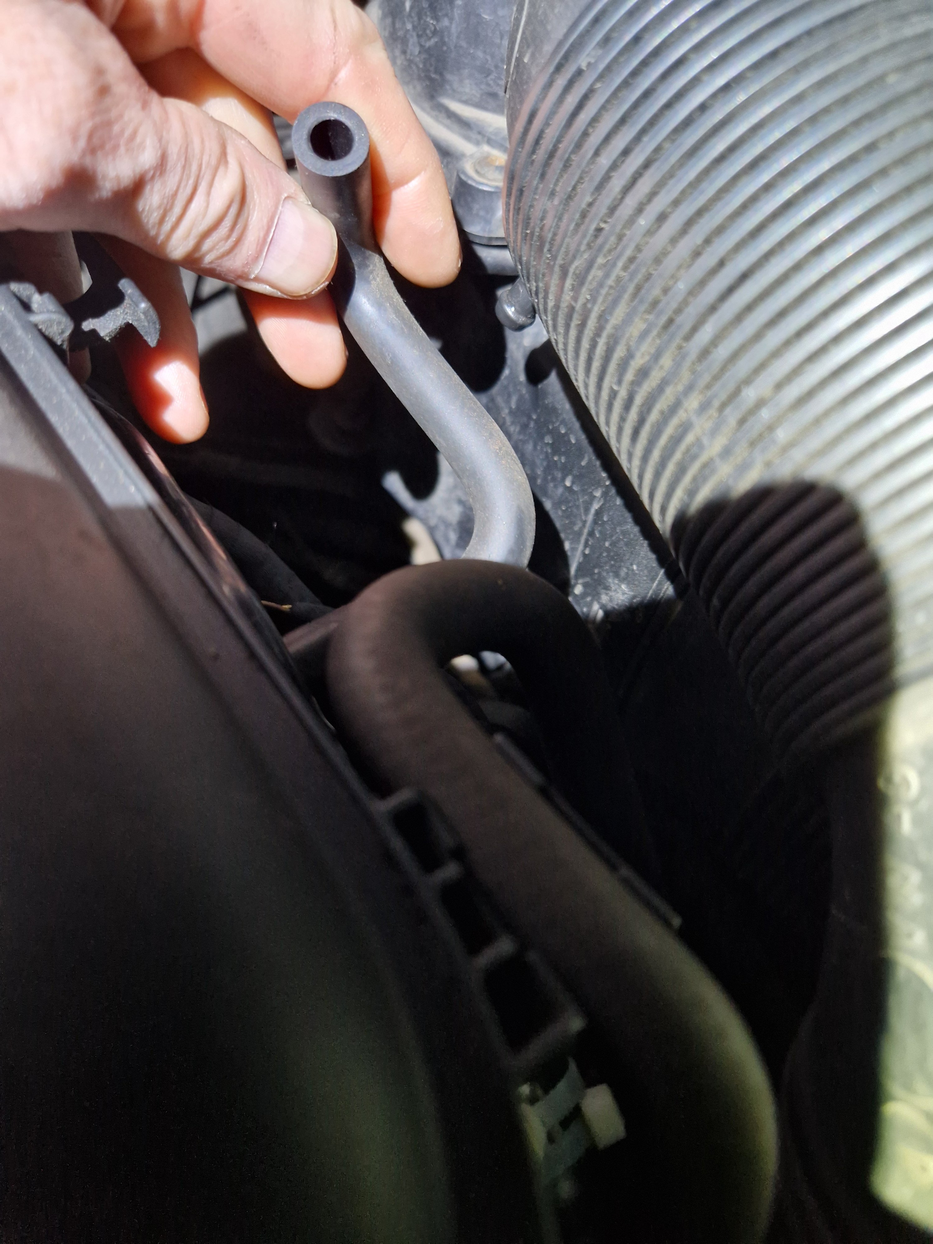

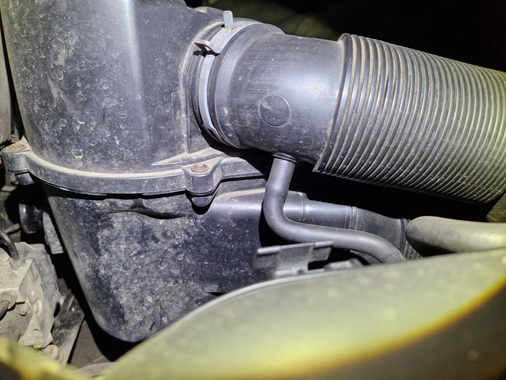

  17. This lot may have stock of new genuine, at quite a price. Check availability with them: Volkswagen / Skoda Vacuum Pipe With Non-Return Valve 6Q2612041AK - LLLParts
  18. Yeah, that's properly broken. Is there enough length to trim away that end and reconnect further back? (would need careful heating of plastic).
