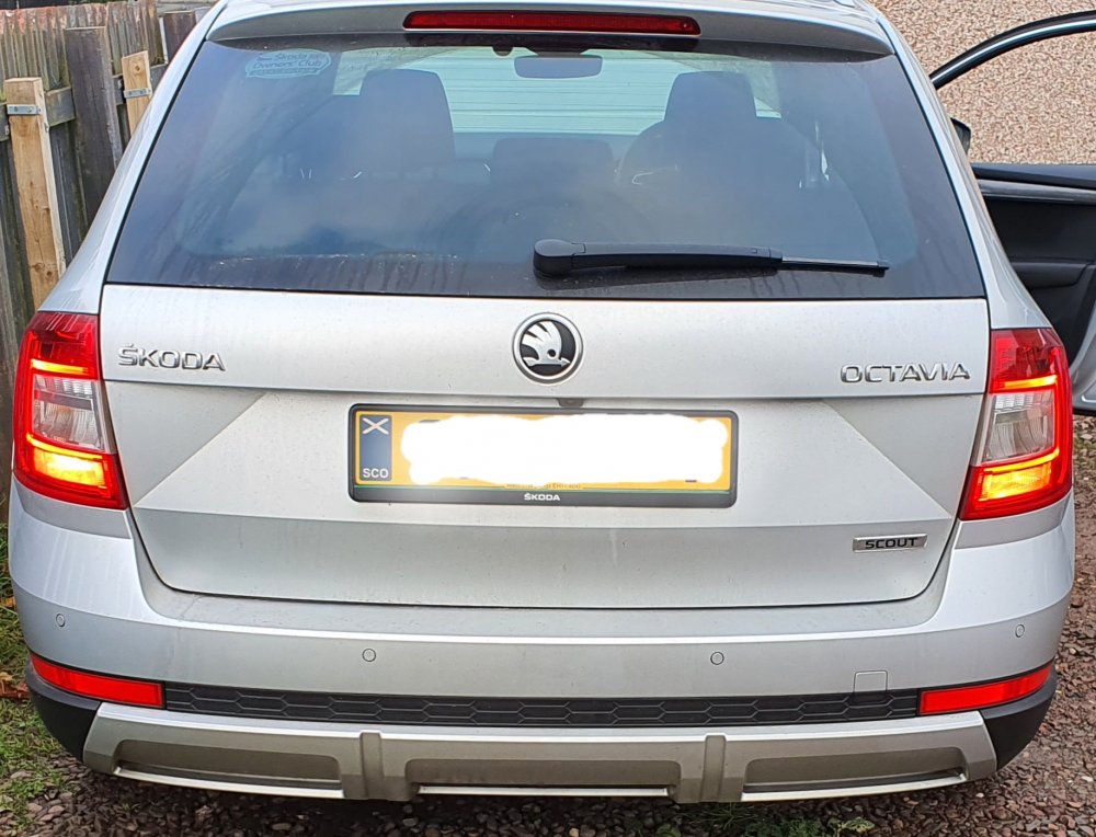

- FIXED - MY19 - enabling both rear fogs - not working - LED tail mod now available
The bulbs was in there and it looks like the wiring was also there too. You just had to tell BCM 09 module: If you have a hybrid lamp (part LED and part incandescent) you need to do: Leuchte26NSL LA72-Lasttyp 26" to "9 - allgemeine Glühlampe 27W: auch H15" If you have a full LED taillamp e.g. VRS, you need: Leuchte26NSL LA72-Lasttyp 26" to "40-Glühlampe-LED"
Hello all, My experience with my VCDS is very hit and miss at the moment; latest thing I have tried to enable is both rear fog lights on my 2019 MY19 Octavia Scout. The Scout has a part LED rear tail lamps - and I've checked that both bulbs are installed on the left hand side (my car is a RHD model). I've been following the settings from: and I've also enabled up the brightness from 0 to 100 on the BCM / 09 module. Still nothing..... I have done the usual trick of recoding - and performing a soft-reset on the 09 module - as well as turning off/on the car....still nothing. I still only have the right hand side fog enable. Your help and advice would be appreciated. Thanks Max
