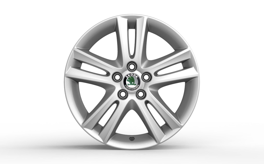

Regards the wheels, it's going from 4 to 5 stud.
So will be looking for 5 stud 16" rims probably, that look like stock Skoda ones.
Not too big and I can get decent sized discs under them.
16 inch elbas from the fabia would be perfect
Wouldn't steelies be the way to go so as not to give the game away with the mahoosive brake set up?
I would opt for light and rigid wheels. It will give away a bit of the sleeper looks, but the lesser they weigh, the more fun!OZ Allegerita for example.

1. Not necessarily. The main benefit of alloys on road cars is stiffness and looks, not weight.
2. Not necessarily.
3. A Mk2 Fabia vRS can be fitted with 15" steels that will clear the brakes no problem at all.
Of course if the TT brakes are bigger than that then 16" would be required, but they are not exactly rare :)
I'd throw the 16" Fabia alloys on personally anyway :D

these are what ash has on her citygo! :)
And my other one...
Same wheels, but 15 inch and only 4 stud.
