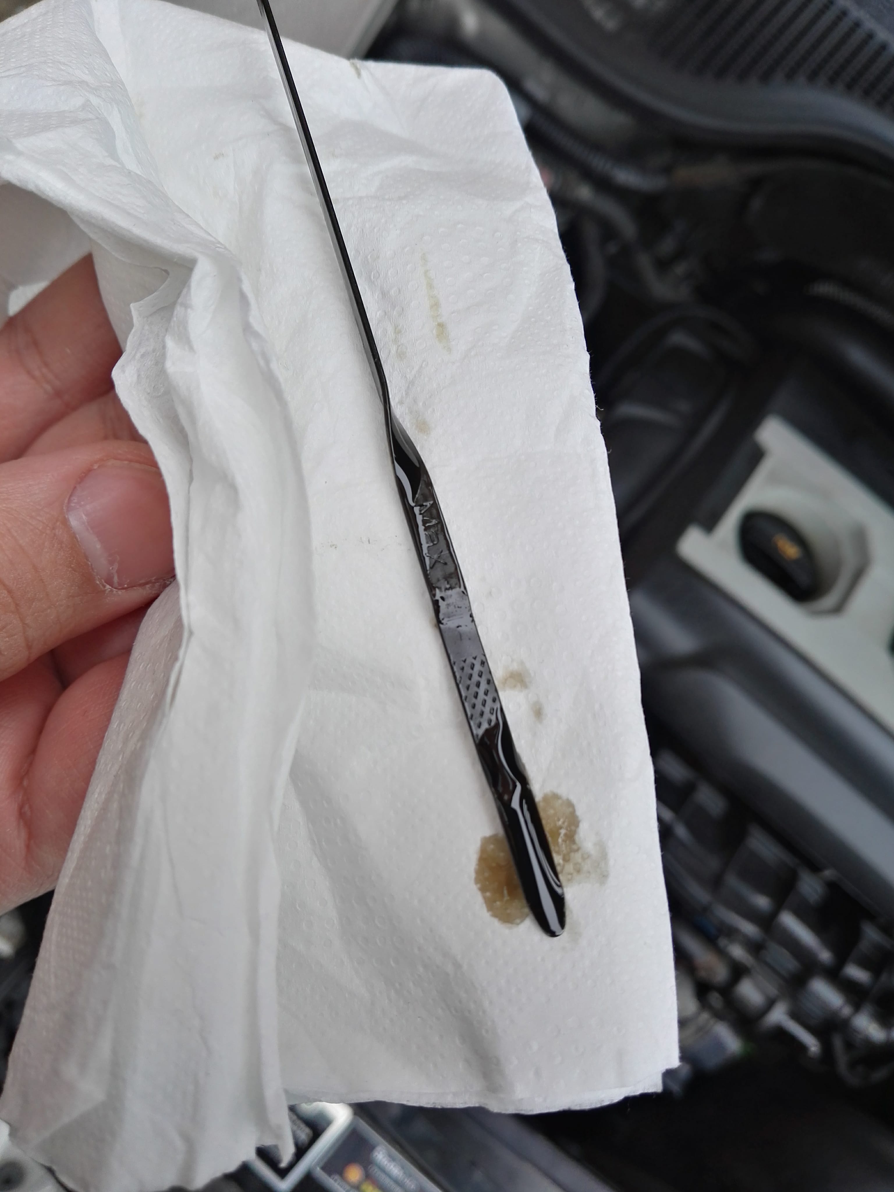

After a maxed refill, I decided to keep an eye on the oil consumption and used a planned trip to a friend to take pictures of the oil level.
After having driven an additional 192km the oil level was in the middle of "MAX", which I again found conserning.
the second hand dealer, again, still not really thinking that it was a problem still wouldn't budge.
29251161_10216003146581022_1141472367_o.thumb.jpg.ef24a0621efcda7a61f917c702dfd7cd.jpg

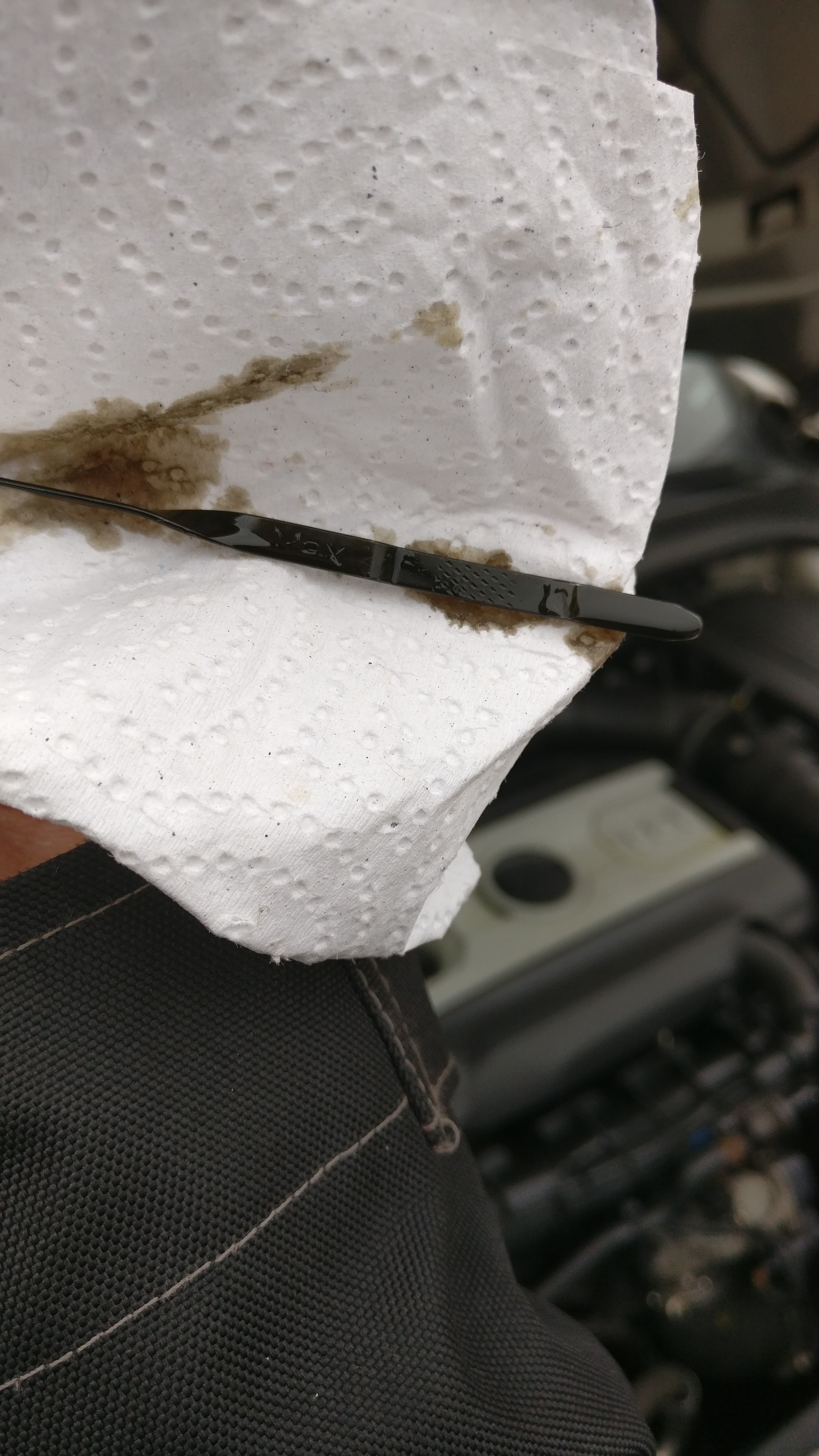

This was after having driven 325km
And this was arriving home, after having driven 452km.

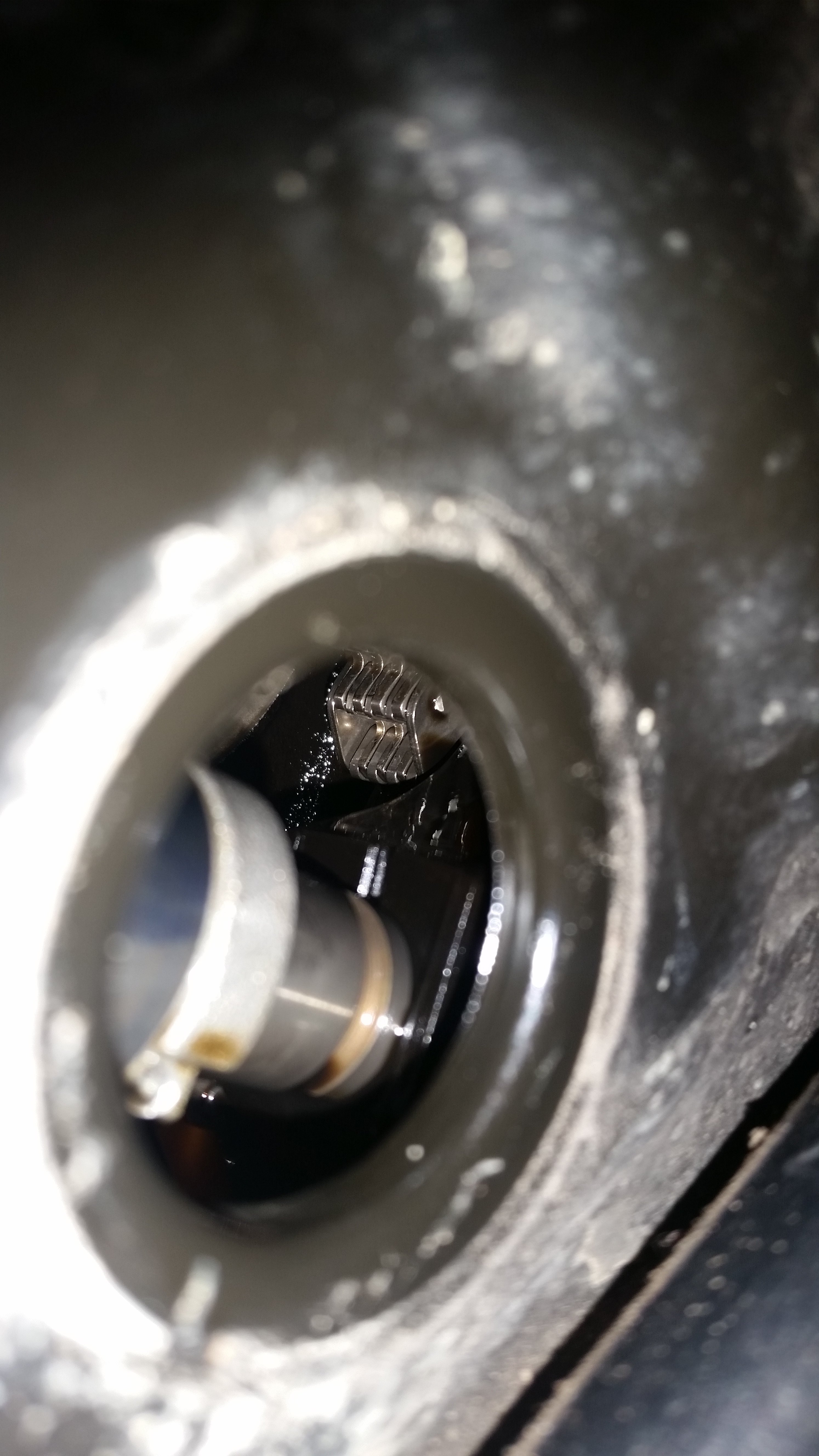

The engine uses a timing chain for the main crankshaft / camshaft timing.   The thing is I do not know whether the dealer is being evasive or just doesn't know his skoda stuff but either way it is not filling me with confidence.
If it is still running a 2009 timing chain and tensioner, that is an issue. That will be a very early revision and one which is probably the most susceptible to failure. Based on manufacture date and no proof of any change out, he really doesn't need to look at anything to inspect that.

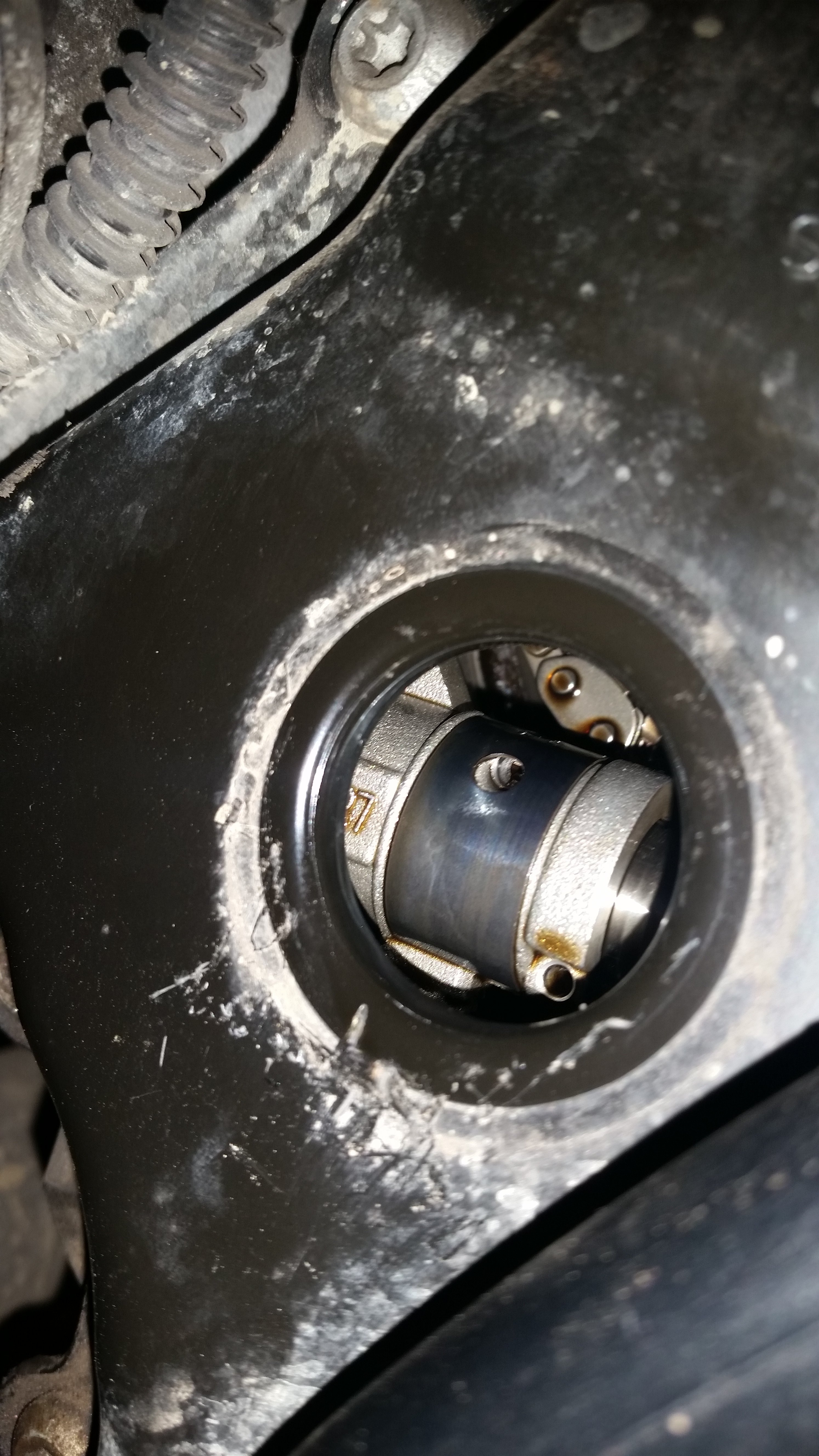

If he really wanted to, there is an inspection plug on the side of the lower timing chain cover, which with a mirror can be used to sight the timing chain tensioner and the number of teeth extended.  VCDS or dealer level software I believe can give some phase readings which also indicate the extent of timing chain stretch.

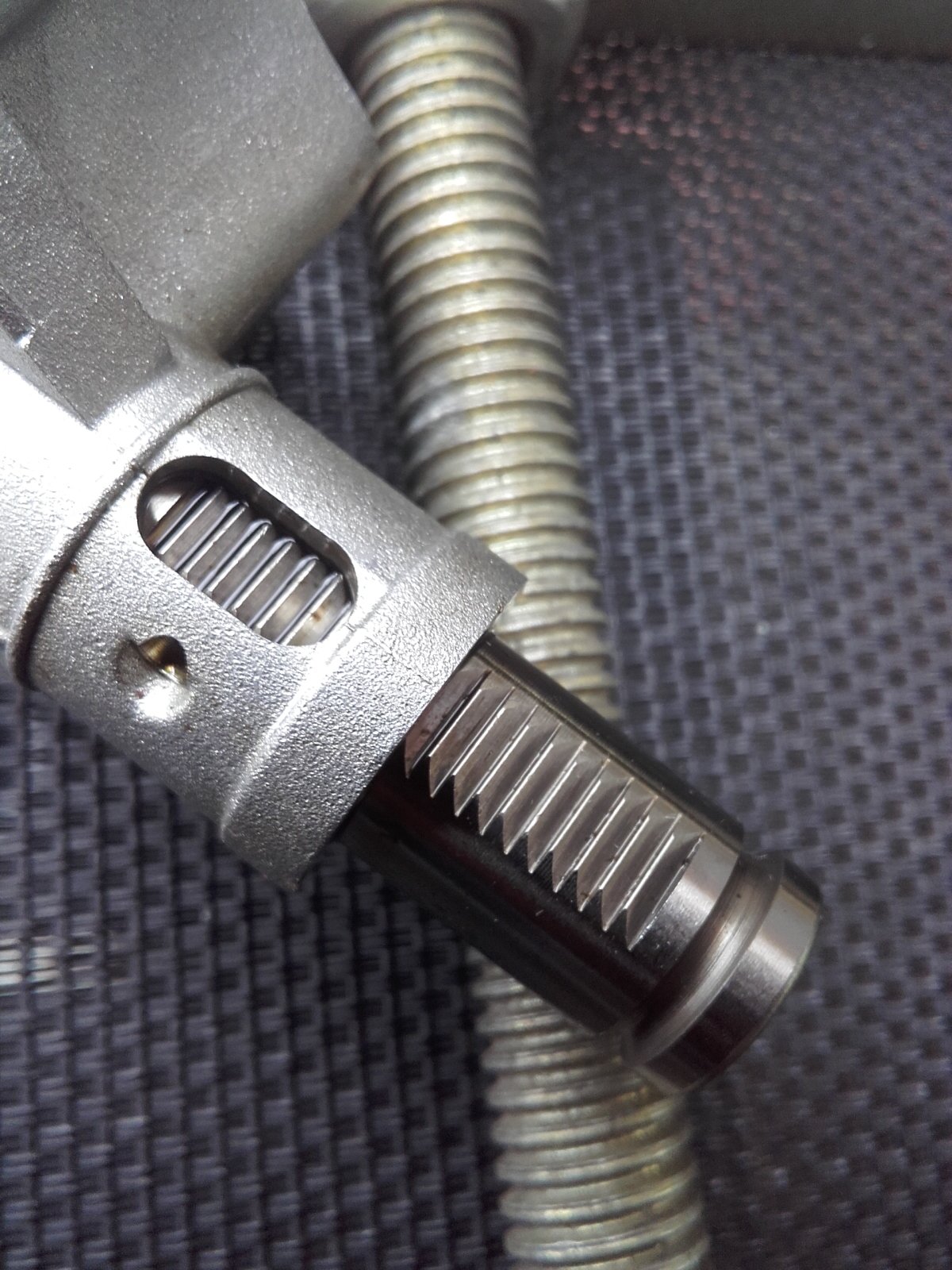

Just has my 2010 VRS 46k miles tensioner changed, I'm glad I did as I asked them to keep the old tensioner for me to look at. As you can see from the pictures when I took it apart, the teeth on one park of the ratchet are fine, but there are teeth missing and wear on the other part....phew. At least I can sleep a little easier now.
I would definately recommend getting the latest tensioner fitted!

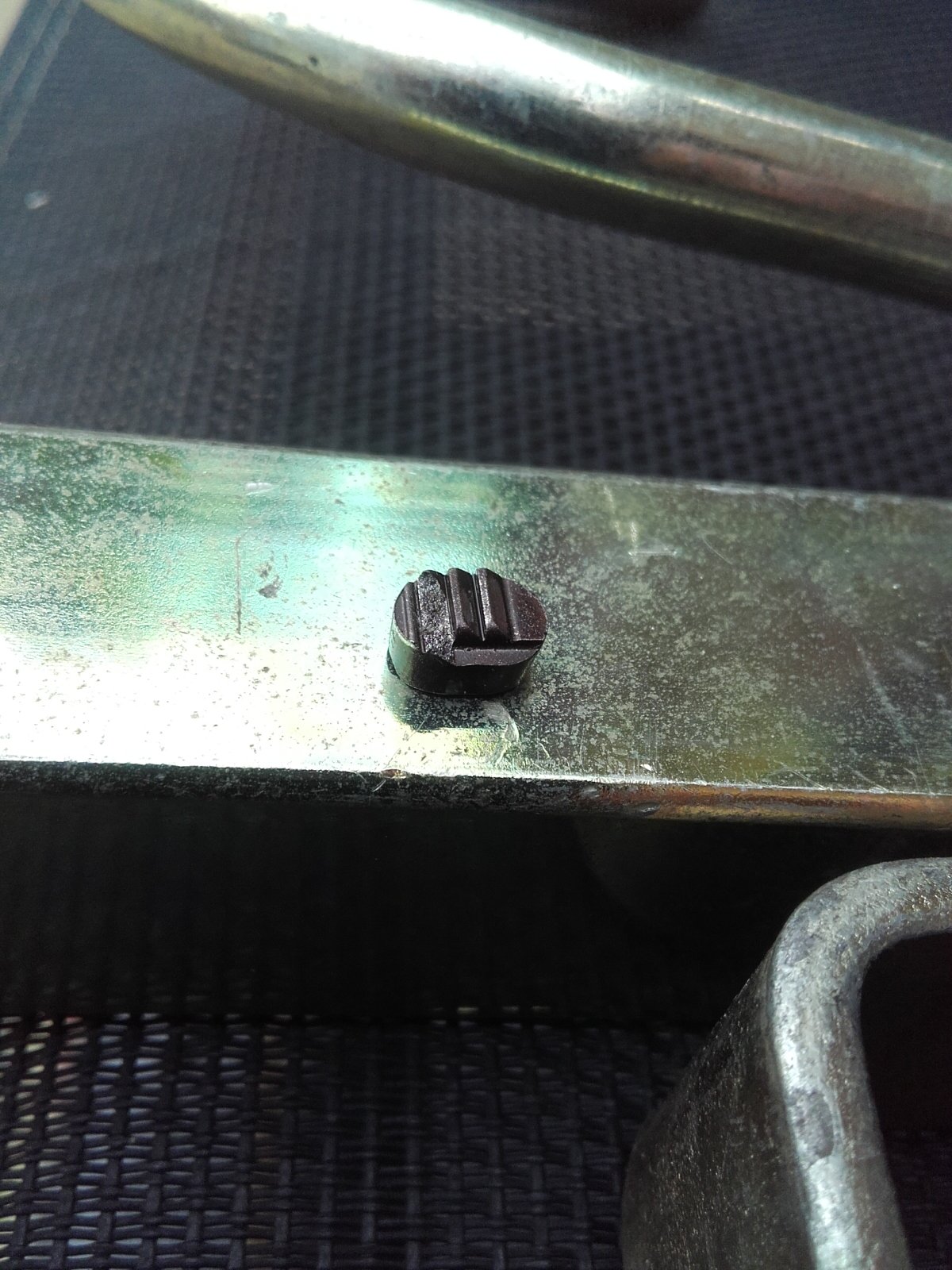

mines got the old type tentioner fitted and looks ok through the hole , mines on 90k and have been told not to bother and just drive it , its always in the back on my mind tho

Well, even VAG does not know what to tell their service network team ... Check and compare following TPIs
VW TPI 2025206
Technical product information 2025206_7.pdf
Audi TPI 2041797
Technical product information 2041797_1.pdf
And what is really sad, no one can say anything about the condition of this tiny but vital piece without disassembly of that tensioner ... The pressure test against the tensioner can give different results :sadsmile:

It may need a new chain and guides if it's stretched the chain .
This is what the garage said to me .but hopefully mine will just need the new revised tentioner and the tin engine cover that always bends on taking it off.
Mines costing a quote of £400 for genuine TPS parts and labour .but more if it needs a chain .
