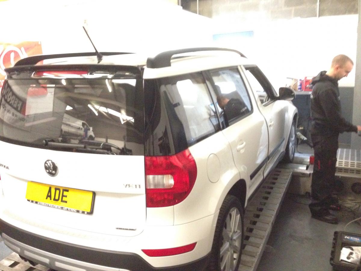

Well it's announcement time, due to a number of factors ive moved thenYeti Greenline project to ADE Tuning who are going to bring the project to completion and hopefully hit that 200bhp figure.

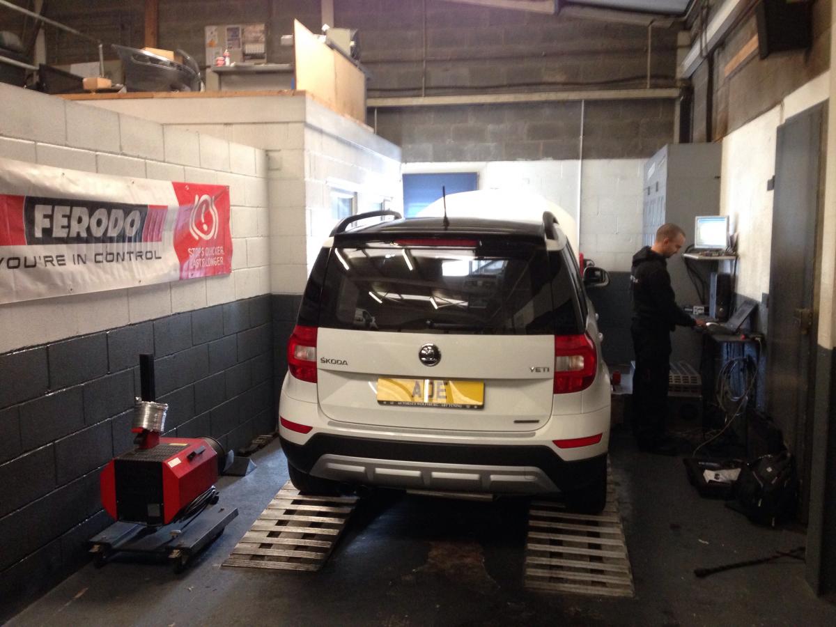

I dropped it off this morning at ADE, Anthony and the team wasted no time and got it straight on the Dyno to see what the car was running at. It came out at 178bhp, which considering it had been dialed back a bit due to the DPF not liking the smoke was a good base line.

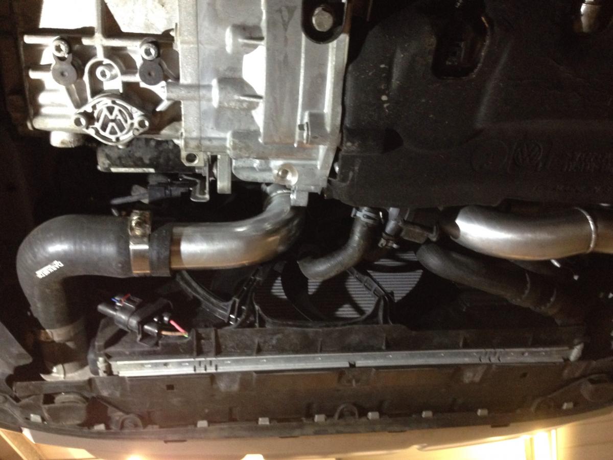

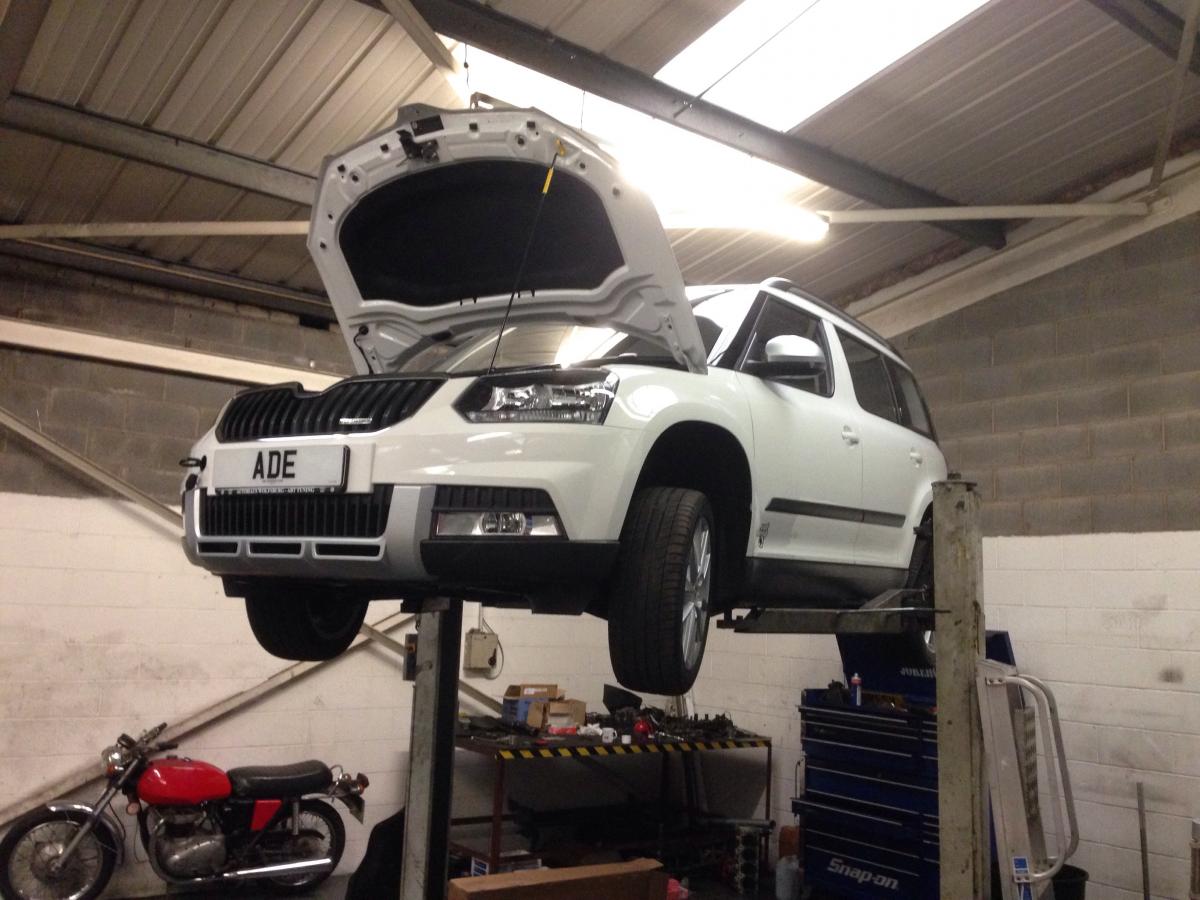

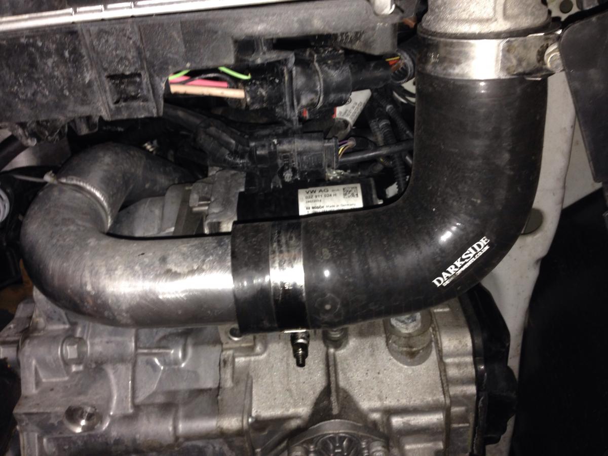

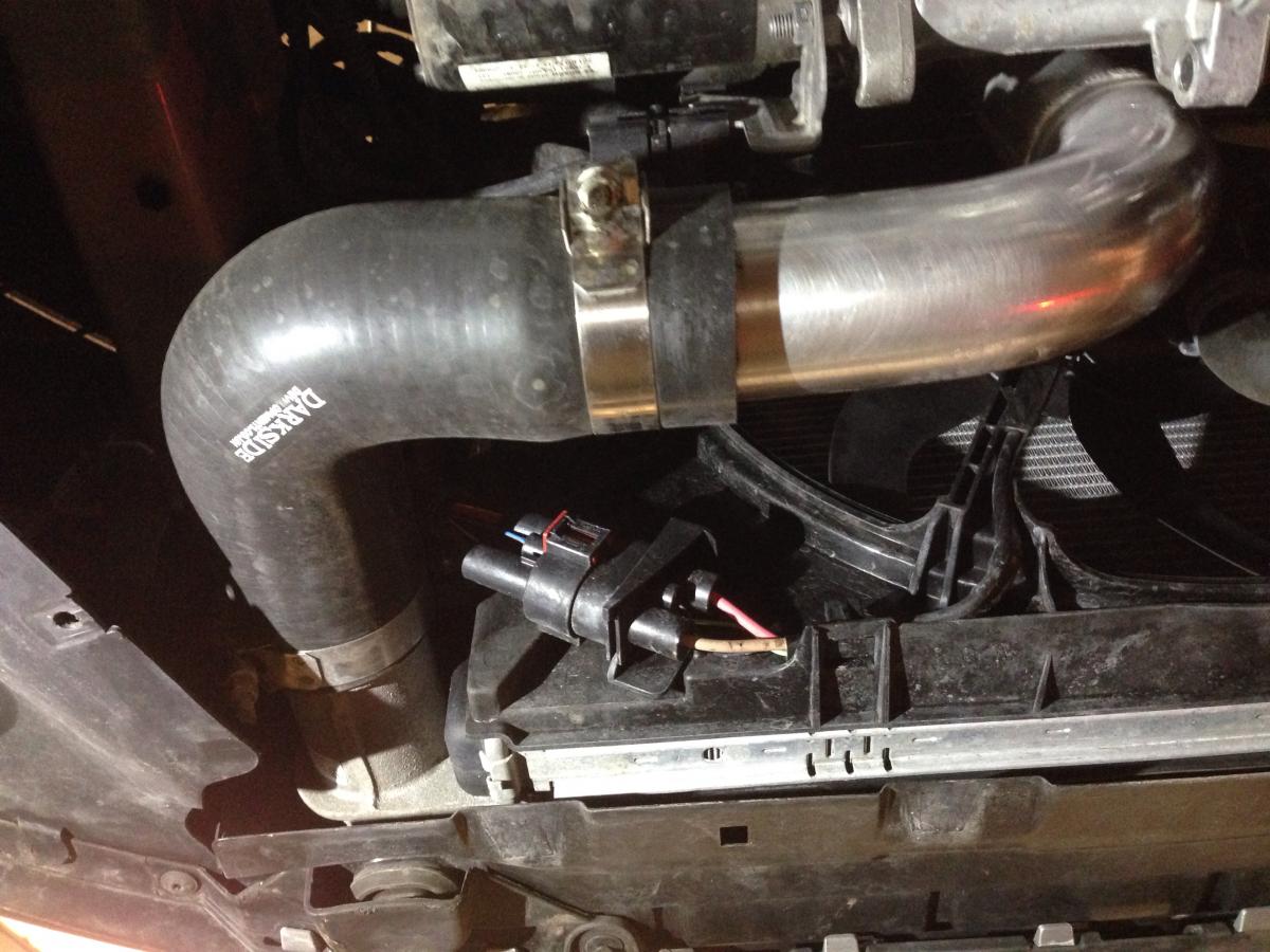

Next it was onto the downpipe, the DarkSide downpipe only had attachment for lambar sensor. Anthony didn't want to just disable and tie the EGT and other sensors out of the way and so set about welding in attachments for,the various sensors to the new downpipe.
We also managed to get some pictures of the DarkSide Developments hard pipe work kit, everyone was impressed with the quality of their kit and especialy the welding on the downpipe, top quality kit.

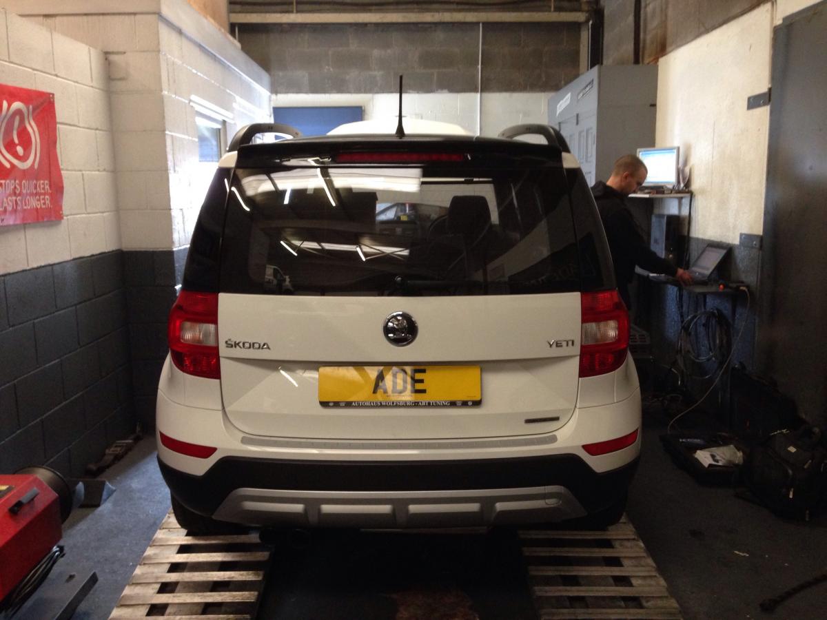

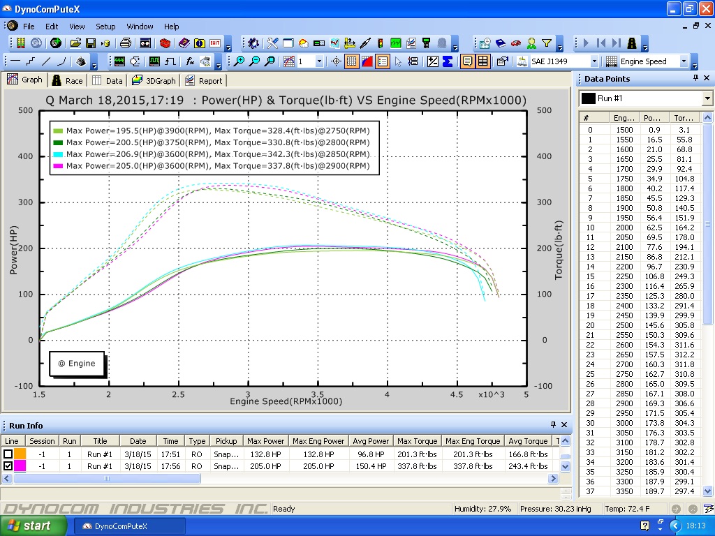

Initial results are in from ADE Tuning 206.9bhp and 342.3ft llb !!! :)
I can't wait to get my hands on it, so happy to have exceeded my expectations, well done Anthony and the team at ADE
Initial results are in from ADE Tuning 206.9bhp and 242.3ft llb !!! :)
I can't wait to get my hands on it, so happy to have exceeded my expectations, well done Anthony and the team at ADE :)
Wrong picture?

Wrong picture?
Pic updated, sorry
