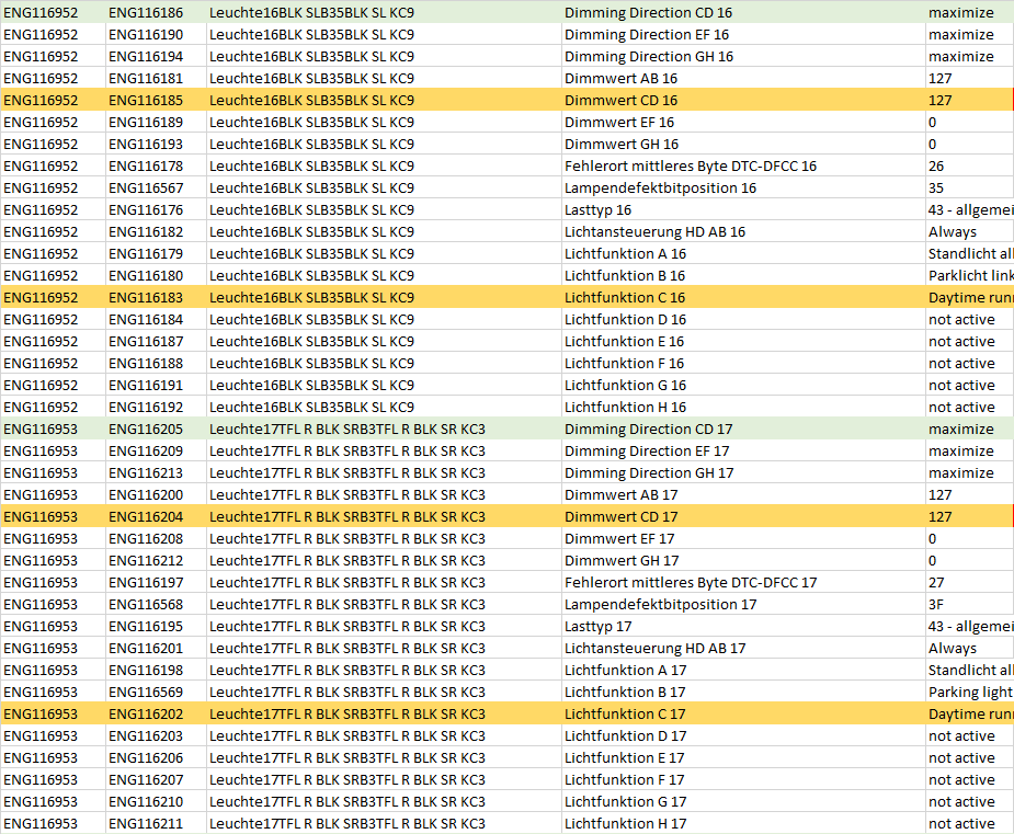

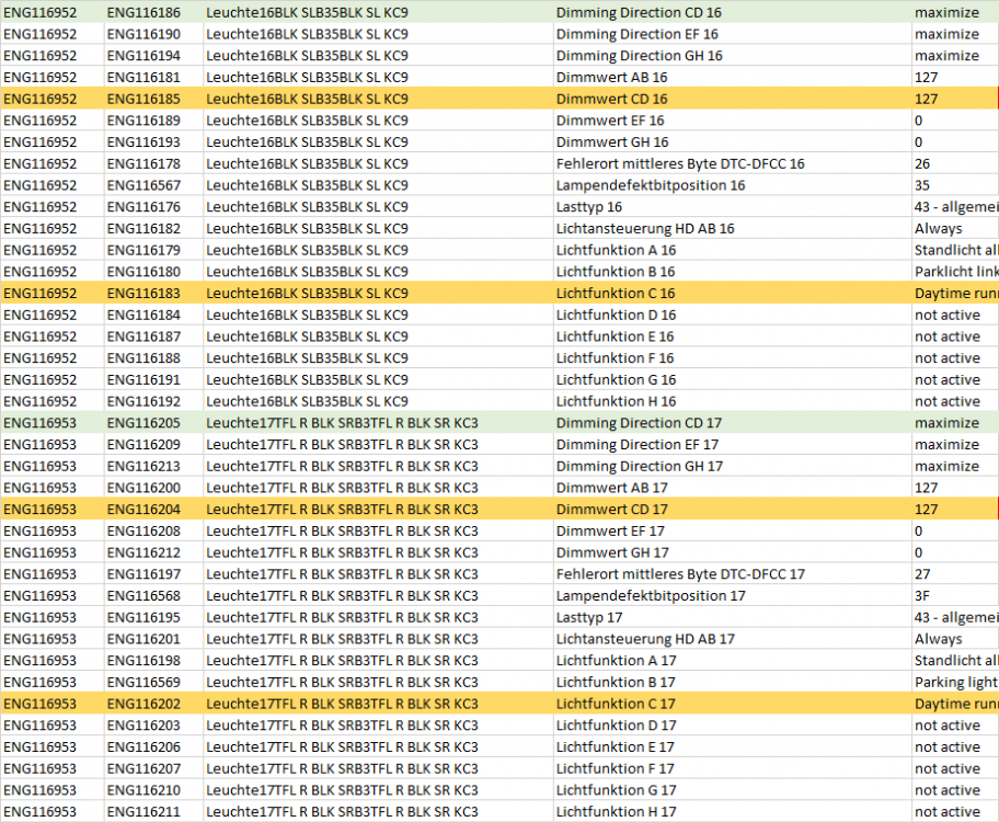

On 03/10/2019 at 21:43, matisere said:
Finally i did this. Thank you for the provided table. :)
