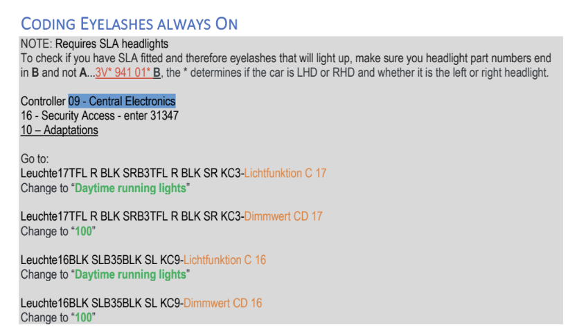

Any one figured out a way to get whiskers set to drl on a 2020 car? (iv) 🤔 the older method for my 16 etc does not work atleast.

I’ve tried searching without luck, so would someone kindly post the coding to enable the whiskers to operate with the DLR’s please? We have a 2016 L&K with them fitted. Many thanks in advance.
What do you call 'whiskers'? Sorry, still not a native english speaker. ^^
Whiskers are the light lines which come as standard with SLA.
09
Access permission: 31347
Adaptation
Leuchte16BLK SLB35BLK SL KC9 (Front left eyelashes)
Light function C16
put on "Daytime running lights"
Dimming value CD 16
Put on "100"
Leuchte17TFL RLK SRB3TFL R BLK SR KC3 (Front right eyelashes)
Light function C17
Put on "Daytime running lights"
Dimming value CD 17
Put on "100"
This encoding will work only for the vehicles which already shine "Eyelashes" in light by the work have. If no lashes out at the park light light, the corresponding lamps are not installed.
That you can easily check if they are installed:
Is available in the channel
Light 16BLK SLB35BLK SL KC9
Light function A16
"Inactive" in it, then the eyelashes are not installed.
Fantastic! Thank you Gizmo! 👍🏻
Do u have the correct type of headlights? i.e. the part number ends in "B".
3Vx94101xB
If so, then the coding below is wat I did on mine.
Thanks for the info mate. No idea what the part number is one our 280. I’ll see if I can find it in a VCDS log which I collected a few weeks ago.
