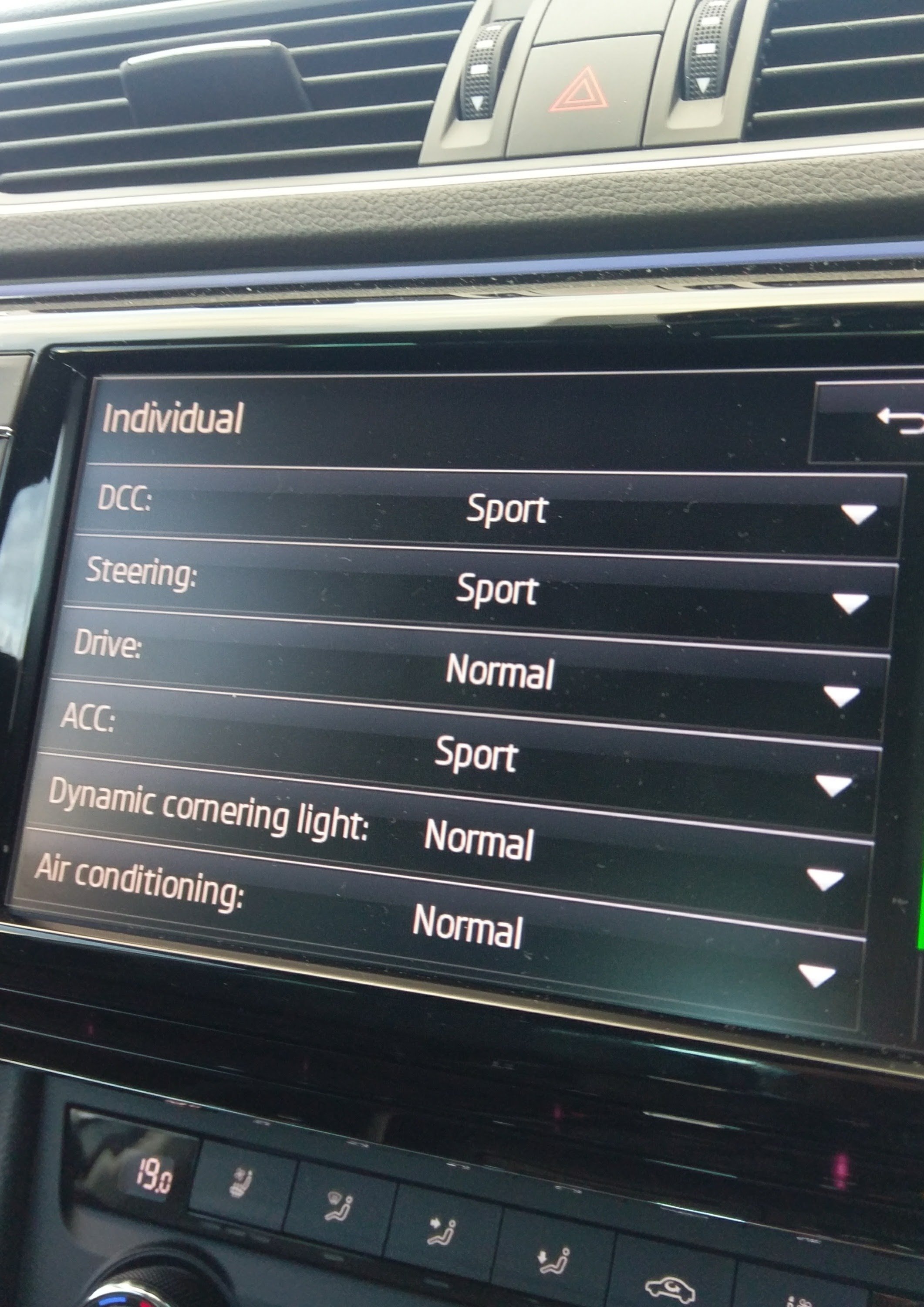

Is there any way to keep the individual setting on the DCC? After every start I have to go into the dopey unit to select individual. My god the new Columbus is slow, a Pye valve radio from the 60s is faster to start up.
Must b an MY20 onwards feature.
Pre-MY20, it definitely remains in Individual mode, even after turning off the car......until u change it to another mode.
The only thing that doesn't stick in Individual mode is the "Drive" mode selection - it will always revert to Normal.
But everything else like DCC, Steering, ACC will remain.
You have a lot more options available. On mine it's only suspension, drive and aircon that are adjustable. It always defaults to normal mode. The suspension in normal mode is horrible it wallows like a galley ship so much you'd feel car sick and the wheels make this terrible whoosh whoosh noise as the car keeps pitching up and down especially on the motorway. I thought it was bad on the diesel car, it's a million times worse on this car.

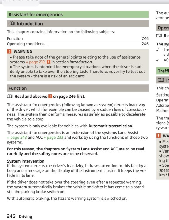

Is possible to coding with obdeleven that car if is in lane asist mode and acc mode that if i dont touch the steringwheel, automaticly stops?
I see on youtube that some superbs can doo this.
tnx
tnx
Is you car an automatic? “Assistant for emergencies” (as it’s called in the manual) is only available on Automatic cars:
Yes its dsg.
Is possible know somebody?

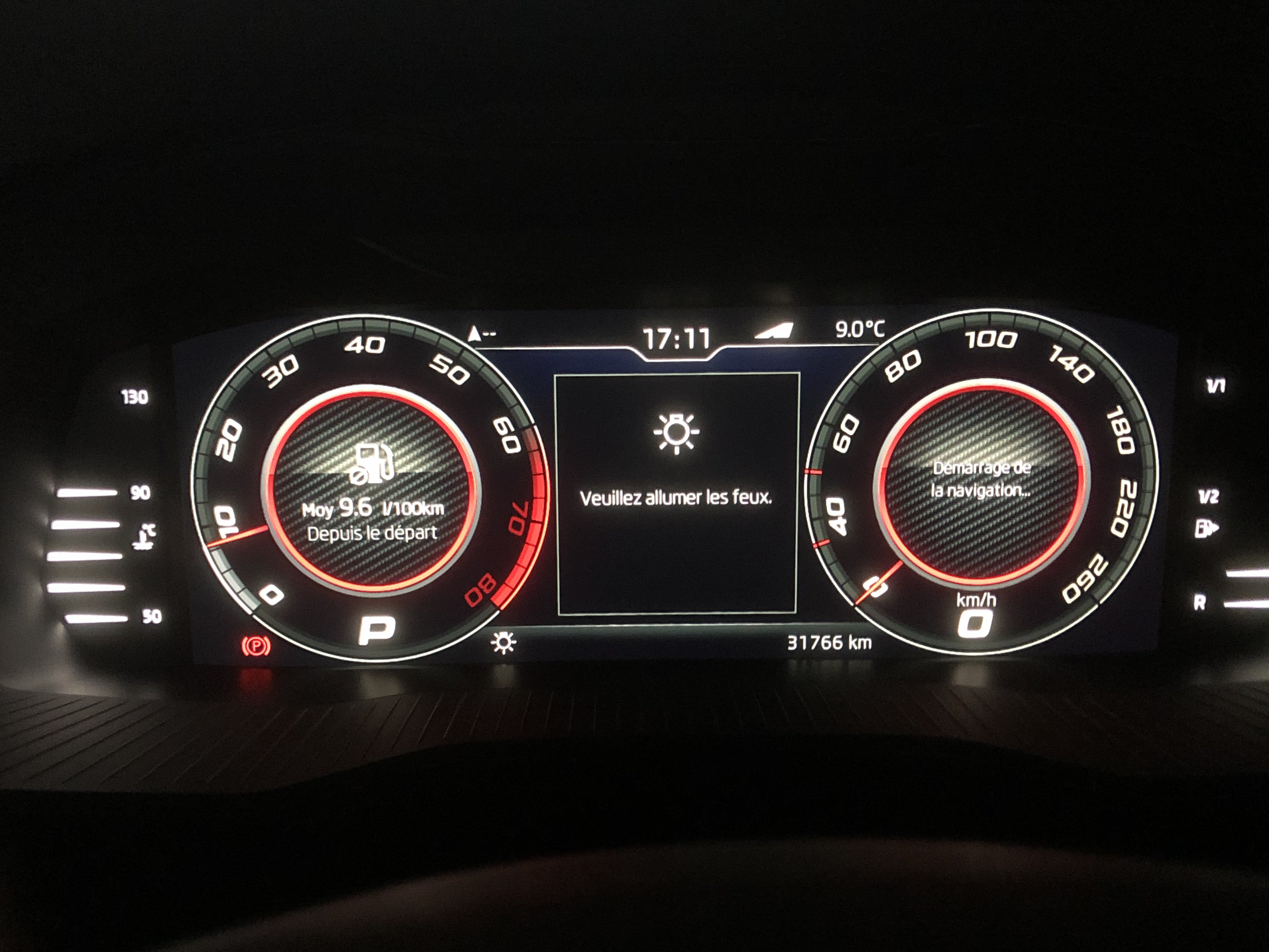

Hello it is possible to coding my virtual cockpit with vmax 280km/h , I have 260km/h and in this forum a member post a photo with 280 in this topic
Superb 2.0 TSI 2019
Thanks

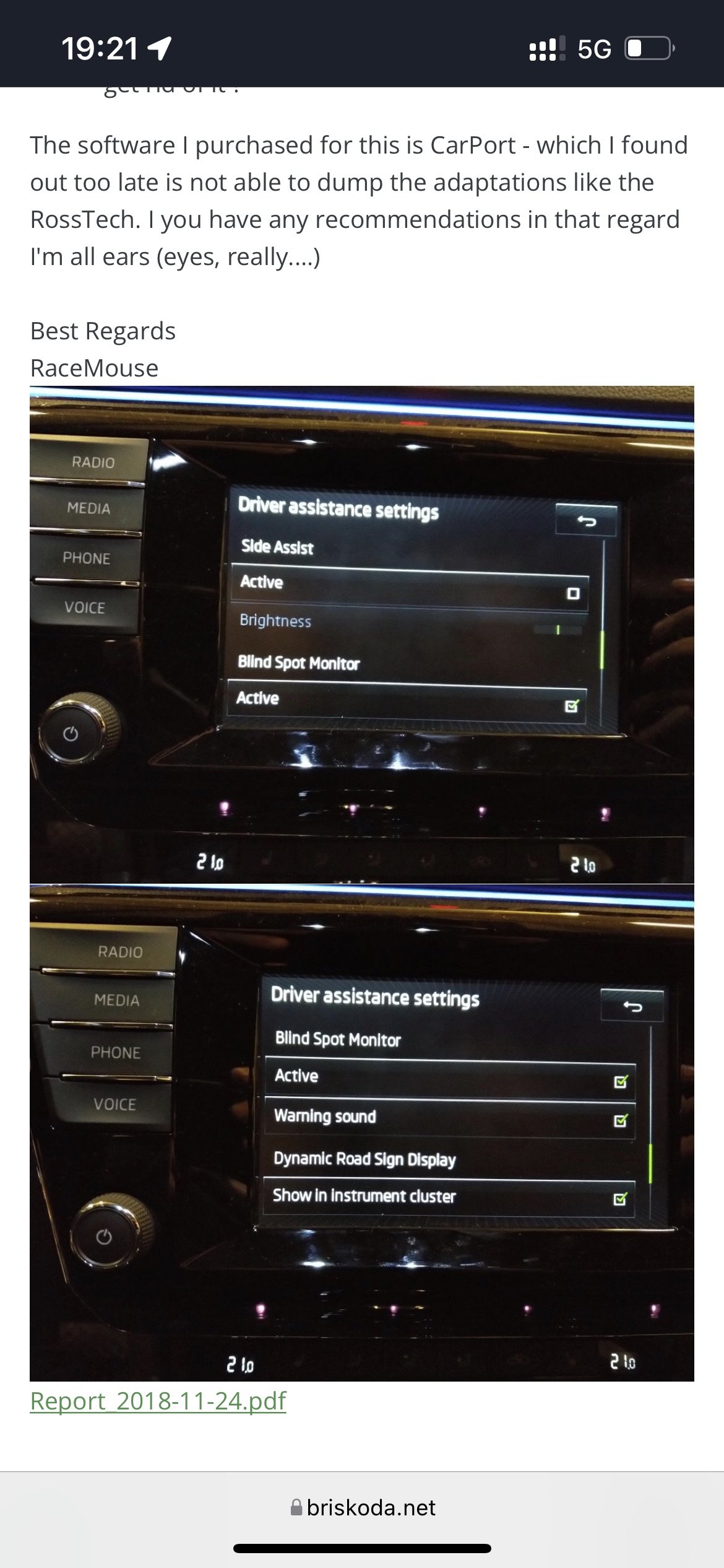

Hi,
Do you know how to:
1. Activate warning sound in blind spot detection?
2. Traffic assist - change time when car start ride himself. Now it’s about 5 second and then I must put pedal to start.
3. Set working radio button on the steering wheels without turn on ignition
4. Turn on button to manually spray rear camera. Now it only works with rear wipers.
7 hours ago, slaslu said:
Hi,
Do you know how to:
1. Cannot b done. Unless u hardwire some sort of buzzer, by tapping into the BSM indicator in the wing mirror, and route into the cabin.
2. Cannot b changed.  It's 3 secs, not 5 by the way.
3. Unsure.
4. Unsure.
Thank you for answer.:)
1. I saw that someone have this option in radio:
Strange, I've never seen that "Warning sound" option before, associated to the BSM.
Makes no sense.
It would b very annoying if it dinged everytime a car is in ur blind spot.
Normal operation is for the steering wheel to vibrate (resist) if u try to change lanes with a car in ur blind spot.
I have this feature in my last car and it only beeps when you want to change line and you have other car in blind spot.
