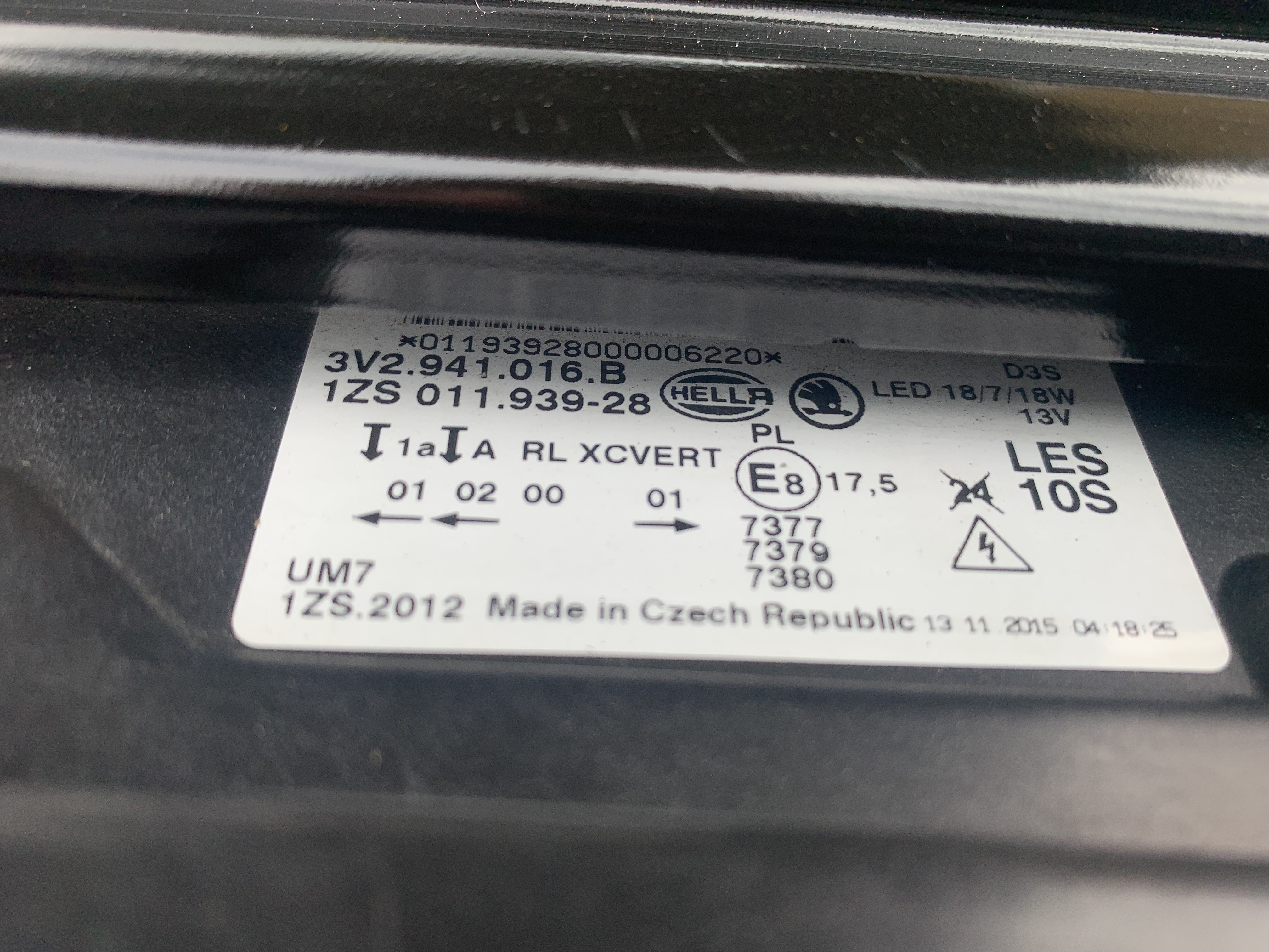

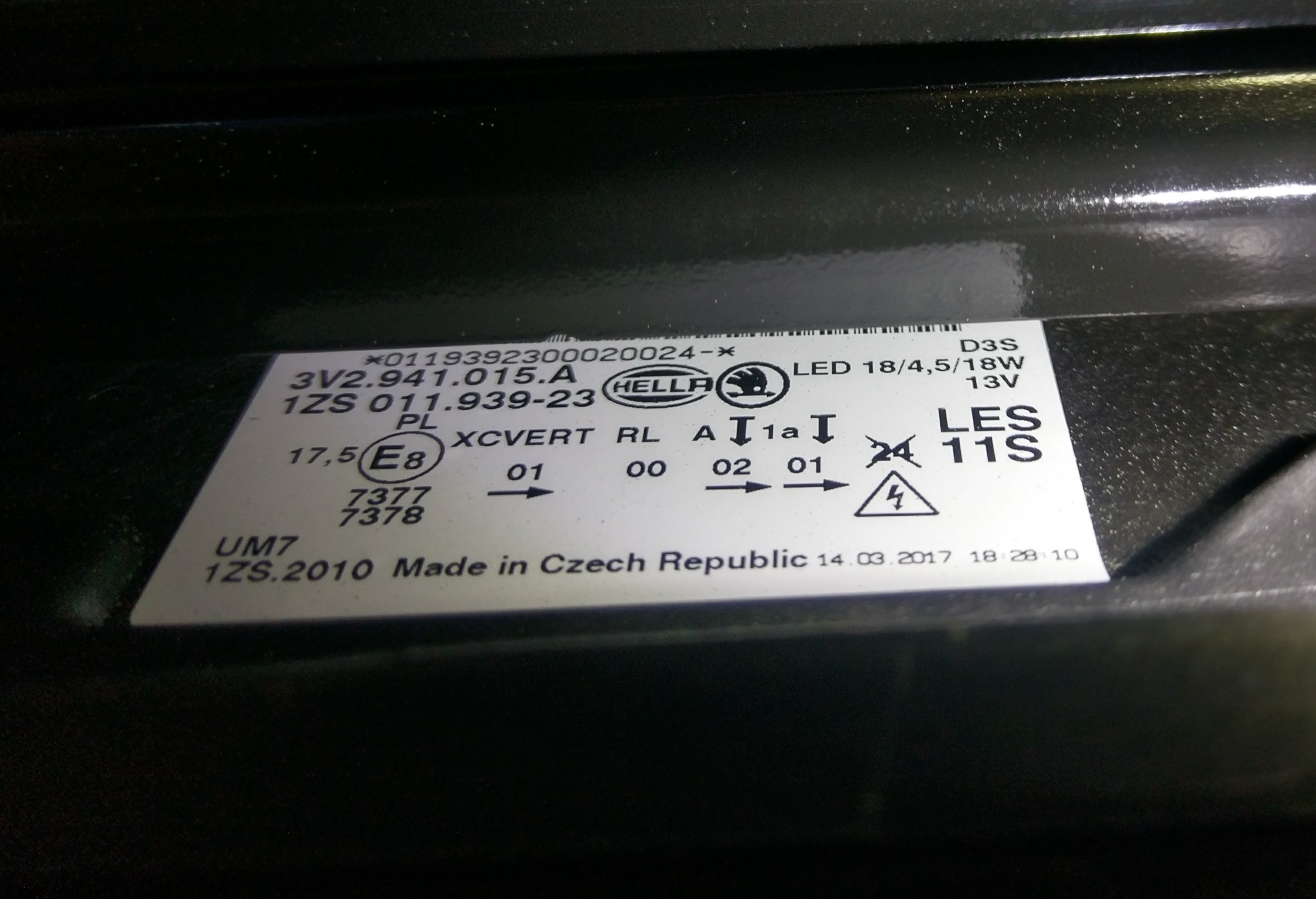

VCDS or OBDEleven won't tell u ur headlight part number.
Pop the bonnet, and look for the white sticker on top of the headlight.
Looks like this....
This one is my original, non-SLA "A" version, before I retrofitted SLA "B" versions.
Edited by JR RS
 Cheers… I’ll report back later this morning (it’s 05.28 and dark!).

Yep, they’re B Type units.
Brilliant!!
Enjoy ur whiskers....or eye lashes 😁
