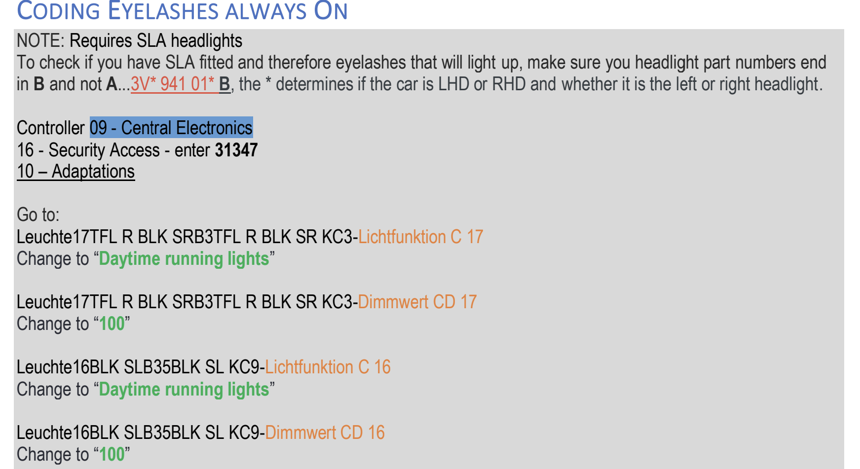

U need to make sure u have version B xenon headlights, otherwise the coding won't have any effect.
Only version B headlights have the hardware to light up the eyelashes, or as I call them - whiskers.
Image below is wat I did to enable mine.
No, the coding will definitely not work with a facelift Superb.
Thanks mate. So how do I know if I have Version B?

I have the correct B version but unfortunately the coding, which I checked 3 times, didn’t work. ☹️ Somewhat frustrating…
Bugger, that's no good.
Mine worked first time, and I know of others over the years who have also successfully coded it.
If u have version B headlights, by default, the whiskers will only light up when the low beams r on.
In DRL or side light position the whiskers r off.
The coding posted enables the  whiskers in all positions.
The should dim, like the DRL strip, when either in side light position, or low beams r on.

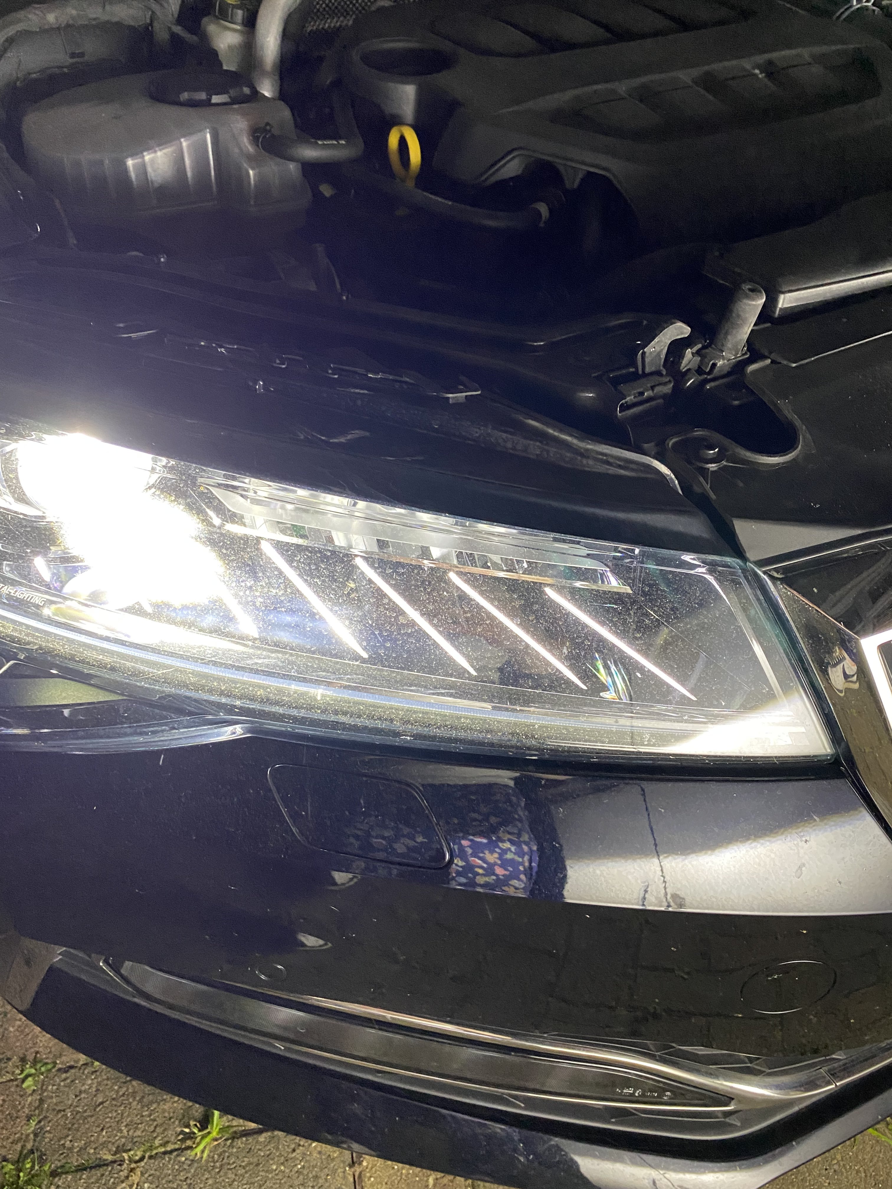

Thanks for clarifying JR. I’ve just popped out (SWMBO thinks I’m insane - it’s 3.15 here!) and checked. So they work; they do come on with the switch in side light position AKA dim DLR’s. Given I’ve never used side lights in 45 years of driving and the light switch is always in auto, what I thought “Coding Eyelashes Always On” meant exactly that and they would be on together with the non-dimmed DRL’s, with the switch in the auto position. Guess its a “not what you say but the way that you say it” scenario and should say “Coding Eyelashes On With The Sidelights”.
The eyelashes on mine are always on.
- Auto or Off: DRL stripe full brightness, Eyelashes full brightness  (u can see it in the image below, and the previous image i posted)
- Side light on: DRL stripe dimmed, Eyelashes dimmed
- Low beam on: DRL stripe dimmed, Eyelashes dimmed

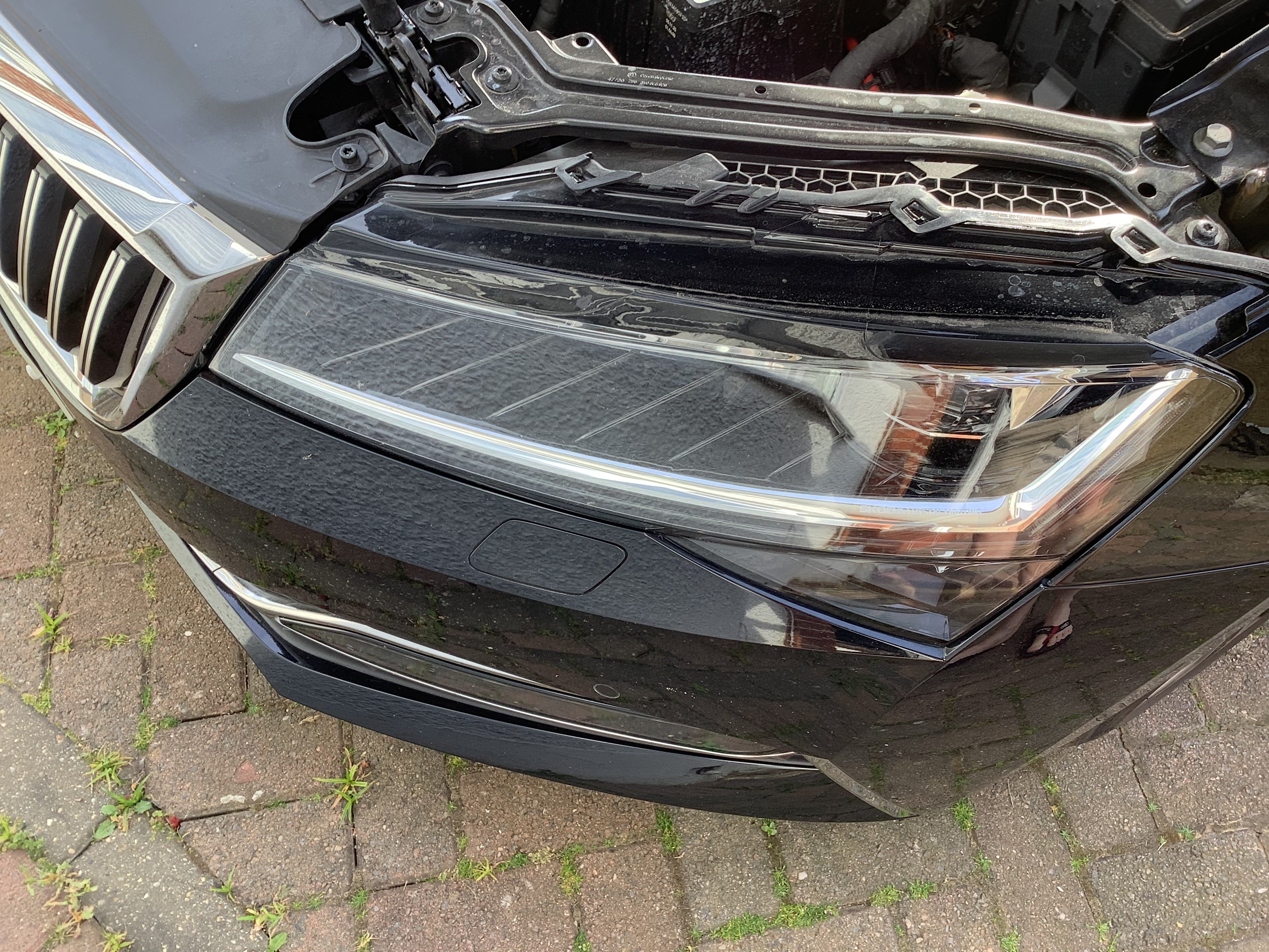

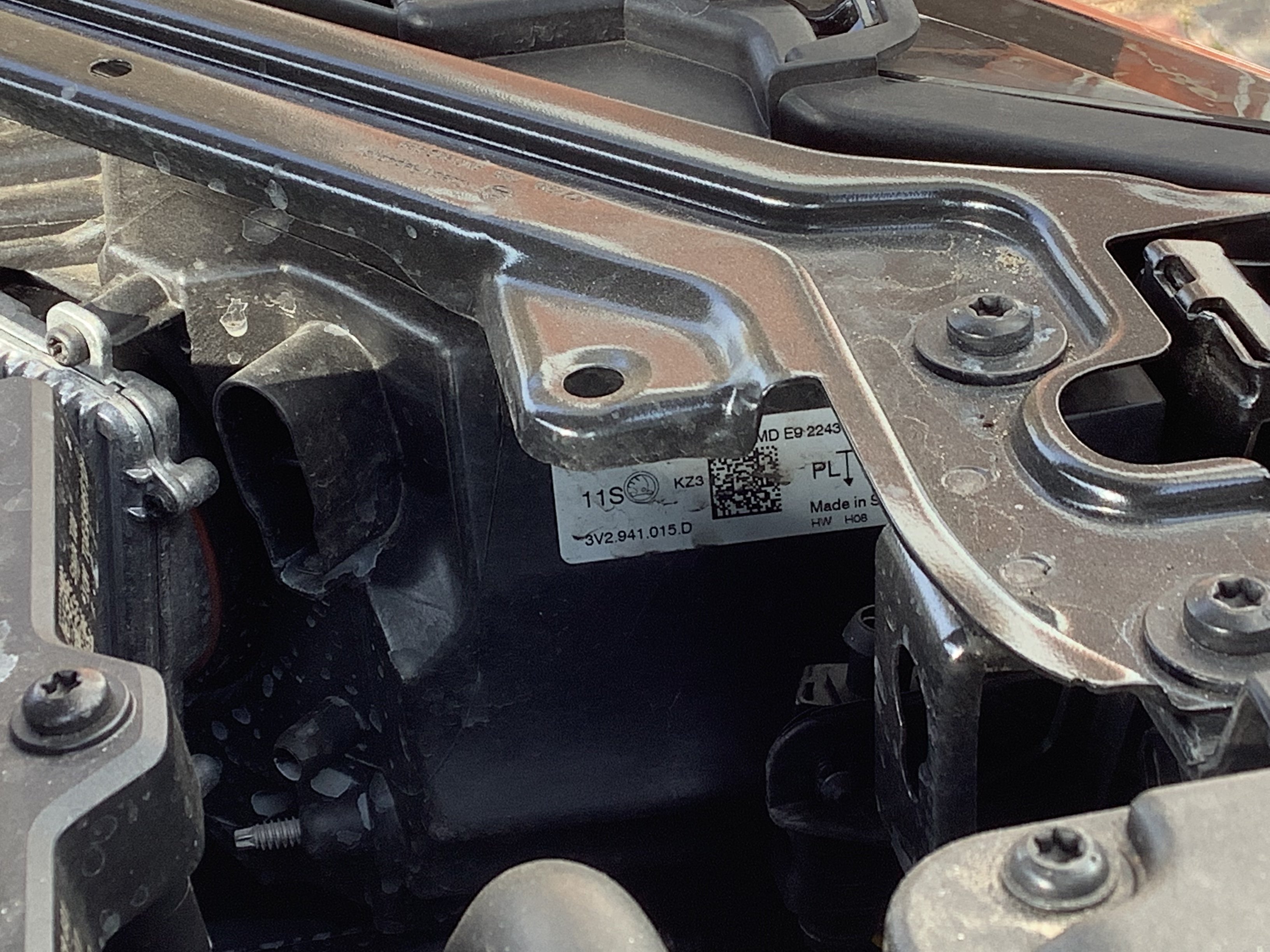

Well the only stickers I can find on my headlights end in D, not A or B.
Near side unit
Edited by travs
Clearly eyelashes.
They ALL have eyelashes, the question is only if they are LIT.
Edited by mtl
The sticker is on top under the black metal cross bracket. Your headlamps don’t end in D. Will be A or B.

@travs - u have a facelift.
They have an entirely different headlight setup, especially the hardware & electronics.
They behave different too.
The coding & discussion above is pre-facelift related.
The coding is not applicable to the facelift version.
Edited by JR RS

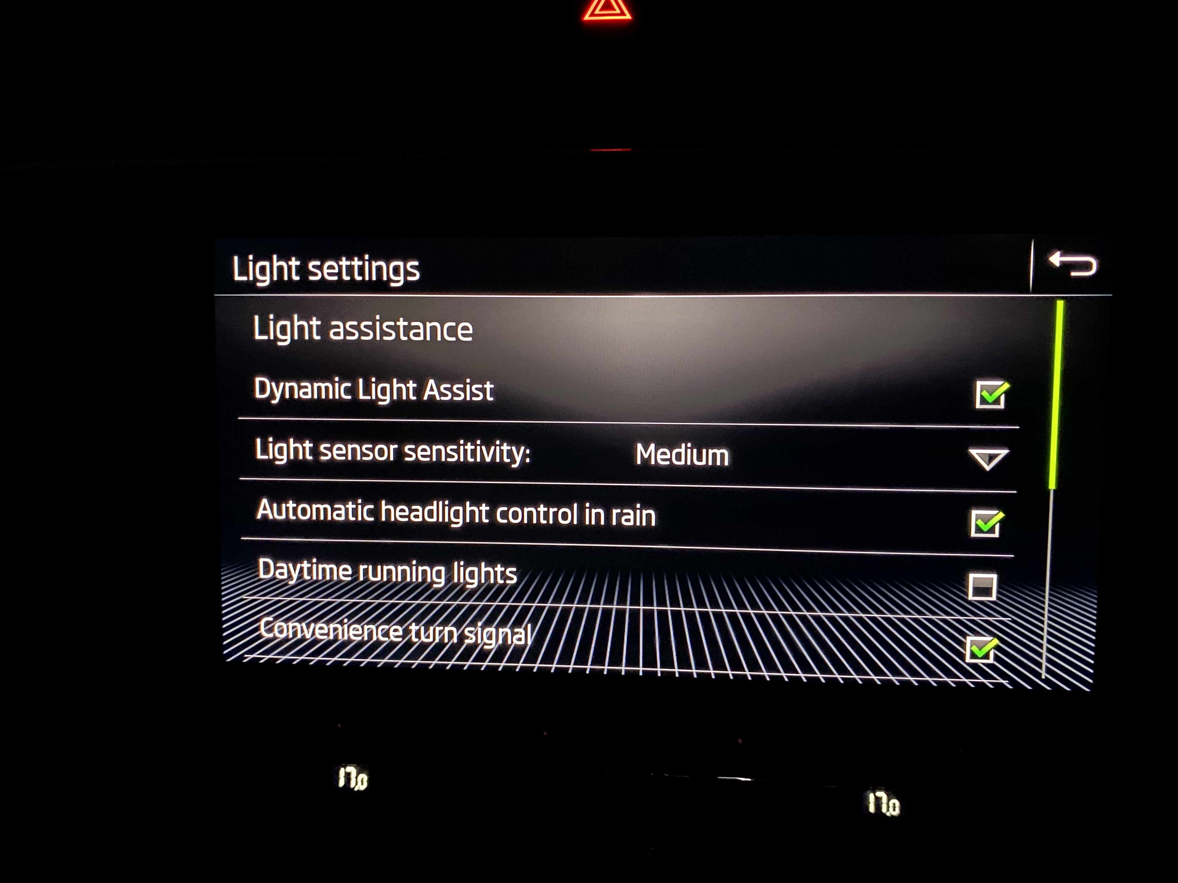

1 hour ago, ApertureS said:
You can also just check your settings - vehicle - lights section for High Bean Assist or Smart Light Assist
Not quite correct.
It will only ever show "Dynamic Light Assist" in the infotainment, if u have HBA enabled, or have SLA headlights, but u won't b able to distinguish between version A and B headlights with this.
if u don't have HBA enabled and version A headlights - it will show "Light Assist".
if u have HBA enabled and version A headlights - it will change to "Dynamic Light Assist"
version B will already show "Dynamic Light Assist".
Edited by JR RS

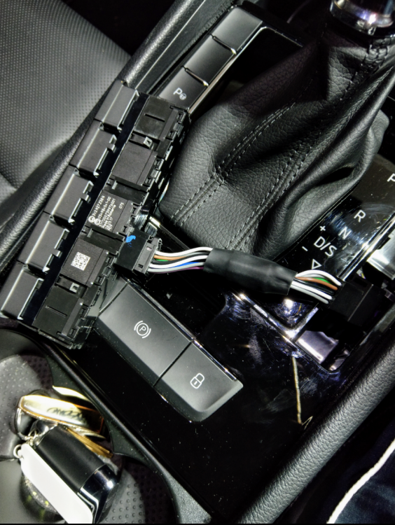

I put a start-stop memory module - brilliant as it keeps the start stop switched off, or on, depending on how u left it, and u still have the option to use it at ur command.
No errors. No warnings. No tricking.
Beats permanently disabling it by coding it out.
