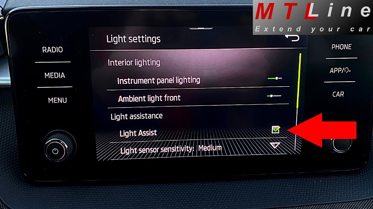

Can anyone help and be more specific how do I lower the sensitivity of auto headlights in VCDS?
They turn on much early in the day.thanks
@MartiniB may help you. If I remember well, he did this mod. ;)
there is a setting "Light Sensor sensitivity" in the infotainment, under Light Settings, to select Early, Medium or Late for the auto headlights.
have u tried that?
You are right was on medium,I feel silly
