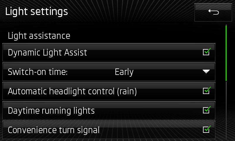

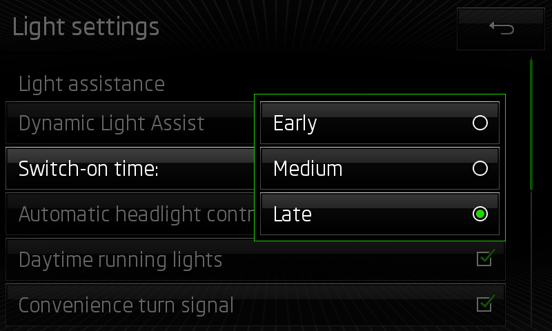

Hey VCDS experts, please help me,...
I have a Skoda Superb 2020 TDI 150 with matrix headlights.
The headlights go out late in the morning and likewise turn on in the early afternoon.
I have actually tried all the combinations proposed here in this forum but I'm not succeeding.
Is there anyone who can help me change the time for turn on and turn off (morning/evening)
I inserted a 00 scan
Language is Danish.

You cannot adjust the TIME.
Check in the light settings that you have Switch-on time set to LATE.
THIS ^^^
The lights come on and go off when the light sensor detects the light has dropped to the set limit, nothing is time based.

In the MIB settings, under lights you will find 3 options to adjust how fast they turn on or off when the sensor requests on or off, thats it, nothing more, nothing to be done via coding!

4 hours ago, Paikesejanku said:
So it is impossible to have 2-in-1 late DRL/Xenon switching and fast automatic High Beam on?
yes, without visit CAR -> Settings -> Light
most of time i have `Late`
but in the evening, for me very rarely, i have to switch to `Early`
in other case High beam can be activate only manually
175Mb video http://www.superfm.lv/m/Auto/Superb_2016/20190825_no_Automatic_Highbeam_02.mp4
~ 15 minutes later it started to work automatically also with parameter `Late`
