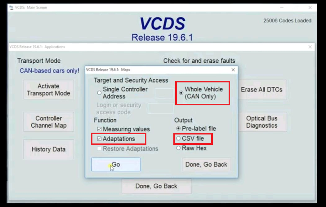

I wish there was a full-full scan that saves all the adaption channels too, as we often dive into those for changes.
It can do adaption maps for all modules, it's just not part of the autoscan as it takes a while to complete - about 10 mins looking at the last one I did :)
VCDS >> Applications >> Maps
Random screenshot from google, I tend to choose the red highlighted options:

Everyday is a school day, I tend not to muck about "under the hood" too much, but nice to know that there is a scan full-full option 😄
I only tend to do a full car map backup on my own car.
If I'm recoding other peoples cars, I'll use the same tool but typically only do maps for the modules I'll be touching. Pretty useful on the BCM given the number of similar looking German channels!

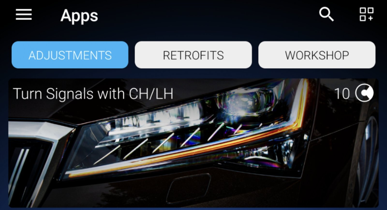

Hello guys.
I got a couple of things I want to correct and I really don't know how and where to look.
Obdeleven recently got an app update for the Superbs CH/LH lights.
Now the turn signals on the front or/and the back light up when locking and unlocking the car.
I like the look so much I would like this during the day as well, but CH/LH lights only light up, when it's dark enough.
Is there any way to change the parameters?
0-02-05-9108716aa6ffdb96f9add44dddf3c226e8dec33d95de5bfb8fc77a876f491427_4c252ccc23e73e56.thumb.jpg.11b572e1d9fe46d5d982ece6c571f490.jpg
the other thing I want to achieve is this:
(only folding the mirrors with a long press to reduce the wear on the motors)
Any ideas?
Best regards, MR

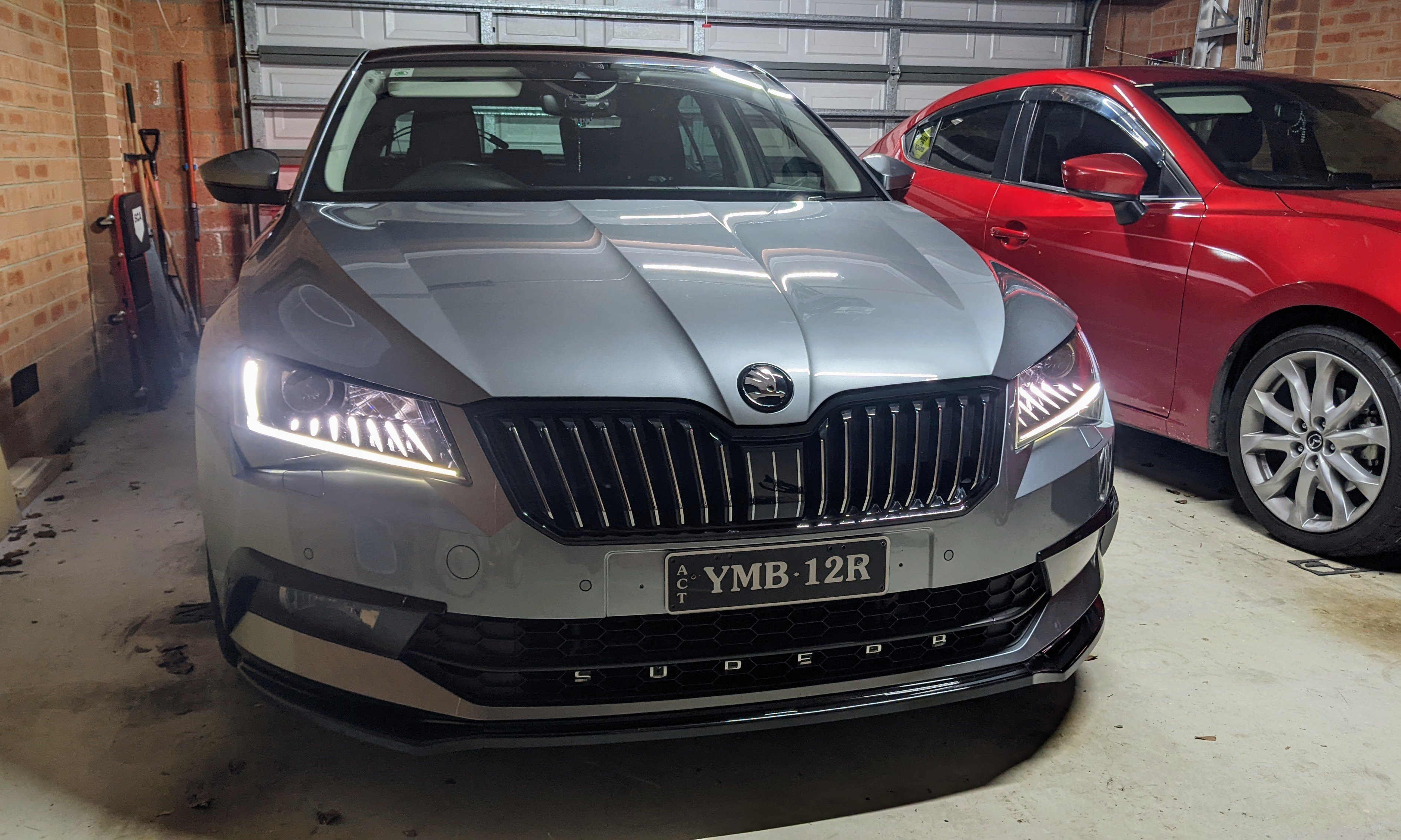

I successfully changed coming/leaving home from xenons to DRL:
Address 09
disable xenons:
ENG116942-ENG115993-Leuchte6ABL LC5-Lichtfunktion C 6		adapted from	not active 	to	Coming Home oder Leaving Home aktiv
ENG116942-ENG115996-Leuchte6ABL LC5-Dimming Direction CD 6	adapted from	maximize 	to	minimize
ENG116943-ENG116012-Leuchte7ABL RB1-Lichtfunktion C 7		adapted from	not active 	to	Coming Home oder Leaving Home aktiv
ENG116943-ENG116015-Leuchte7ABL RB1-Dimming Direction CD 7	adapted from	maximize 	to	minimize
enable DRL strip:
ENG116939-ENG115946-Leuchte3SL VRB21-Dimmwert GH 3	adapted from	0	to	27
ENG116938-ENG115927-Leuchte2SL VLB10-Dimmwert GH 2	adapted from	0	to	27
ENG116939-ENG115944-Leuchte3SL VRB21-Lichtfunktion G 3	adapted from	not active 	to	Coming Home oder Leaving Home aktiv
ENG116938-ENG115925-Leuchte2SL VLB10-Lichtfunktion G 2	adapted from	not active 	to	Coming Home oder Leaving Home aktiv
@midlan What year is your car?
SWMBO prefers to have the CH/LH option on her profile but I just consider it a waste of xenon power as we live in a decently lit area. If it only did the DRL’s then I may be persuaded to alter mine - the car park location assistance occasionally comes in handy too. 👍
@john999boy
My car was made 3/2016. I have it with eyelashes and it looks awesome. I will take picture of it.
Took the picture of CH/LH lights using DRL strip 🙂
Mine does the same thing for CH/LH, but with foglights as well.
Quick question, how do you get the inner lines to lit? 🤷🏻 Mine does not in my2020
