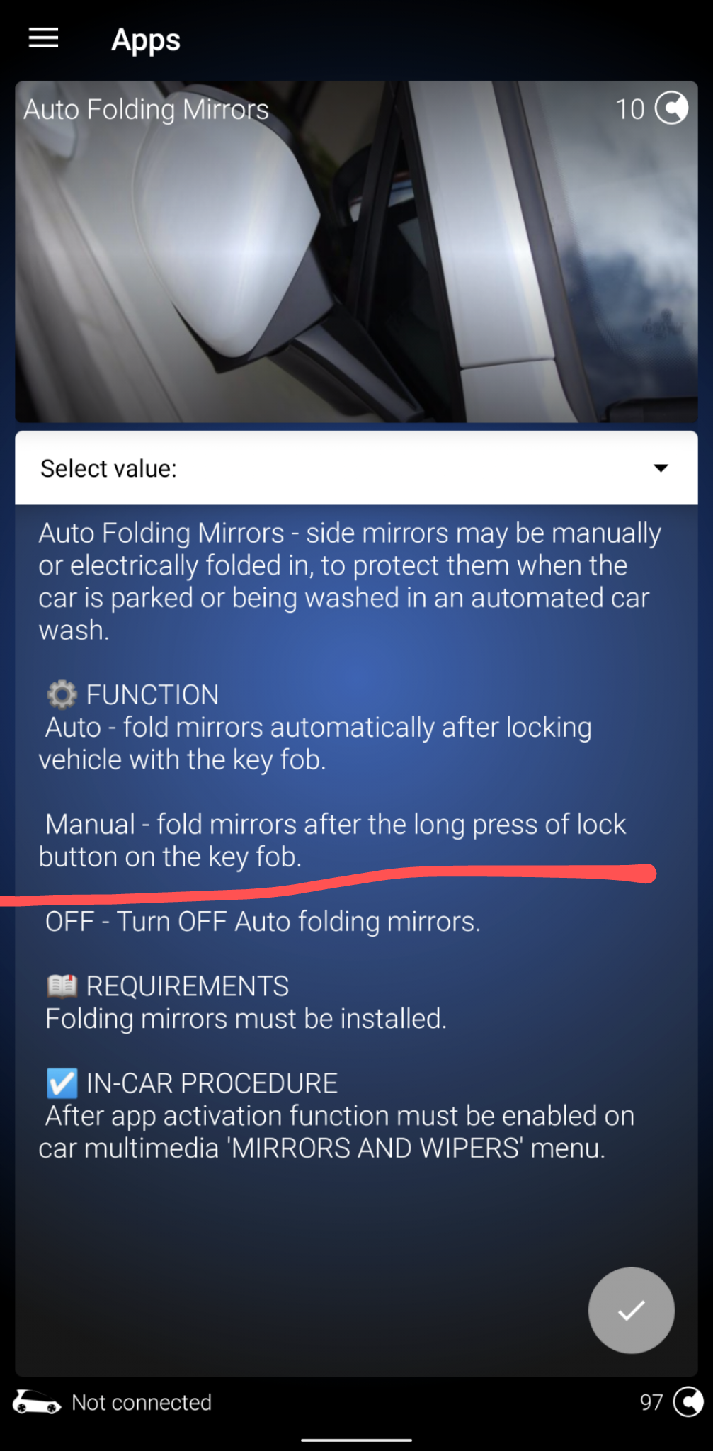

the other thing I want to achieve is this:
(only folding the mirrors with a long press to reduce the wear on the motors)
Any ideas?

I foud a solution for the mirrors:
there is an app in obdeleven. Just select Manual and it works like i wanted to. (don't know what to do in VCDS)
Hope it helps someone.
Still got nowhere with the CH/LH lights...
Best regards, MR
Thanks for that, what app is it? The long press is a much better system.
@j caff
Go to:
Garage
Skoda superb
Apps
Auto folding mirrors
And select manual
5 hours ago, mr93 said:
@j caff
Go to:
Garage
Skoda superb
Apps
And select manual
Thanks for replying I had never used the apps before but I found a very good guide on the old faithful YouTube, it worked a treat, many thanks. There are other ones there that I might try out, auto lock when you walk away looks very handy.
