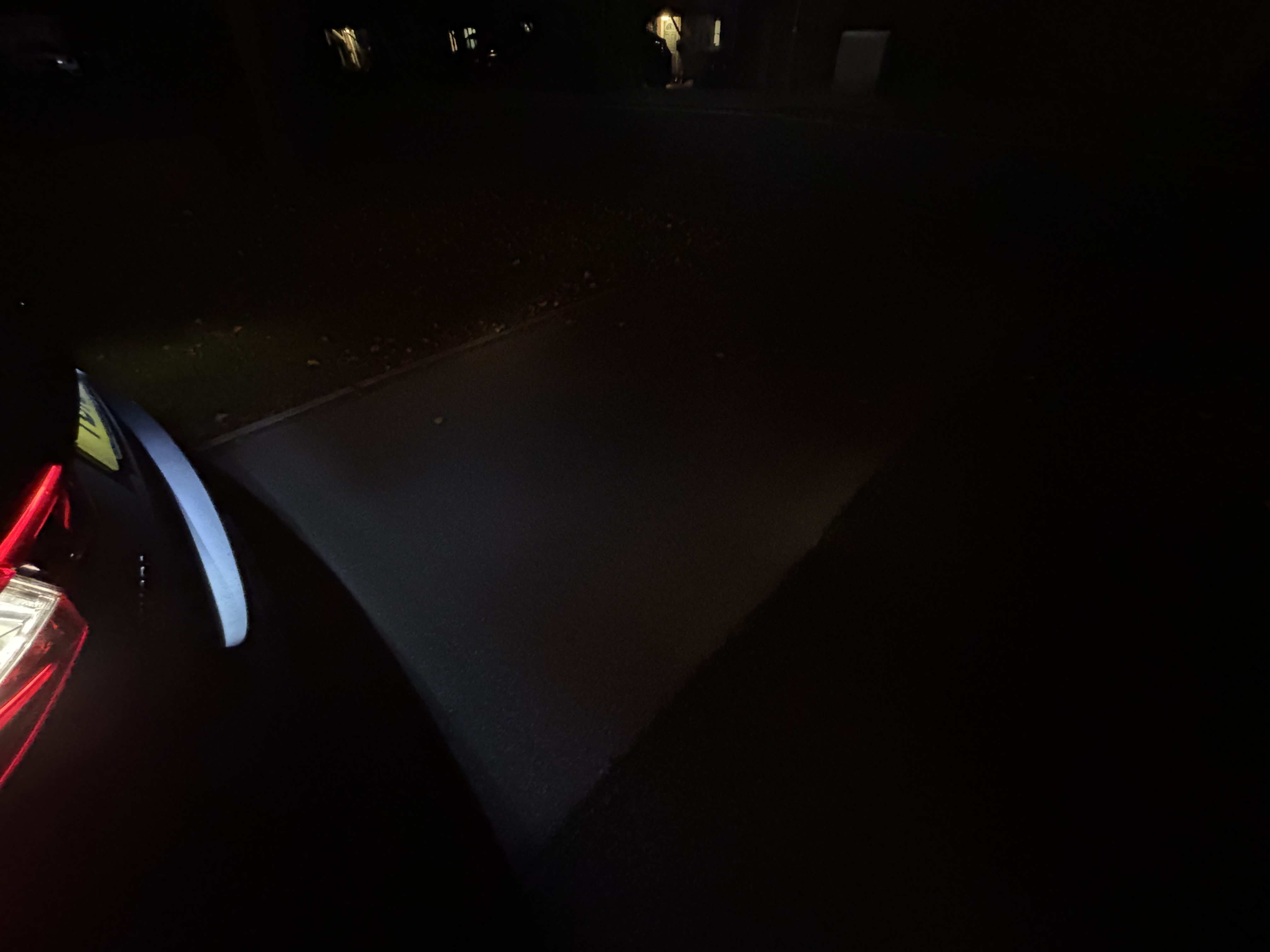

Hold that thought!
I’m literally replacing mine tomorrow and will update with before and afters around 5:30pm and hopefully saying no errors

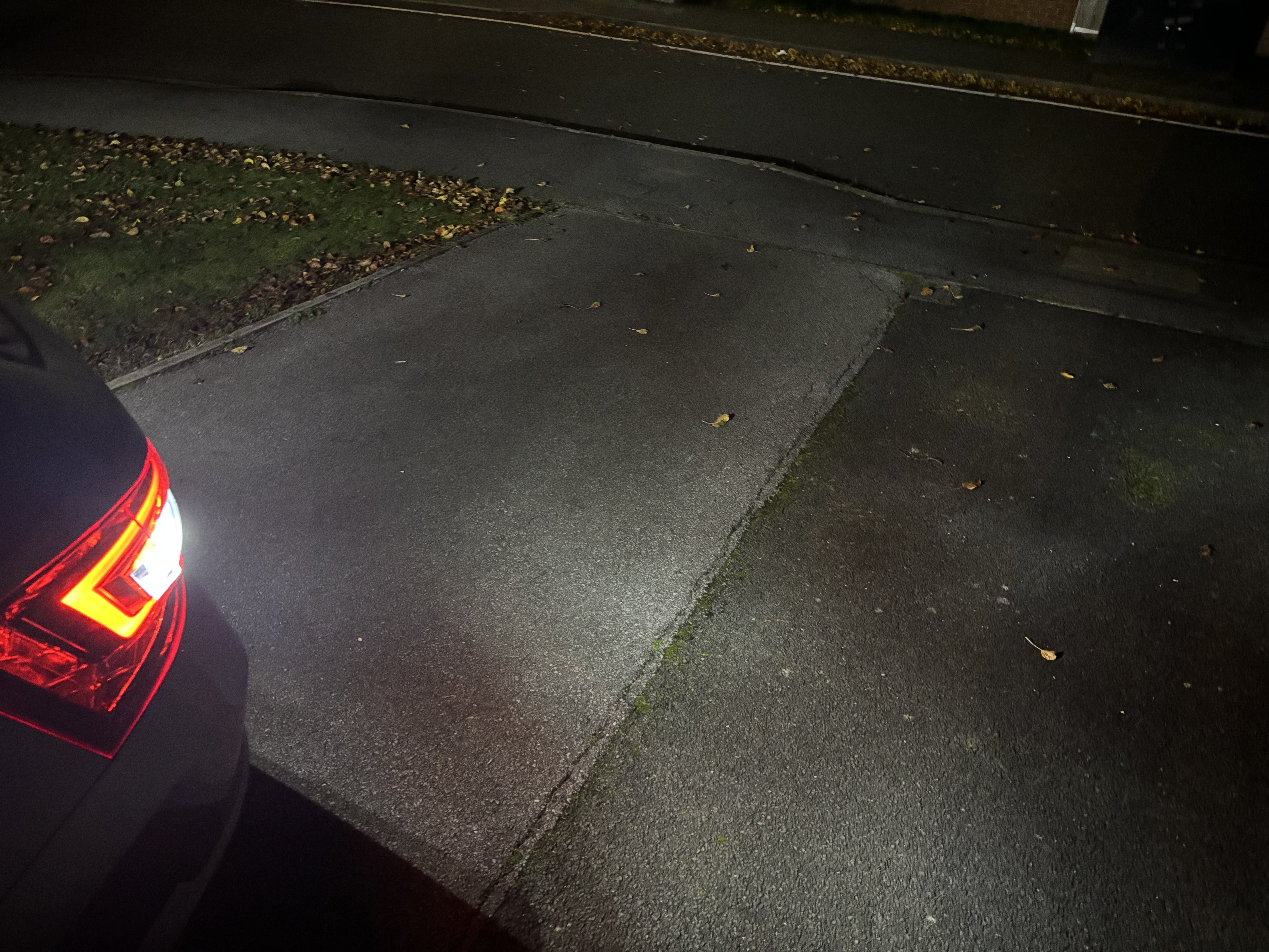

So results in, better but no blown away
after
it looks nice and bright there but inside can’t really notice much difference
This is inside before and after
after
this is what I bought with BF discount
https://autobeam.co.uk/collections/382-p21w/products/led-382-reverse-unit-set
I reckon we’d get the Wow factor with the ones JR RS uses but only in Australia and I suspect shipping is crazy.
No errors on dash though which is good, maybe if it was pitch black it would be better but not many times I’d be reversing when it’s pitch black
Thanks for the pictures 😊
I used my car last night and seemed a lot brighter, I used them later on and remembered my council is stingy and dim the street lights at 11pm.
I’d say it’s worth it and even though when I took the pictures I wasn’t massively impressed they are still way better than originals
