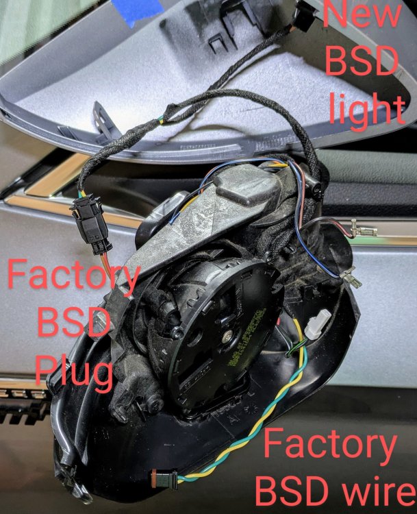

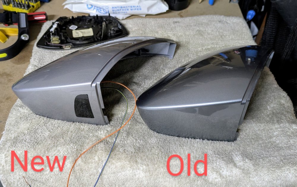

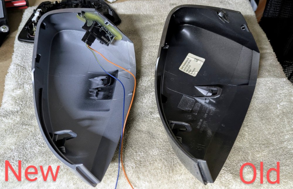

@MartiniB - for the wing mirror cover with BSD retrofit, below is the how it was connected up, if anyone is interested.
Edited by JR RS

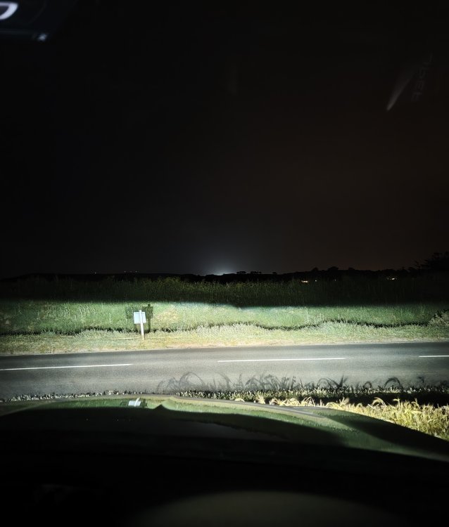

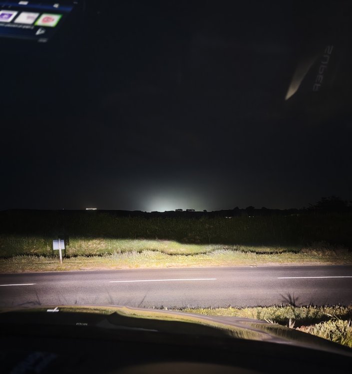

A long time ago I changed the factory D3S bulbs for Phillips XtremeVision Gen2 D3S bulbs.
They were a nice improvement.
This was footage of it...
I recently replaced them with LED D3S, made by J.W.Speaker.
Massive improvement.
This is with the LED bulbs...

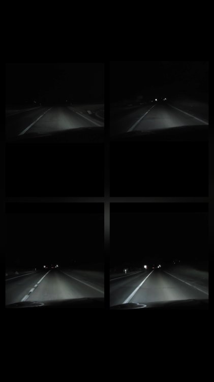

I have replaced my hid bulbs, I suppose they were stock ones.
Philips Xenstart old ones.
Osram Night Breaker 220 new ones.
Light was tested at the same road, 1 day difference, same headlight settings and same camera manual settings. So comparison is valid, not amplified with camera auto settings.
Upper old
Lower new
Left is main beam
Right high beam
Upper old
Lower new
Left is main beam
Right high beam
That’s a great improvement. I love the nightbreakers. I used to have them in my golf many moons ago.
