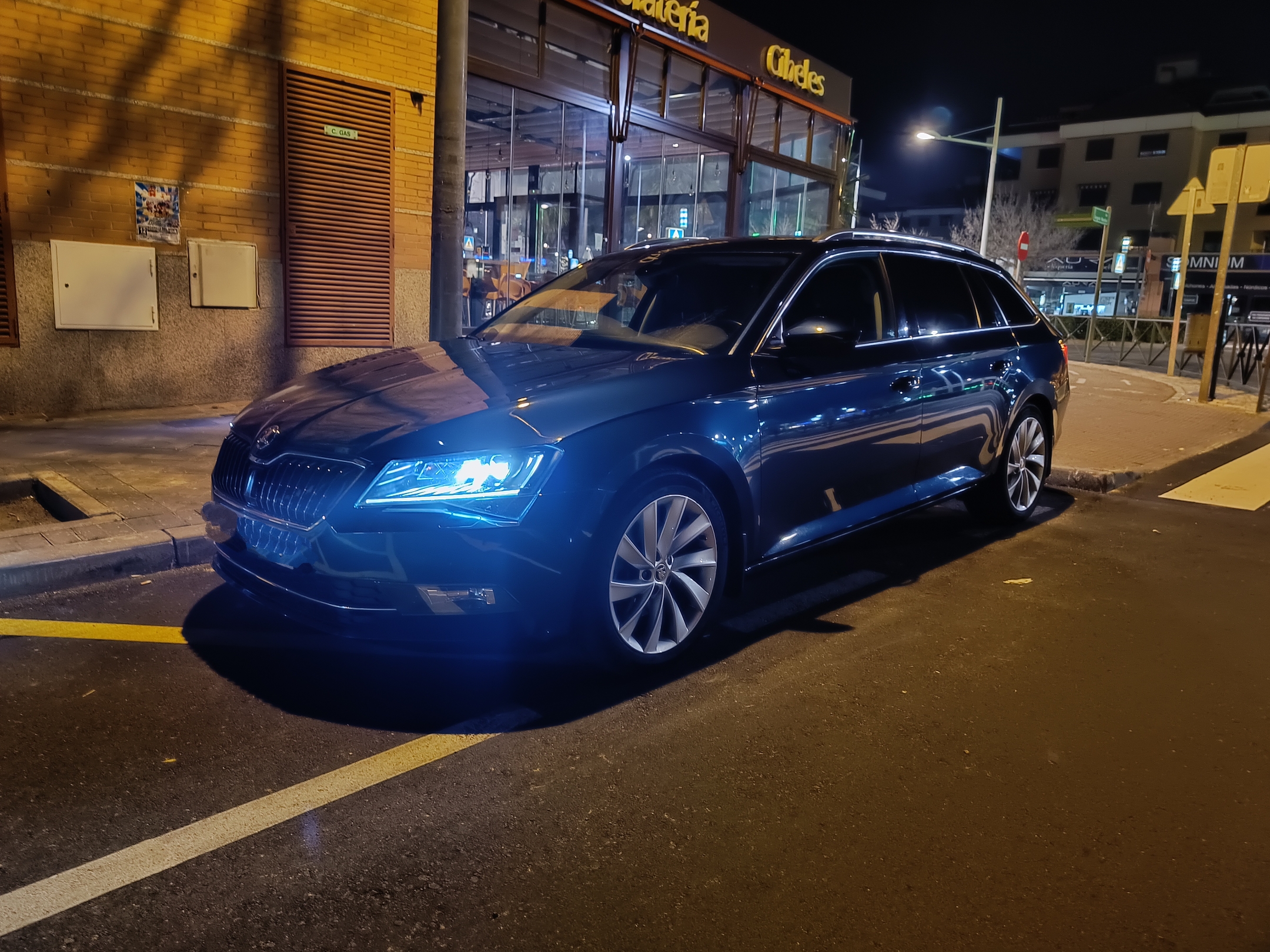

Installed d3s led bulbs.  The brutal 3s change compared to xenon and better than the standard original led.
How about heating?  It has radiator and fans. Is it usable during hot summer time? How hot do the back of the cover gets?
2 hours ago, Paikesejanku said:
¿Qué hay de la calefacción? Tiene radiador y ventiladores. ¿Es utilizable durante el caluroso verano? ¿Qué tan caliente se pone la parte posterior de la cubierta?
No problems of any kind.  It has a heat sink and the headlight itself does not get hotter than with a xenon.  Used on long night trips with no problems.  Used in the rain and very good.
This summer I will use them, but they heat up less than a xenon.
 A recommended change.

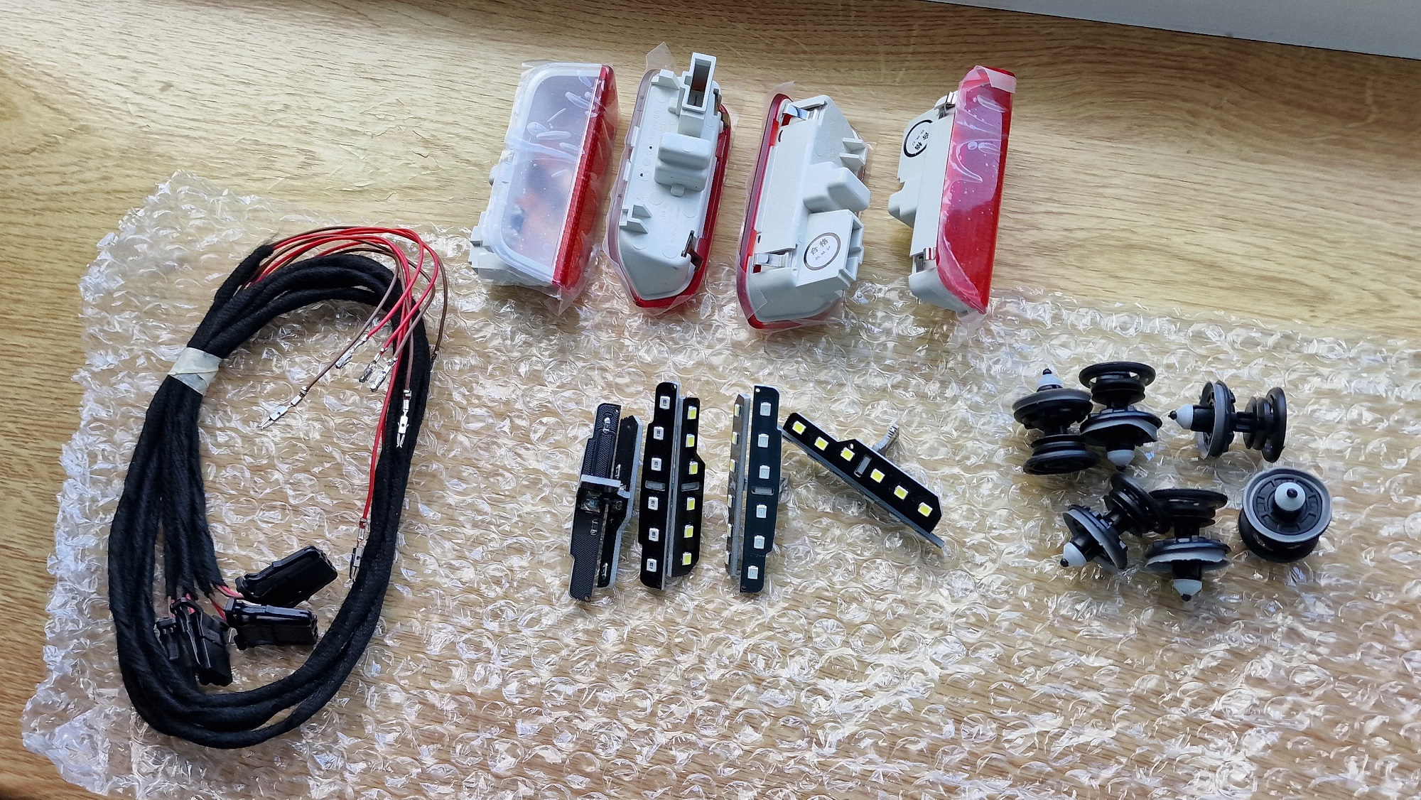

Hi,
I finally installed the 6+6 LEDs (6 red + 6 white) such as these on my rear doors:
This looks like this:
The red lights look a bit clearer than they actually are.
I think I'm gonna install the 2 remaining sets on the front doors, since I'm a bit "fed up" with the Skoda logo:
It has something 'too much' for me.
@MartiniB Thanks for your advices
I finally installed the 6+6 red and whites LEDs. No more Skoda logo on the floor for front doors. Back to simplicity :

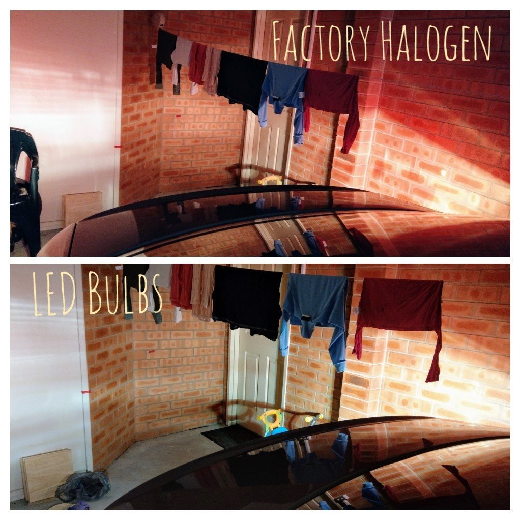

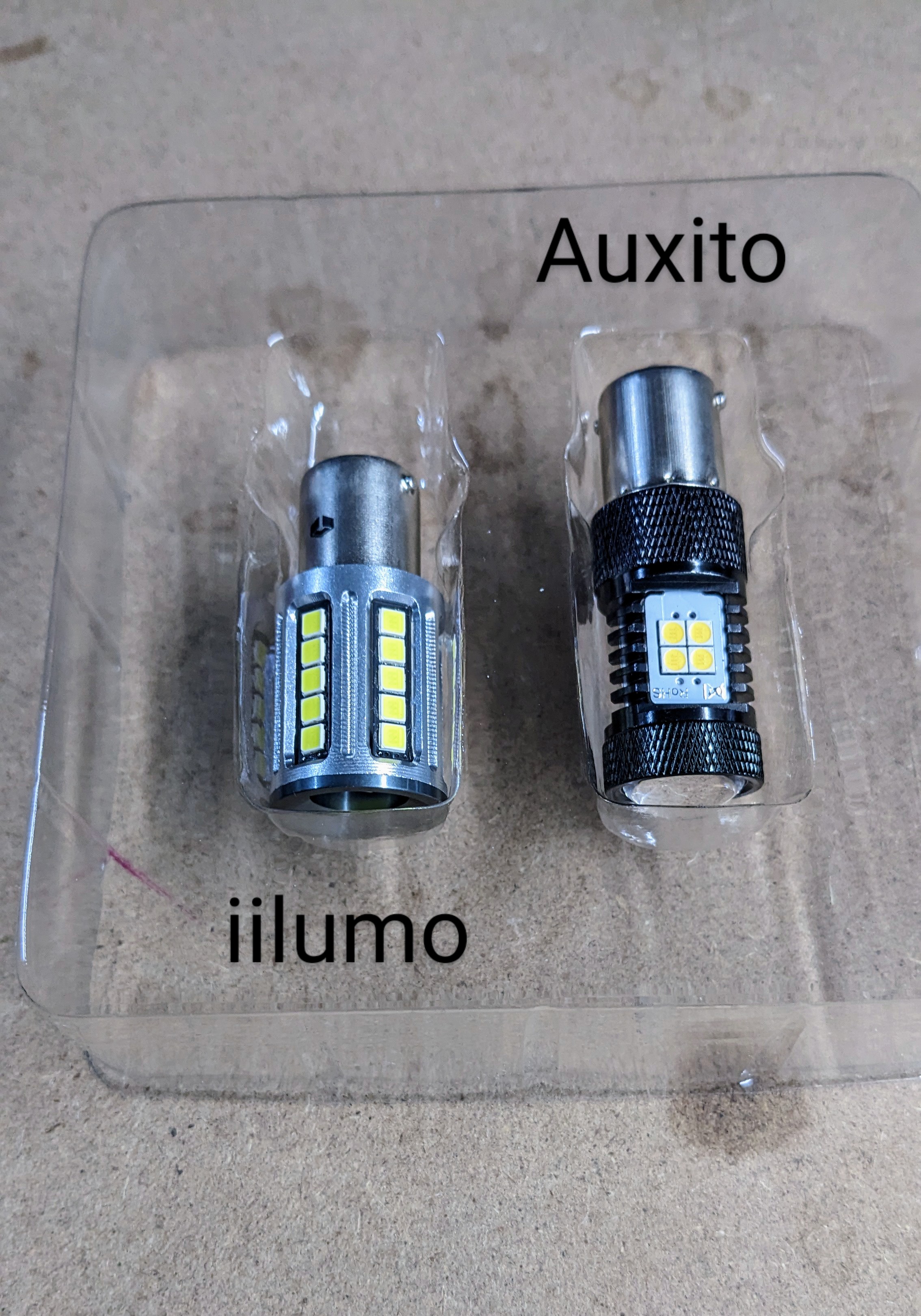

A couple of years ago I upgraded the factory halogen reversing lights with Auxito LED lights.
While the improvement was great, I still found it a "bit" lacking.
So I put a set of iilumo LED lights - phwoahhhh, a nice improvement again.
Then....
Now....
The comparison...
Edited by JR RS
Then....
Now....
The comparison...
AHH feck, I was delighted when I saw this post, turns out you're in Australia @ 60 odd bucks they aren't cheap either.
indeed they're not cheap, but they're good :)

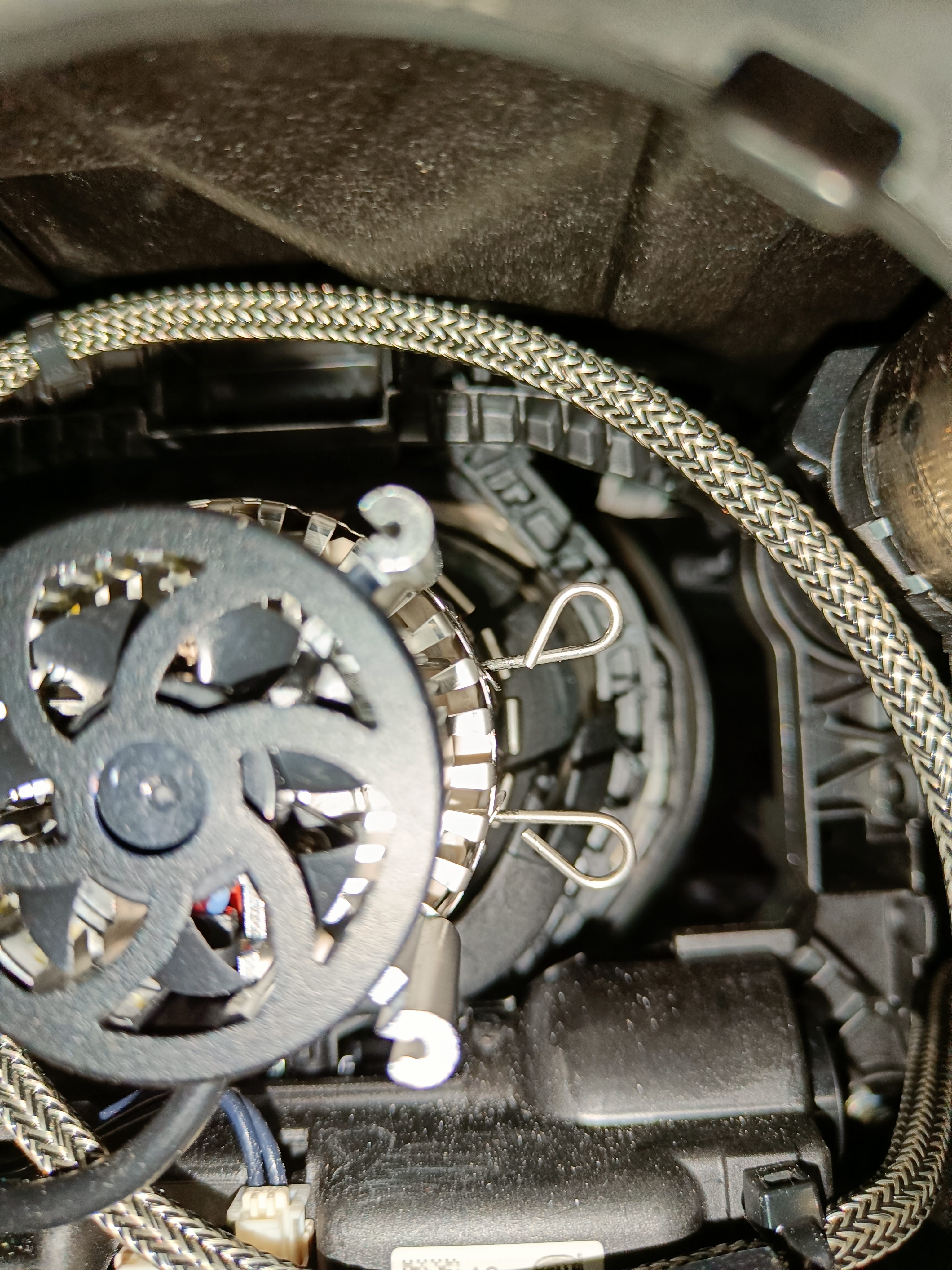

Hello, this week i have replaced my xenon light with led lights. I was  afraid in doing the switch because there is no known brand that produces these kind of lights. In the past i changed the fog lights to led and they have been working good since i replaced them 4 years ago. The brand i choose then was bevinsee  so i went to theire site and found that they made led light that replaced xenon lights and one good thing about this brand is that have a warranty of 3 years , so i decided to purchase them . I fitted them (my lamps are non sla ,  i did not remove the wheel arches but it was dificult to clip the led lights in ) . For now , i'm happy with the light they are 6000k 7000lm, they produce more light then the oem (xenarc osram d3s) below  is the link to the lights oficial webpage but i bought them from aliexpress for 55€.

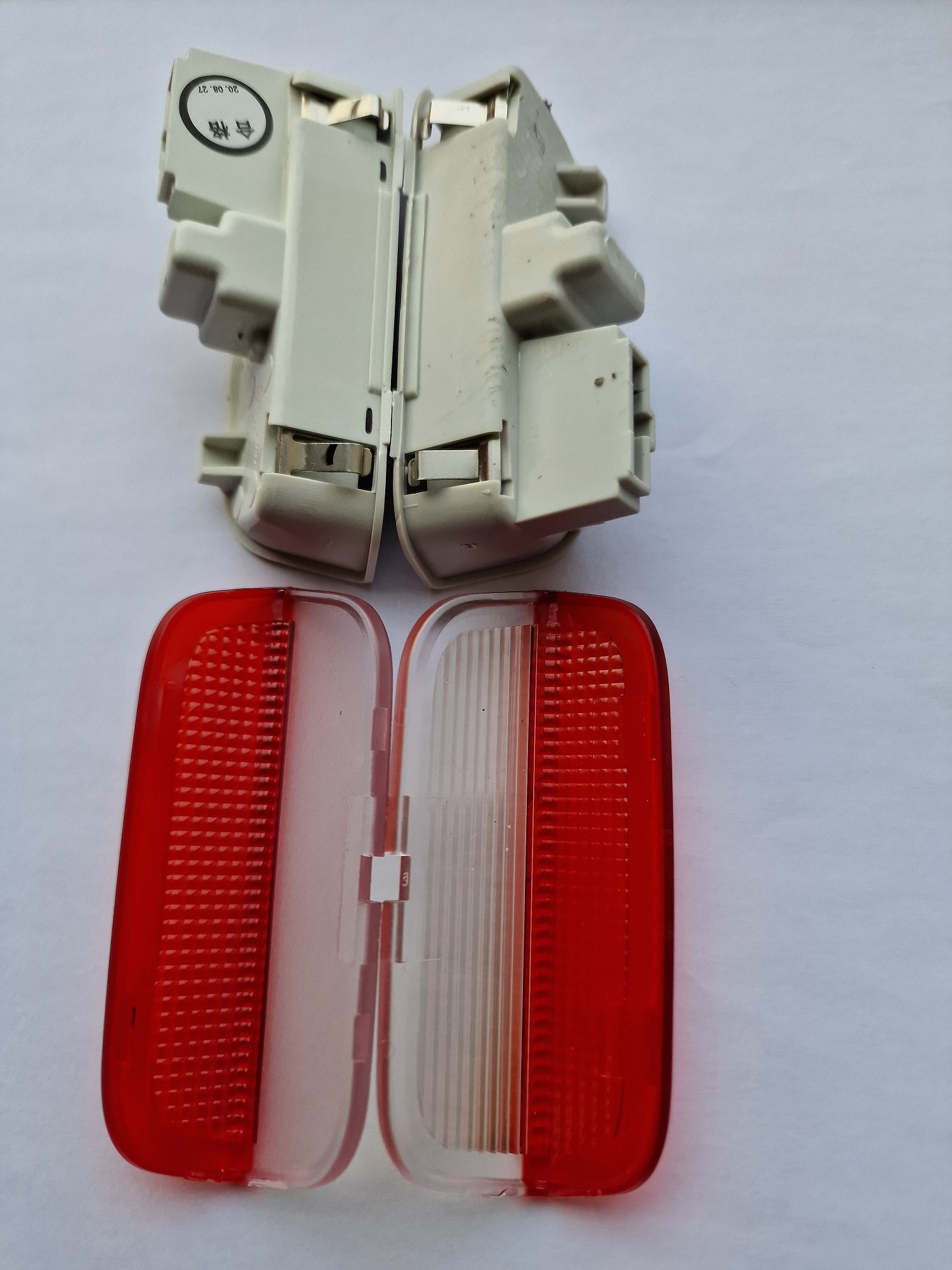

ordered this 12+6 LED version, but received 6+6 😞
last incandescent bulbs have finally been replaced
Ali's 3AD 947 411 vs OEM JBE 150 1102
Ali's 3AD 947 411
Door_Warning_Light_3AD_947_411_Ali_50p.thumb.jpg.4eb97f1633998d67ea3e5d06247c09f2.jpg
OEM JBE 150 1102, clear print as 5th VHS copy :)
due mismatching product description i asked, and got, 50% refund from Ali
 https://www.bevinsee.com/products/d3s-d3r-led-headlight-bulbs-7000lm-for-hid-xenon-lamp
When follow your link, it will warn that they don't fit : WILL NOT FIT EU 2017 Skoda Superb III
Mine is non sla and i fitted them without removin the wheel arches ,  they are cliped and working fine.
What do you mean when you say your lights are non sla? But you’re certainly brave; I hope they don’t melt your headlamp housings.
