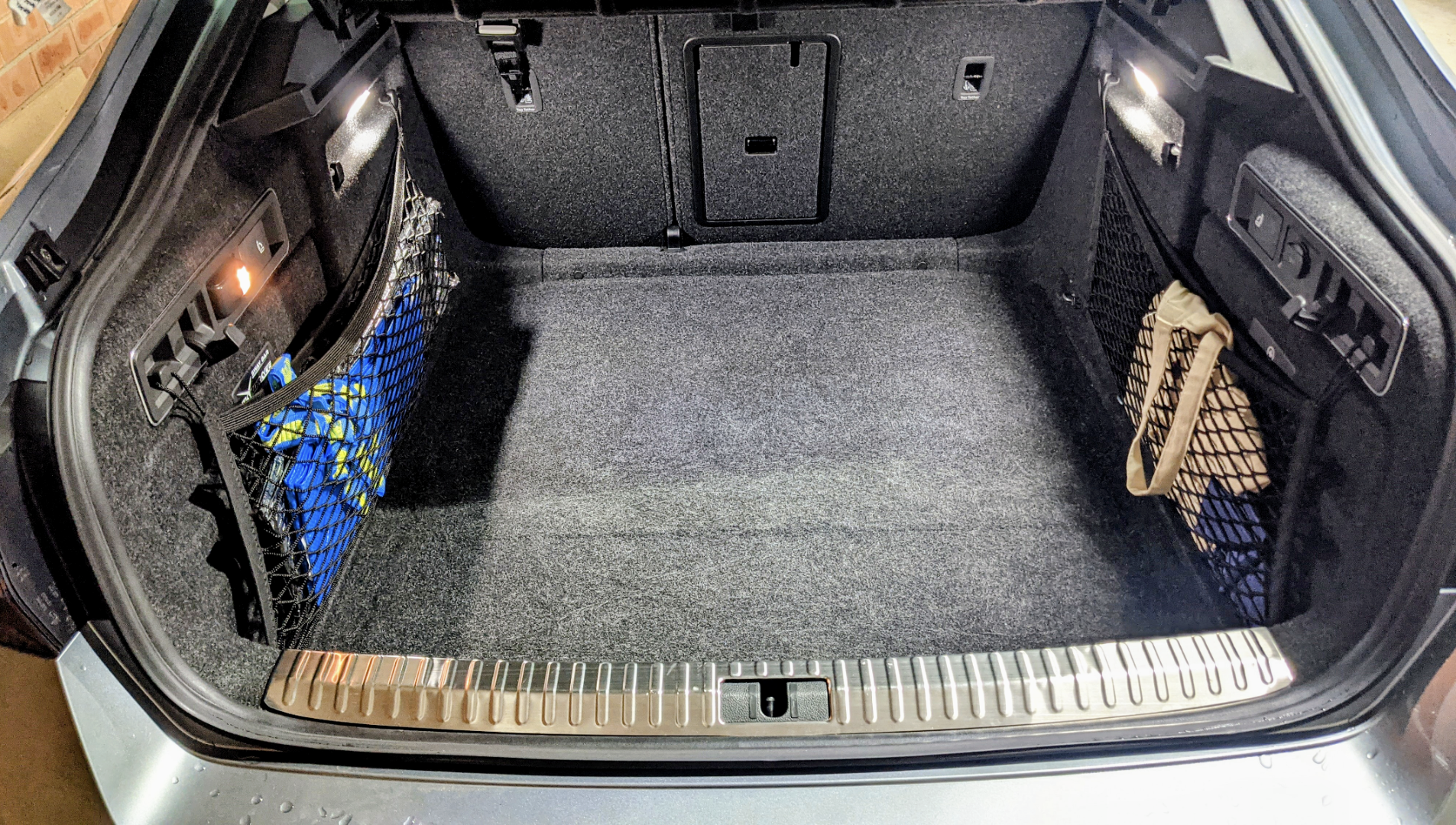

I’ve just purchased these LED units to replace the original standard units in the boot of the 280. Interestingly, they appear to be identical to the ones sold on the Kopacek website which are more than 3X the cost! They are much, much brighter and whiter than the OE units, even when I’d replaced the original W5W bulbs to LED’s; they were a pain to get them aligned properly too. The units are a bit tighter to get them in place than the OE holders and this is due to the case being slightly deeper but that’s no bad thing.
Customer service was excellent too as I stupidly purchased the incorrect units originally and these were returned FOC and refunded very quickly.
Edited by numskull

2 hours ago, MartiniB said:
recommending add second pair
I like that idea, and I did buy two pairs; unfortunately the link no longer works. 😟 The same units are available at a cheaper price from China, but I didn’t want to wait for 4-10 weeks for them to arrive one hopes - I’ve had many items never arrived from China - then having the possibility of being hit with import duty too.
Fortunately, the ones I’ve posted about arrived in just two days.  👍🏻
PS - do you have the link to your hatchback light mod walkthrough?
Edited by numskull
Powered from closing button
Thanks. So the power cuts off when the tailgate closes? How did you cut the holes in the cover?
@numskull
1. yes, turns off when closed.
2. can't say for sure, i gave Ali bulbs to dealer, visit were connected to MOT.
my guess, strong knife must be enough

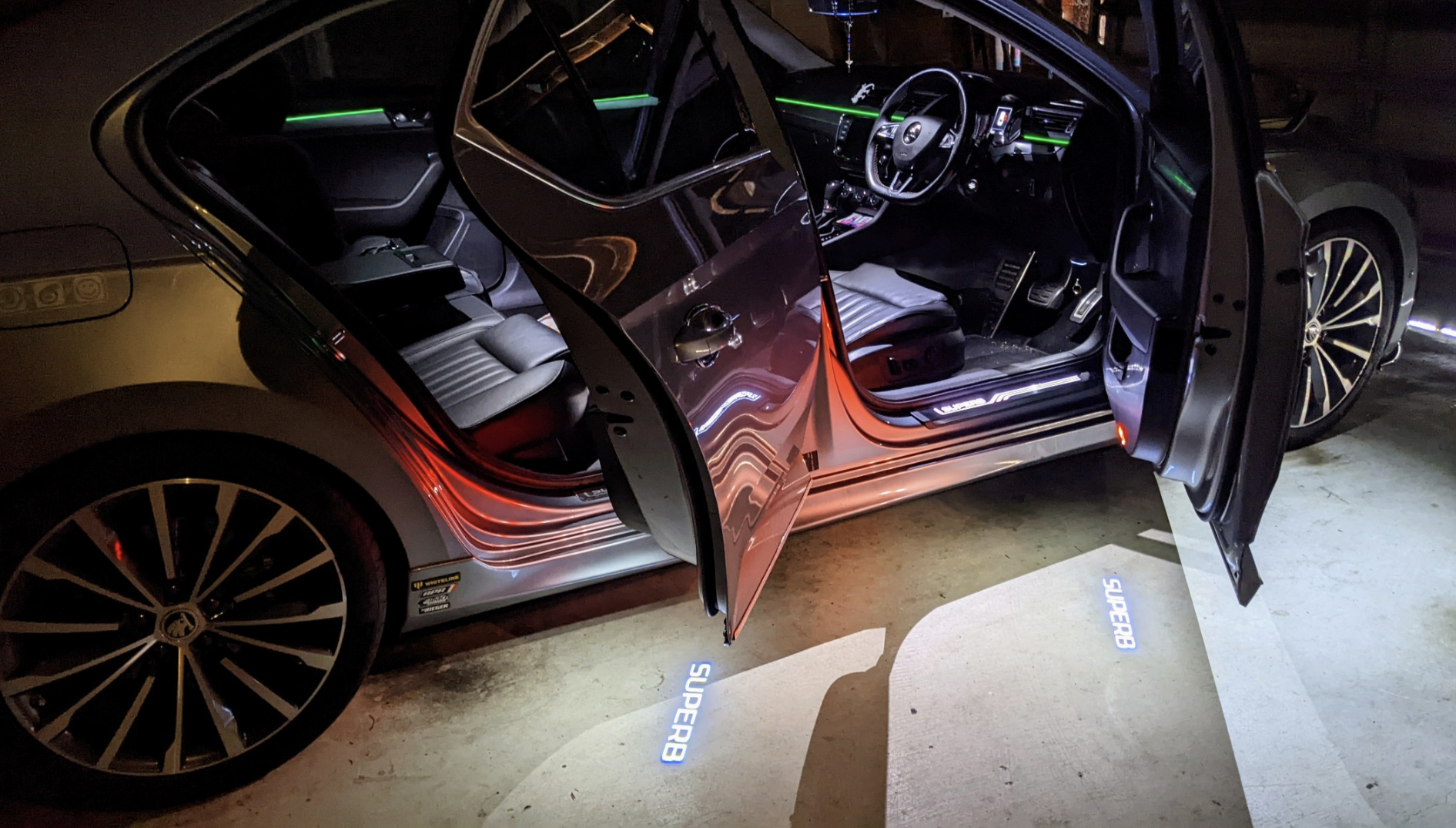

Hi,
I've this kind of lights for front doors on my L&K Mk3.
It's a gift from a friend who had a Sportline (he ordered 4 items on Aliexpress but noticed he could have bought only 2 upon installation, since Sportline doesn't any lights on rear doors).
Thus I don't have any idea where he bought them unfortunately.
Could anyone share me link to find similar ones for my rear doors?
I'd be also OK for door lights without any logo as long as they are dual color (white LEDs for floor / red LEDS for safety and horizontal back lighting).
Thanks for your help ;) !
Did u retrofit rear door warning lights on urs?
None of the Superbs come with rear door warning lights - they just have dummy reflectors.
I had to retrofit the rear door lights in mine.
