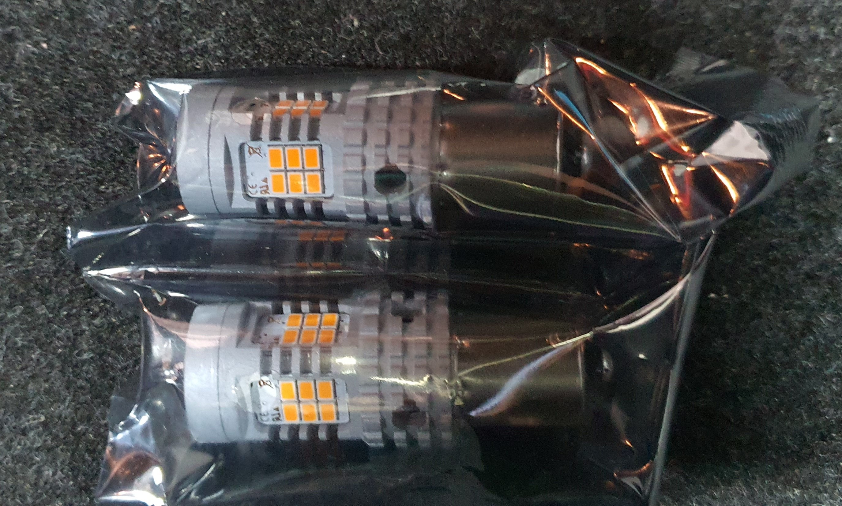

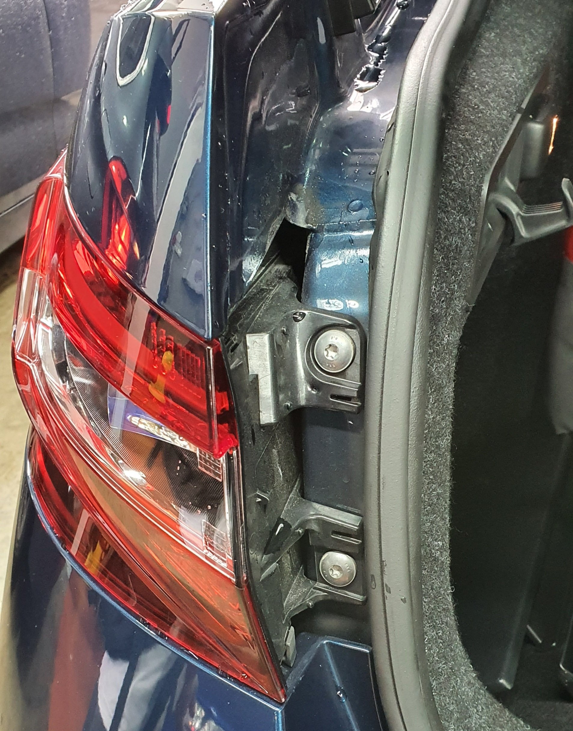

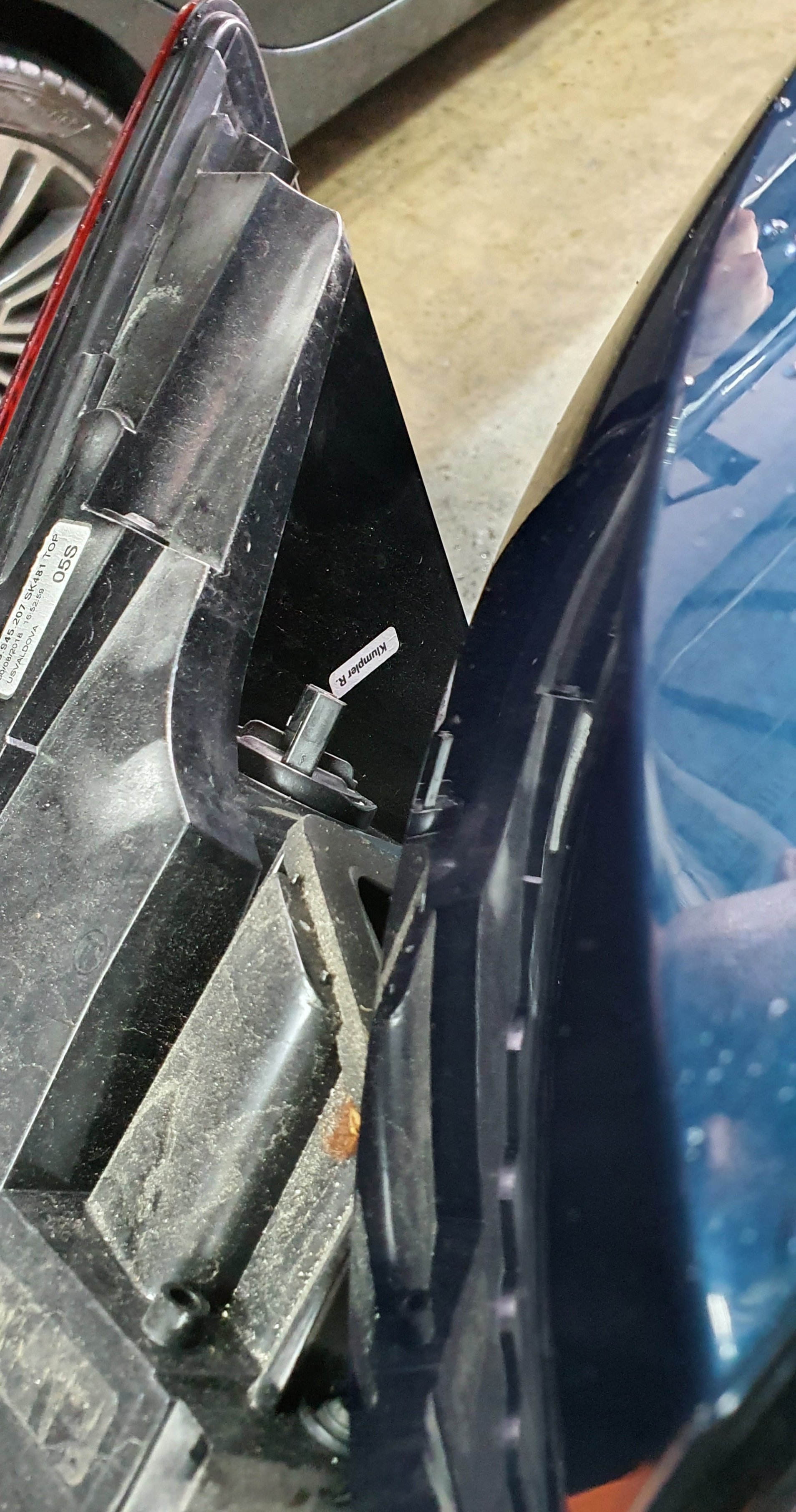

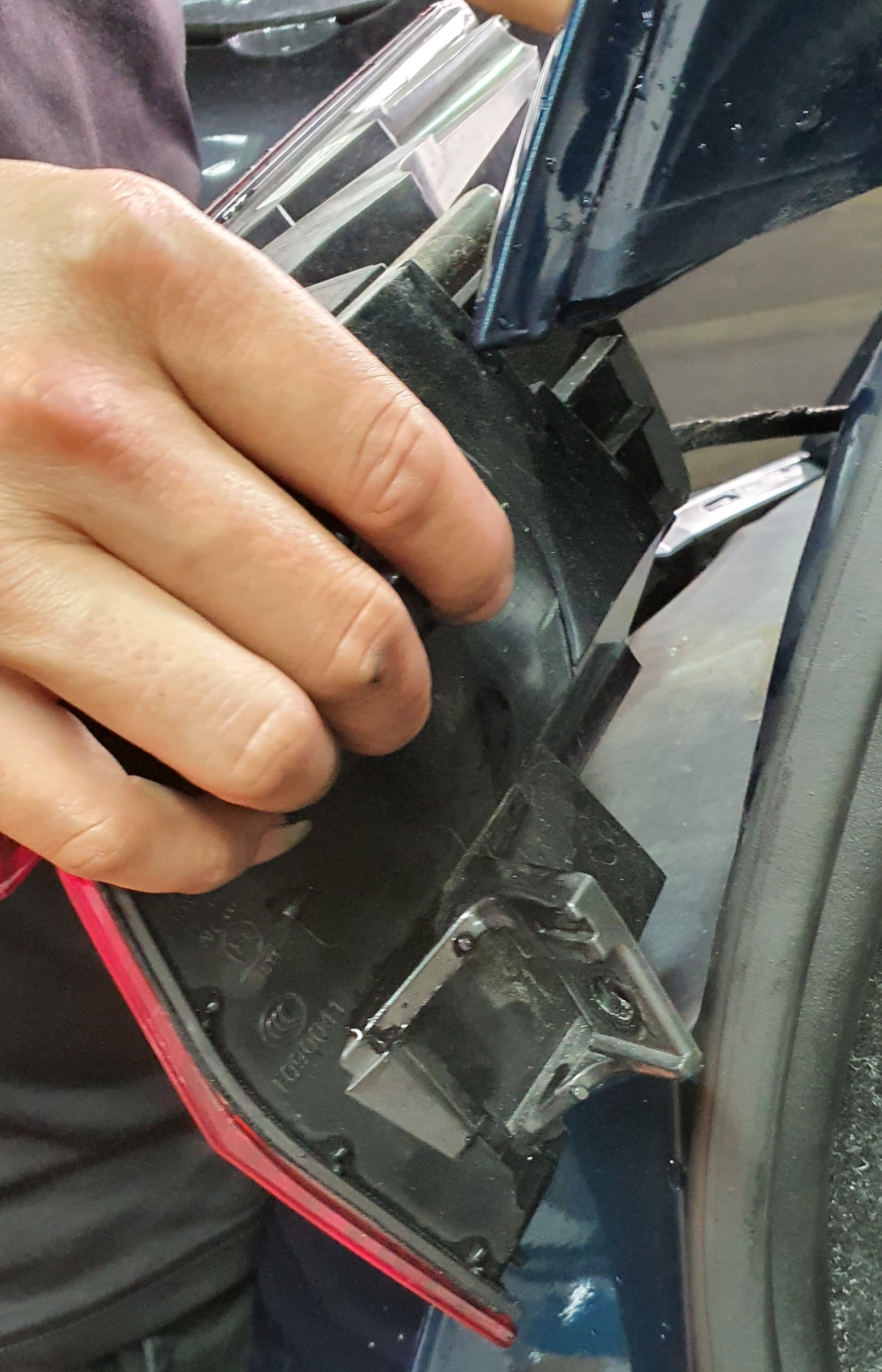

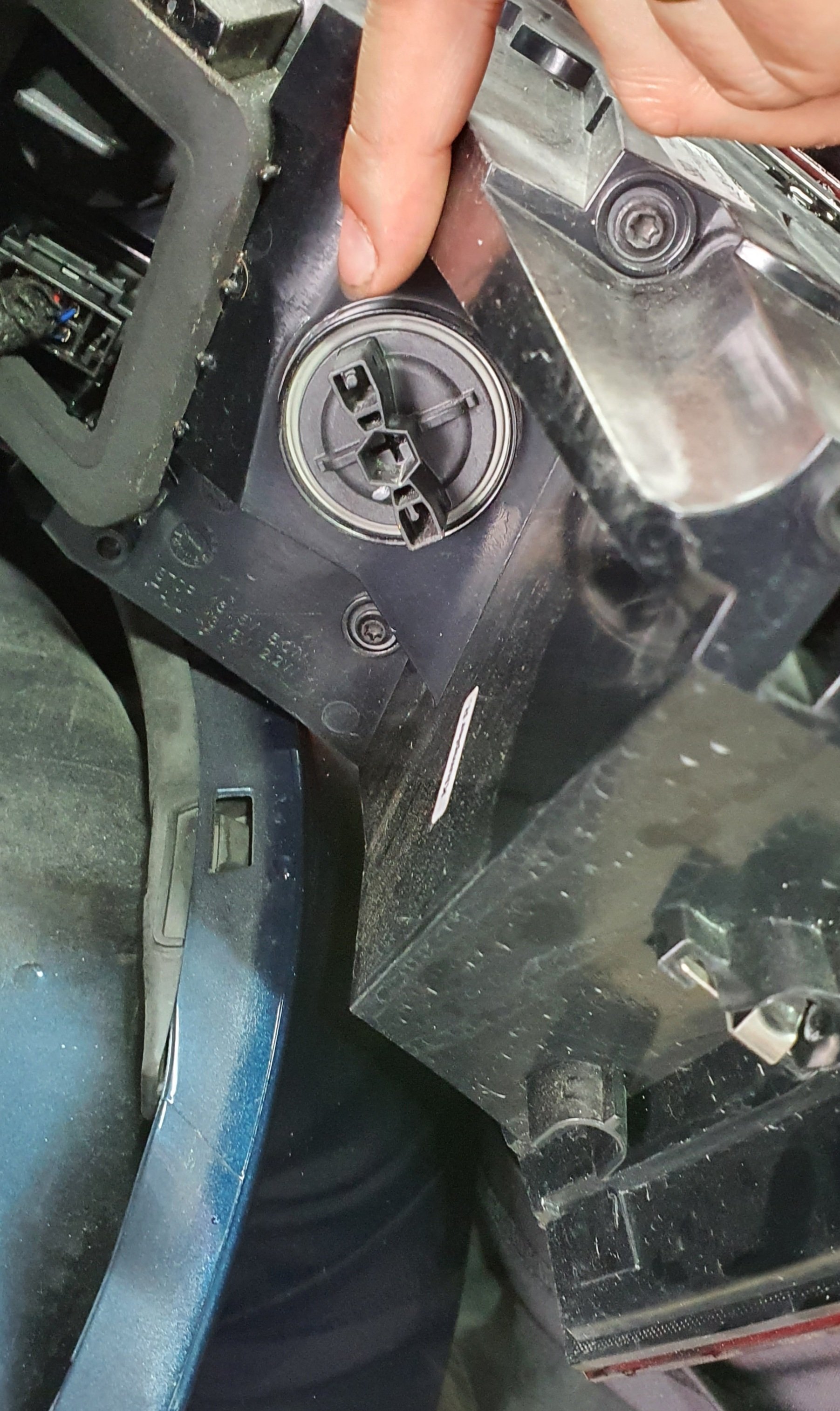

Thanks to @JR RS I got the right item Ali Express for the rear tail light LED indicators. Didn't realise it was so easy to fix, it was less than 10minutes. Will take video later on to show just how bright and better it looks compared to stock bulb.
No error codes, no hyper flash. Just plug and play. happy with the purchase.
Edited by mcdaniels
Will take another video at night time to see the compassion to day time.
My 21 car doesn't have those silver panels in the lights and output from both the indicators and reversing lights is impressive.
