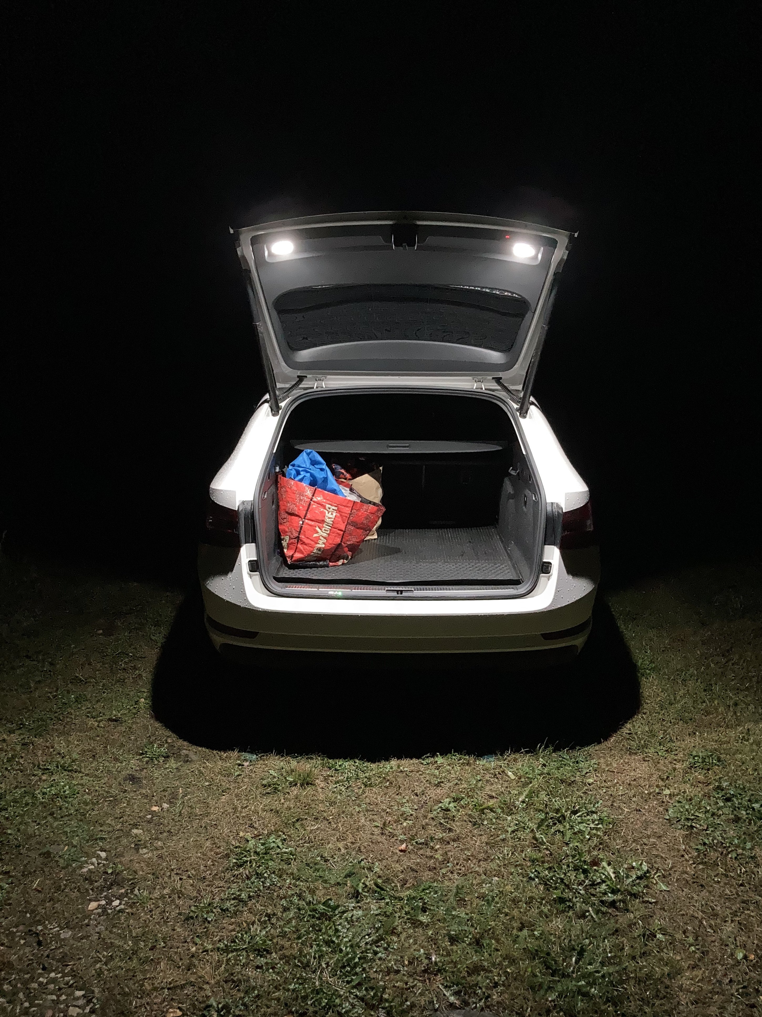

  • Boot lights   (no std photo)   Fitted with W5W LED’s from eBay (the flat 4x LED ones in the middle)         Now whilst these were a big improvement over std they were not as good as they

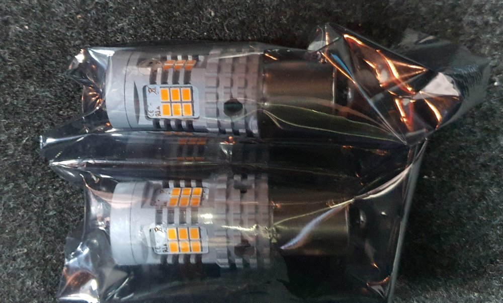

  • Rear indicators   PY21W    Philips X-treme Vision http://www.powerbulbs.com/product/xtreme-vision-py21   OE on the left LED on the right:

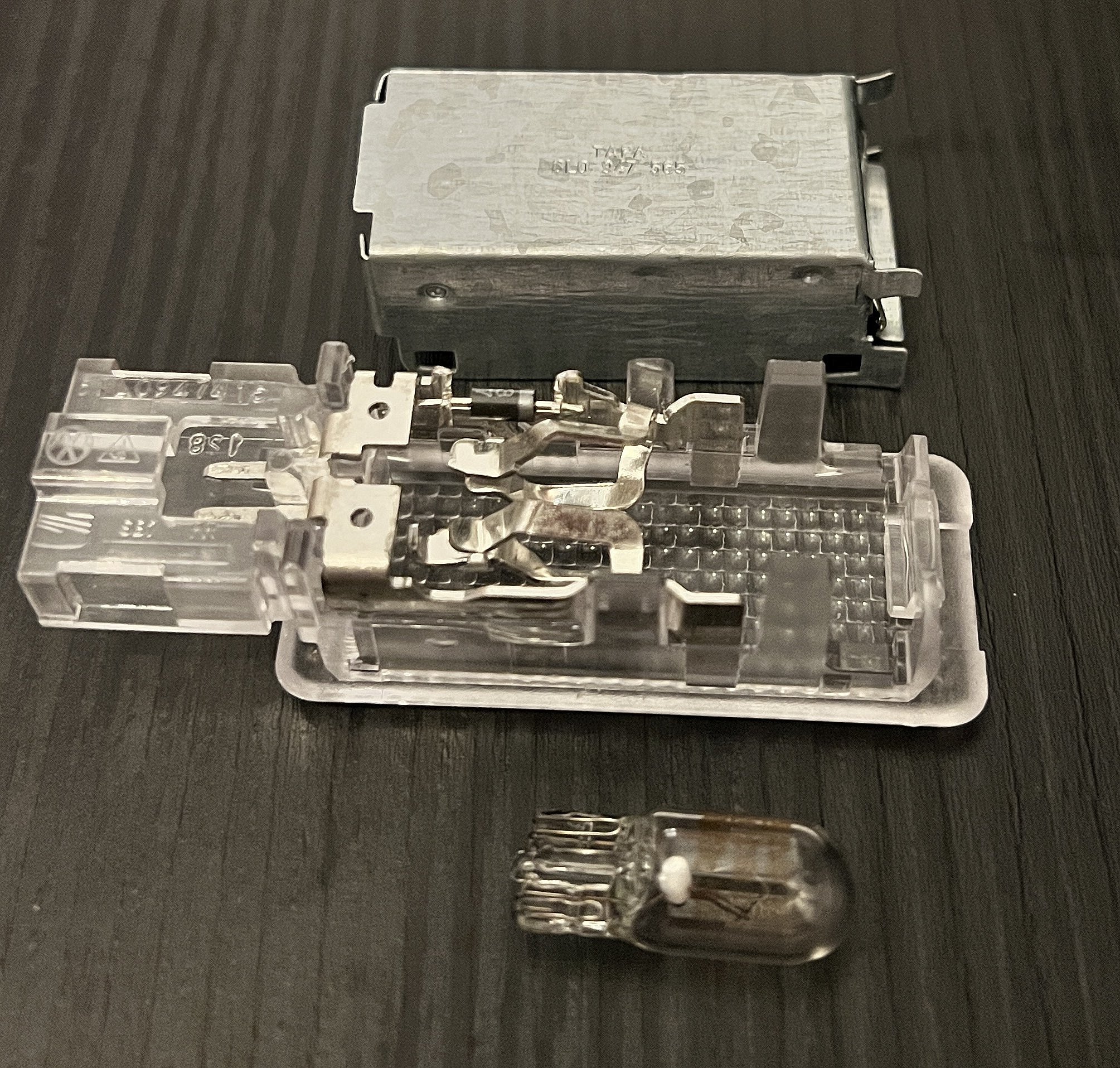

I removed the tailgate light to see what light bulb was inside to replace it with white LED.
Inside was ordinary halogen W5W E1 2GL bulb.
So, what bright white LED bulb do you recommend ?
Do I understand correctly that the LED socket must be T10 to replace W5W ?

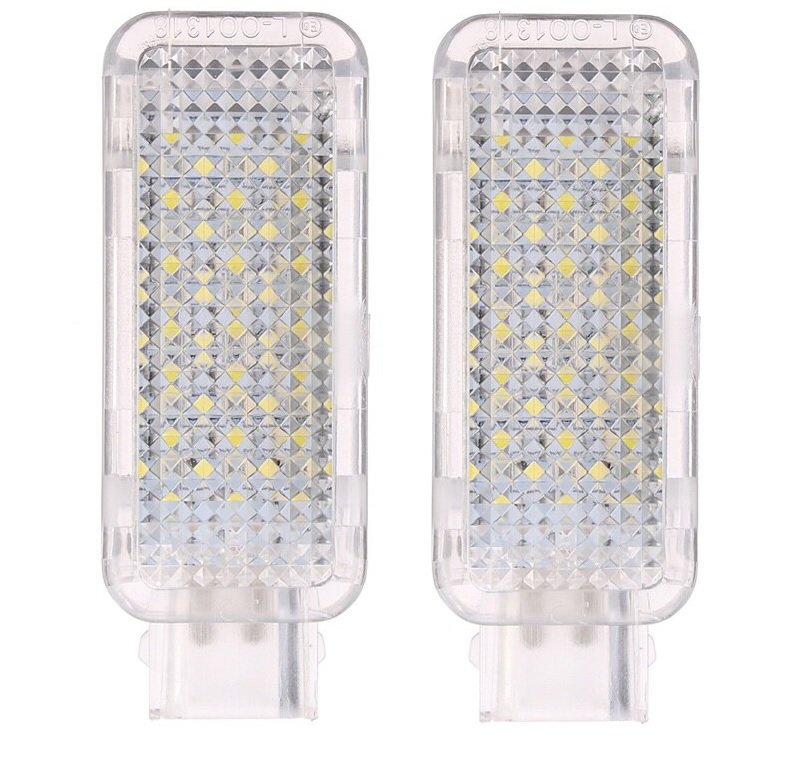

On 06/10/2022 at 06:41, superbuser35 said:
Recently changed yellow bulbs to white LED.
Bought here: https://www.aliexpress.com/item/1005003157234648.html?spm=a2g0o.order_list.0.0.dee71802Br4NIy
Really easy installation and the result is nicely bright.
Is this just for the boot door lights only? Also what’s the deal with the wiring harness supplied, is it car loom plugs into that then the supplied wiring into the lights?
No, it's the same ones for all four foot wells. At least...
