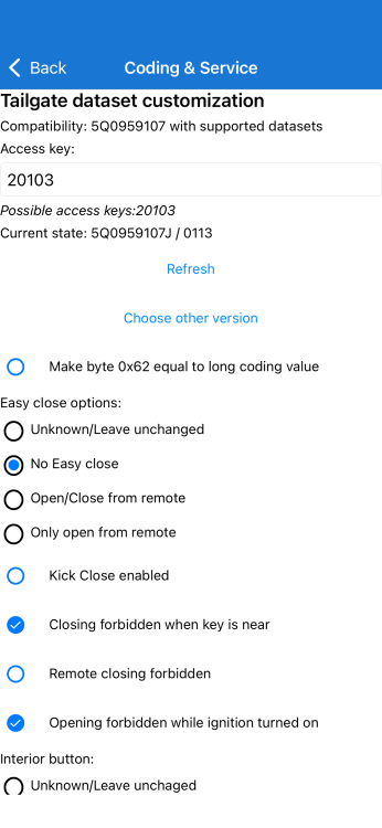

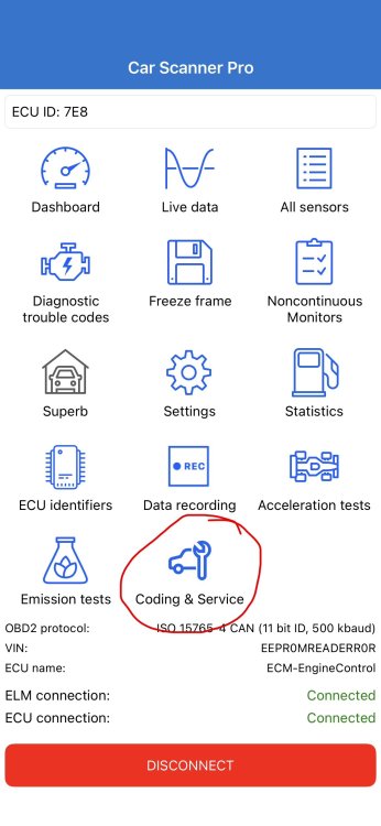

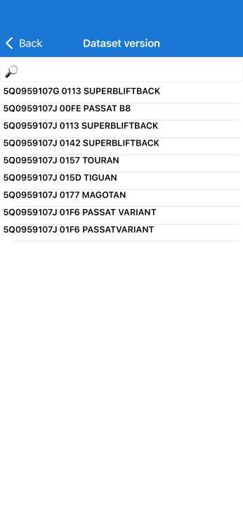

Car scanner can be a bit hit and miss. I would advise that you go to the “use user defined bytes” at the bottom of the settings screen detailed below and take a screen shot or write them down so that you can revert to current settings if something goes wrong. I’m not certain that it will definitely get you back to where you are but hopefully so!

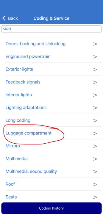

Select coding and service
Then luggage compartment

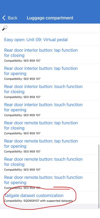

Then scroll to the bottom and choose tailgate dataset customisationIMG_0611.jpeg

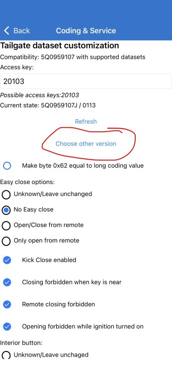

Then click on choose other and select one of the superbliftback ones.

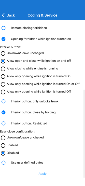

Then set the parameters you want and choose apply. (The open/close from remote should be selected and kick close for you)
You may need different settings if you have kessy or virtual pedal.
I have seen on another page that you have to hard reset through the long coding options for it to apply but it worked fine for me without this.
Easly done with carscanner, didn't had to choose other dataset version, just changed interior button option to allow open and close while ignition on and off. Closing with button pressed, opening tap button
