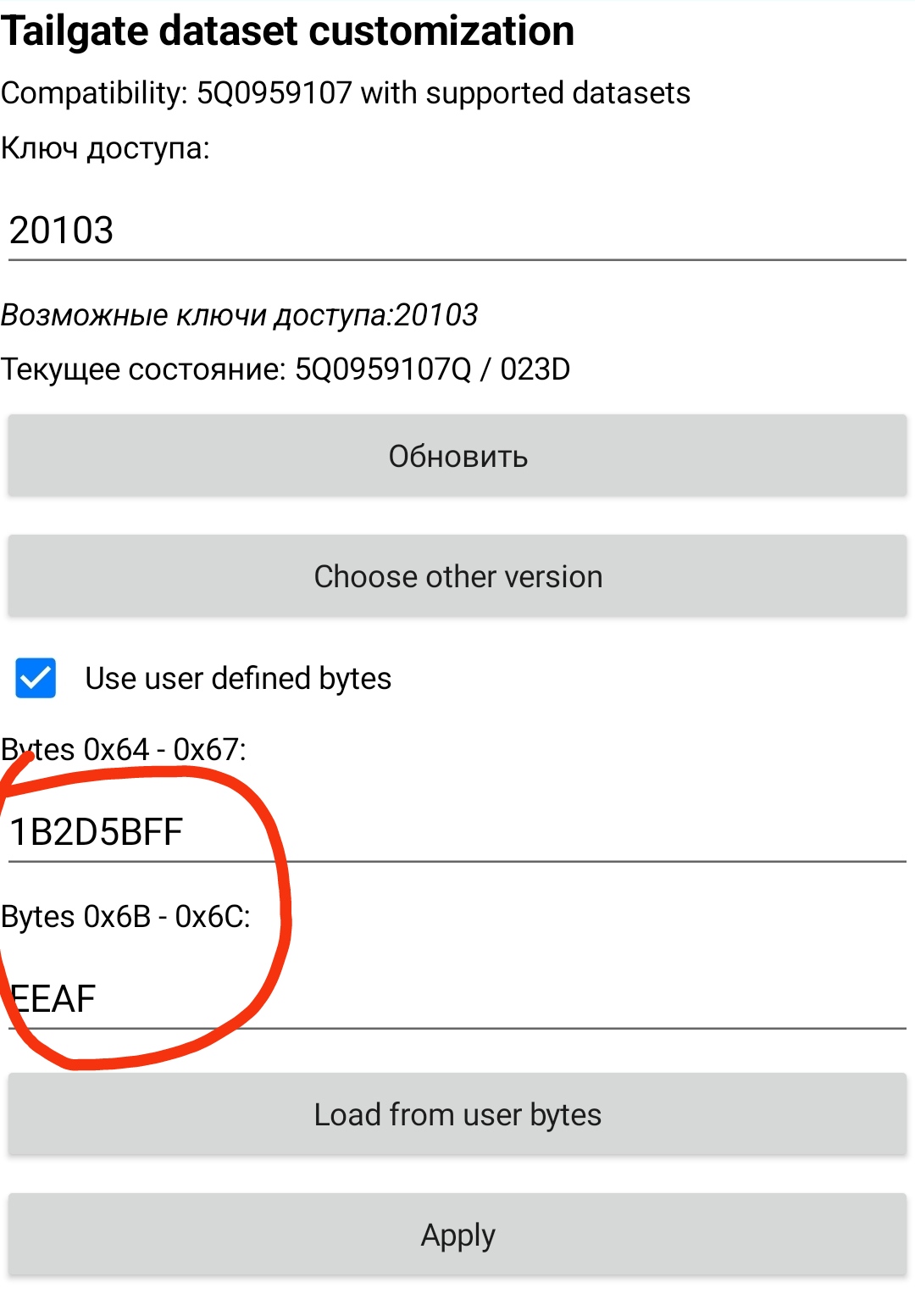

On 04/06/2023 at 20:39, igrozan said:
Car Skanner has an option for trunk parameters. Now everyone can set the trunk closing from the button in the cabin using the phone and obd. If I haven't tried it. You do everything at your own peril and risk
Have clicked this CarScanner function today and wanted to enable closing tailgate from interior and remote button on module 5Q0959107P [software version 0266, Superb from 2019, no kessy]. Now interior button only unlocks tailgate (its not going up like it used to earlier). But closing with remote when ignition is off works by keeping remote pressed till its closed (it hasnt earlier). Reversing module dataset from backup doesnt help.
Noticed that this function doesnt save option which user changes. Even though I clicked "Apply" and get confirmation that data was accepted it gets back to start after clicking "Refresh".
How can I now make tailgate to open by clicking interior button? Is there a possibility to reset module 6D to factory default? Or type the right coding in anywhere? There is option to include user parameters at the end of this function. Could anyone help me please? I can paste whole current  coding/parametrization of this module.
Edited by msemafor

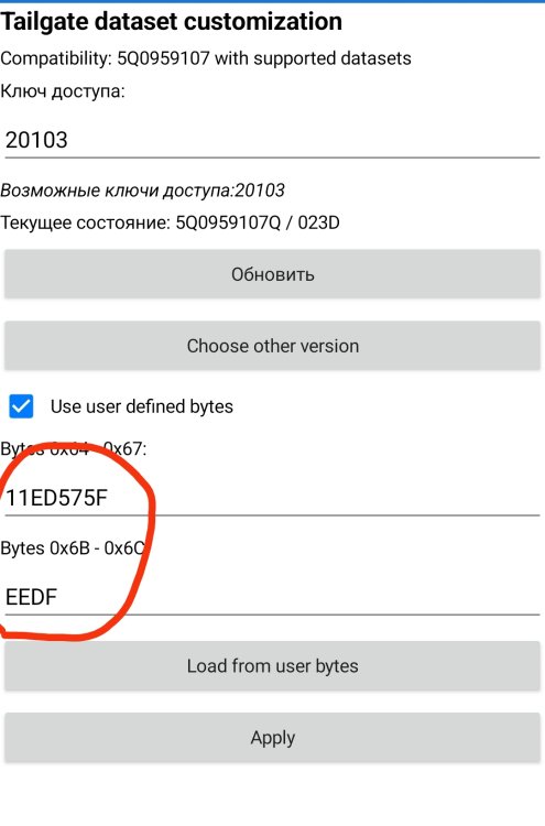

Hello. I'll go to the garage and take a look. everything should be simple.
And so, I don't have parameter 0266, but you can try this: my original file, as it was from the factory IMG_20230816_092856.thumb.jpg.2ed98e40cf43c8a8ece957888cce6cb2.jpgIMG_20230816_092935.thumb.jpg.bbbeb4f37c07776fef88fb1045ebdaba.jpg
my modified parameters
post what happened

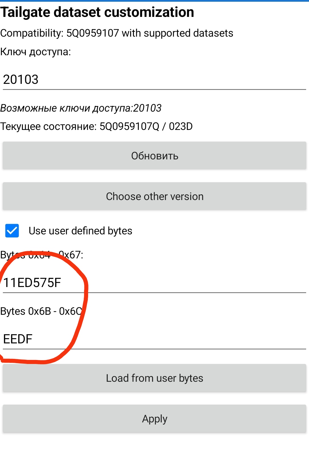

8 hours ago, igrozan said:
post what happened

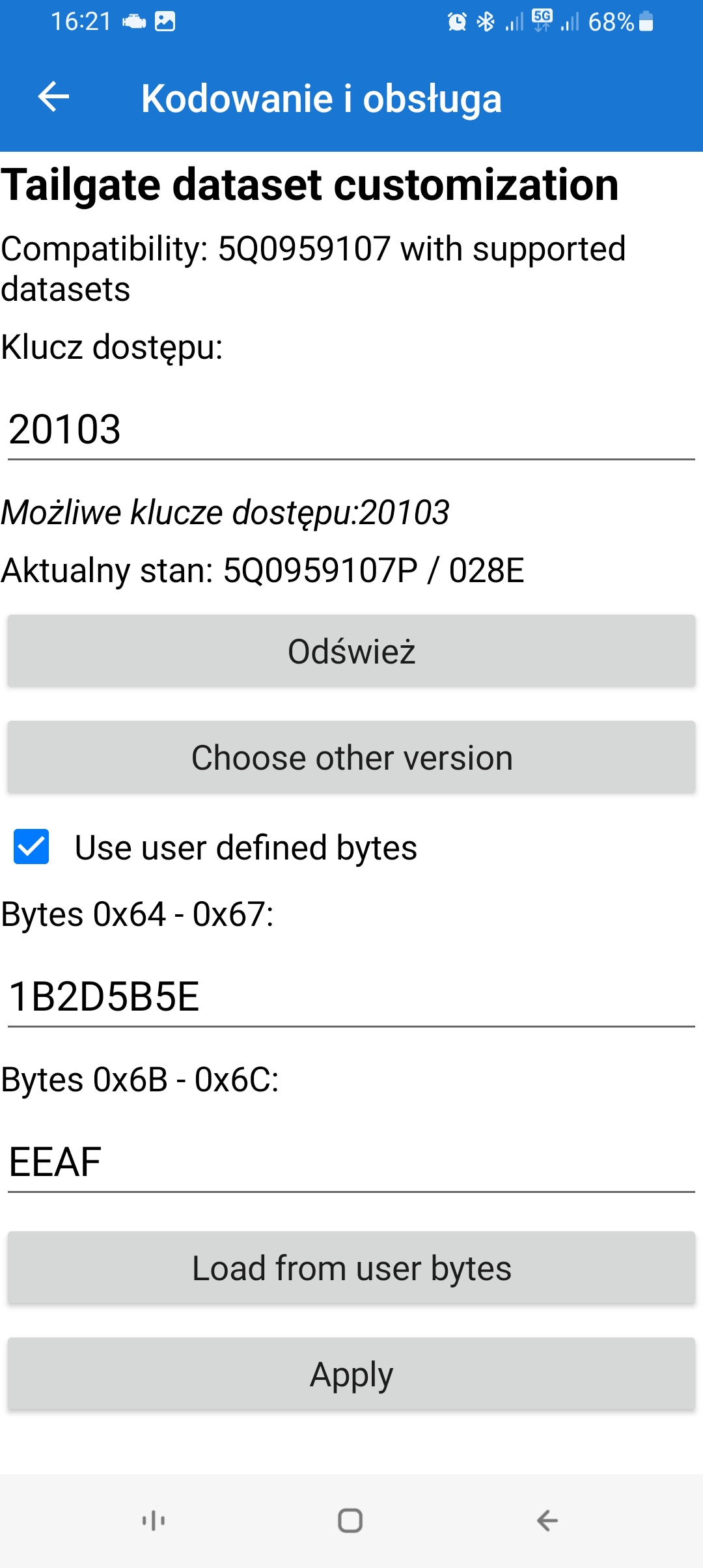

Thanks @igrozan for your informations.
Have no idea how I did it but now my tailgate works like it should do. Opens and closes with interior button and remote. To close it I have to keep buttons pressed till it locks.
Today morning I clicked "Long coding" --> "Tailgate/bootlid" and clicked "Reset module" and then "Hard reset". After that my tailgate started to work as I wanted it to.
Here is what I have in this feature in CarScanner and in export ECU info to text.

You have version 028E, I have this parameter. It's good that everything works.
I'm not sure about which version I have. It's shown by default when I click this option but I can change it  and after it different version will be shown by default - there is also 0285 version which might be newer software symbol. Of course I'm glad taigate works fine and as I wanted it to. Won't be playing with this anymore.

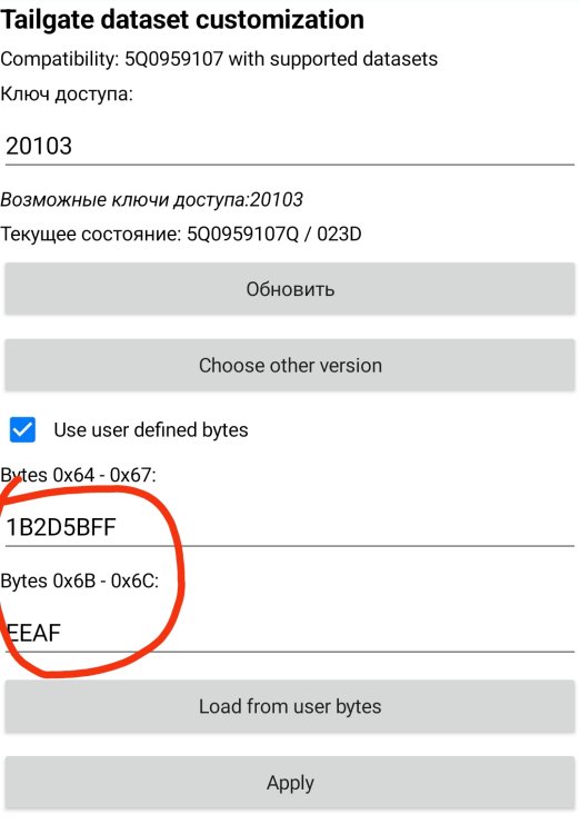

Hello.  I have 5Q0959107S, I can leave it 1B2D5BFF or better at 1B2D5B5E.  Which is better for me, I don't have a virtual pedal but I do have keyless and remote access.  Could you explain the difference to me?  It is for a superb 3v 2020
17.09.2023 в 03:55, Иисус98 сказал:
Привет. У меня 5Q0959107S, я могу оставить его 1B2D5BFF или лучше 1B2D5B5E. Что для меня лучше: у меня нет виртуальной педали, но есть доступ без ключа и удаленный доступ. Не могли бы вы объяснить мне разницу? Это для превосходного 3v 2020 года.
If you don’t have any options, but you set them, it doesn’t change anything
Edited by igrozan

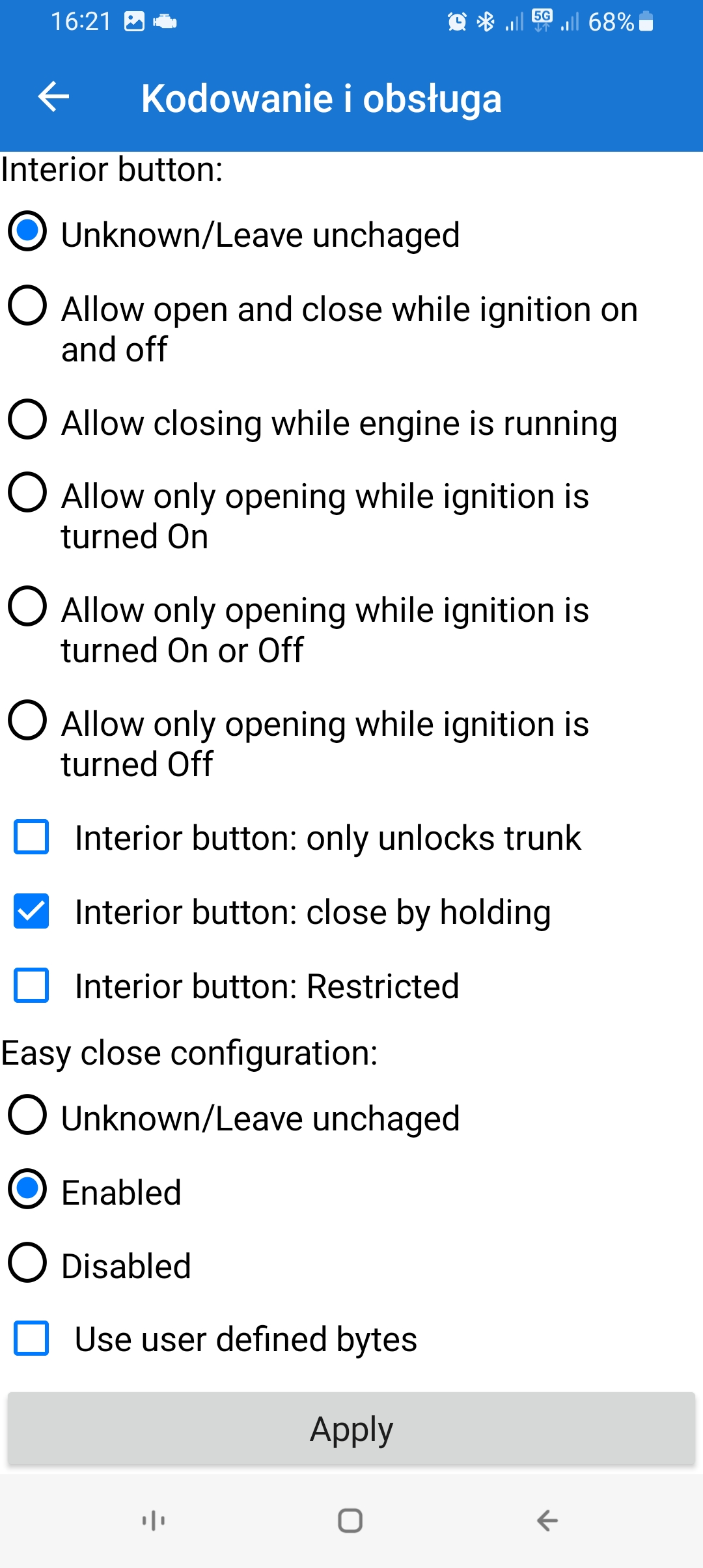

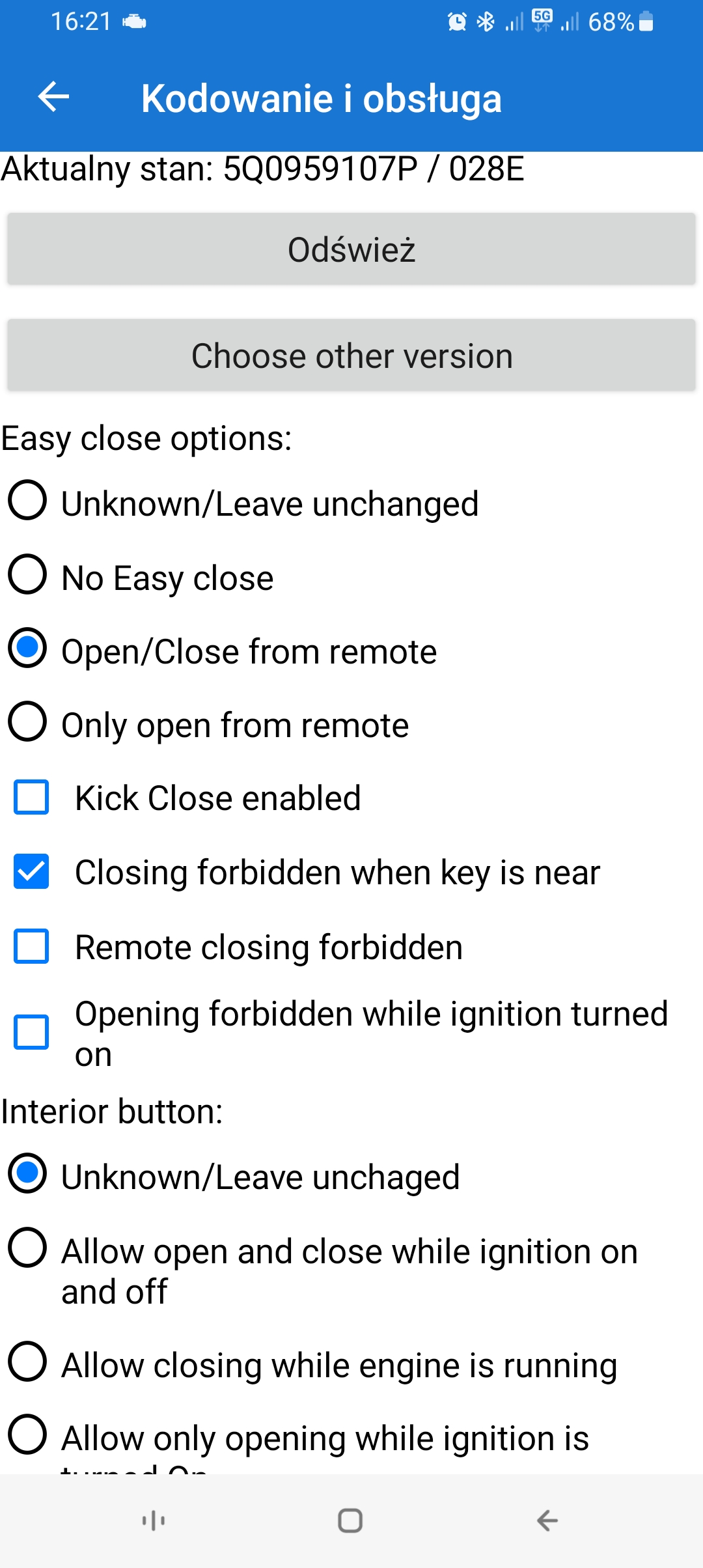

My app is in polish so I'm not sure what names of functionalities are in english version but will try to translate.
After connecting to your car you need to choose the last icon at the bottom of the main screen called "Coding and service" or similar. Then confirm the warning and you'll see categories. There should be "Boot lid" or "Trunk" or similar. Enter there and the last option is "Tailgate dataset customization". Guess it is what you're looking for.
I needed to do a reset of this module after changing parametrization.
Remember that you're doing this on your own resposibility.

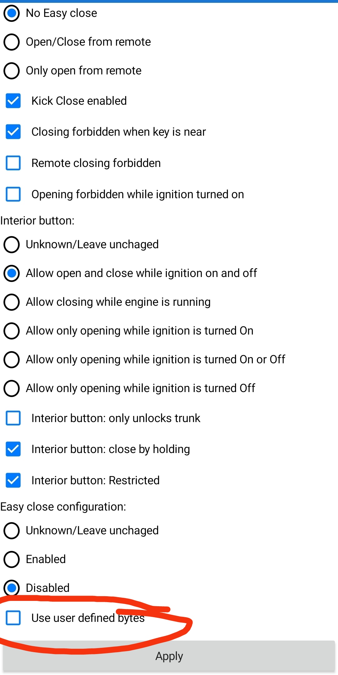

Detailed info for setting this with carscanner
I have this obd module
https://www.amazon.co.uk/dp/B06XGB4873
And a pro license for carscanner (£8)
Set the mqb profile and connect. Bonnet has to be open and ignition on. Engine off.
Select coding and service
Then luggage compartment
Then scroll to the bottom and choose tailgate dataset customisationIMG_0611.jpeg
Then click on choose other and select one of the superbliftback ones.
Then set the parameters you want and choose apply. (The open/close from remote should be selected)
You may need different settings if you have kessy or virtual pedal.
I have seen on another page that you have to hard reset through the long coding options for it to apply but it worked fine for me without this.
I have also noticed this evening that when you go back in to it it reverts to default rather than showing you your current settings.
