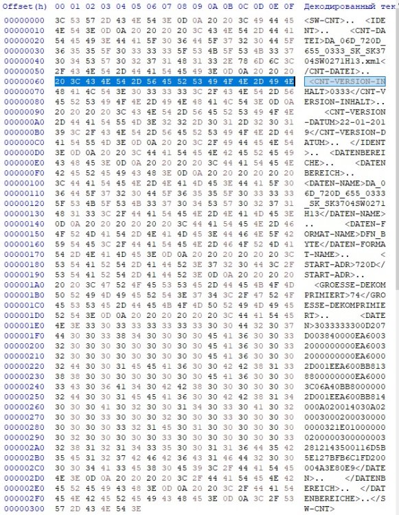

I have a parameter for a 6d block, I can try to do it for you remotely. The main thing is to be Odis

Trunk control is located in parameter file *720*. Here it is very important to know what block 6d you have and the version of the parameter. In that parameter file for 6D block *J

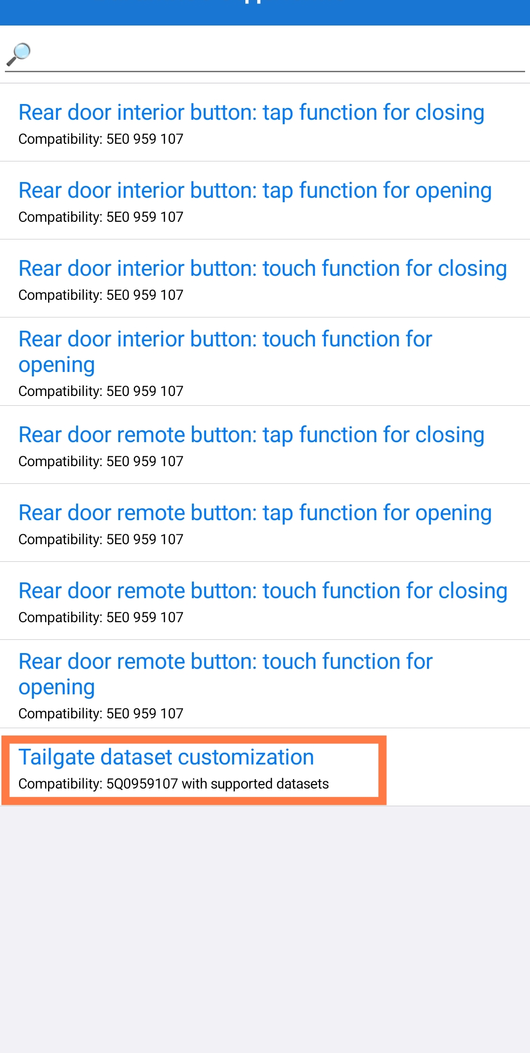

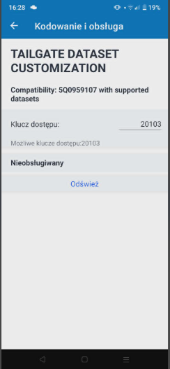

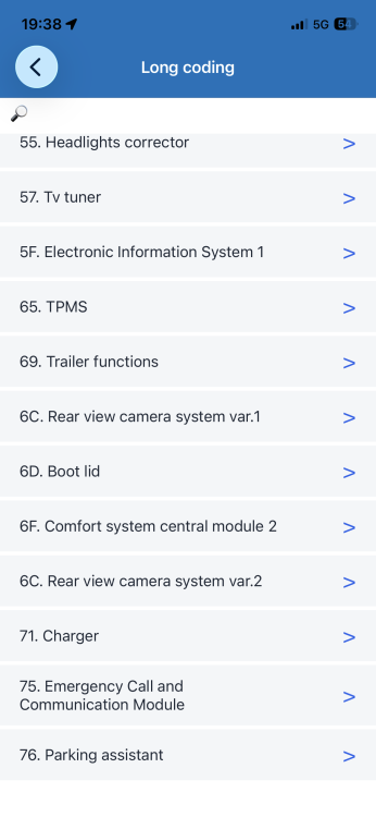

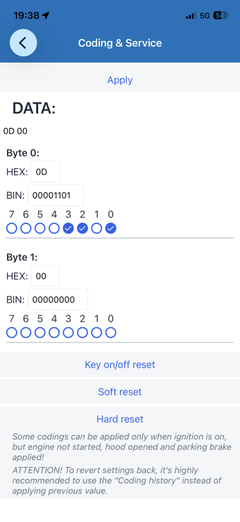

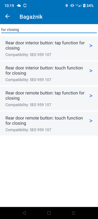

Car Skanner has an option for trunk parameters. Now everyone can set the trunk closing from the button in the cabin using the phone and obd. If I haven't tried it. You do everything at your own peril and risk
