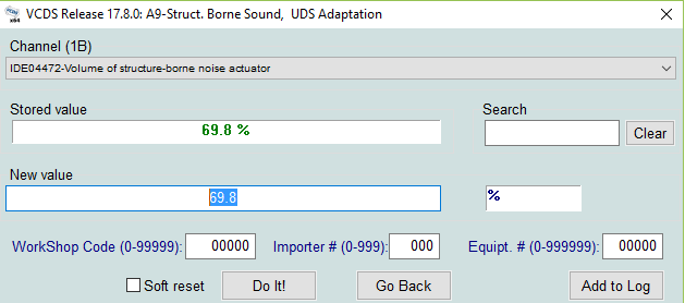

For the OP's original question....I've just plugged in VCDS and it appears you can make it louder...if like mine the default setting is 69.8%
