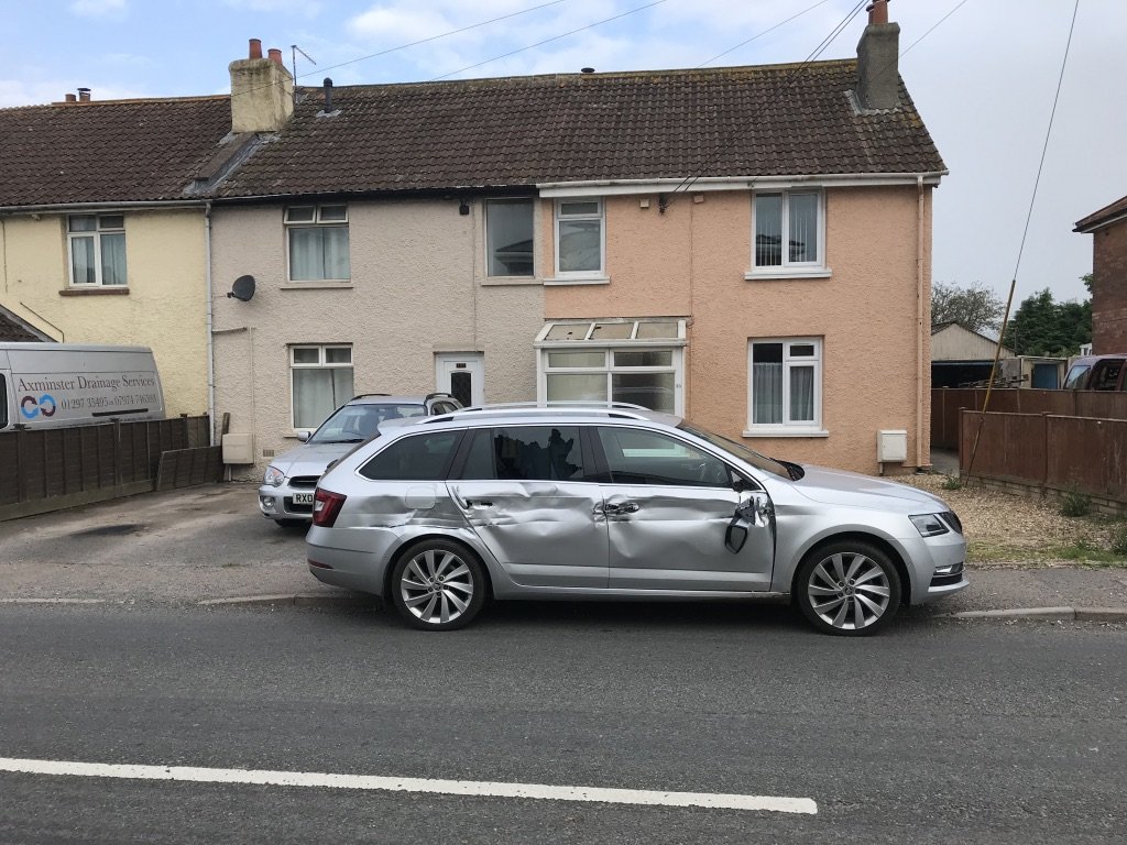

Watch the video from 45 secs for one very good reason to fit a dashcam. However, insurance company have decided the accident was my fault so battle continues. One small point, accident was June 1st and car still being repaired. Skoda seem unable to supply the off side rear door poser moulding. Would I buy another Skoda? Great car, dreadful customer service over this.
How in the name of all that's holy is that NOT
 your fault?,you drove straight into the trailer FFS.was it a surprise the big yoke used a lot of the road ?
Edited by 181ce
The initial impact point was behind the front wheel on the off side and continued down the entire side getting progressively deeper as it travelled the length of the car. In my book, his vehicle hit mine not mine hit him.
The fact remains how did you not see that was going to happen ?

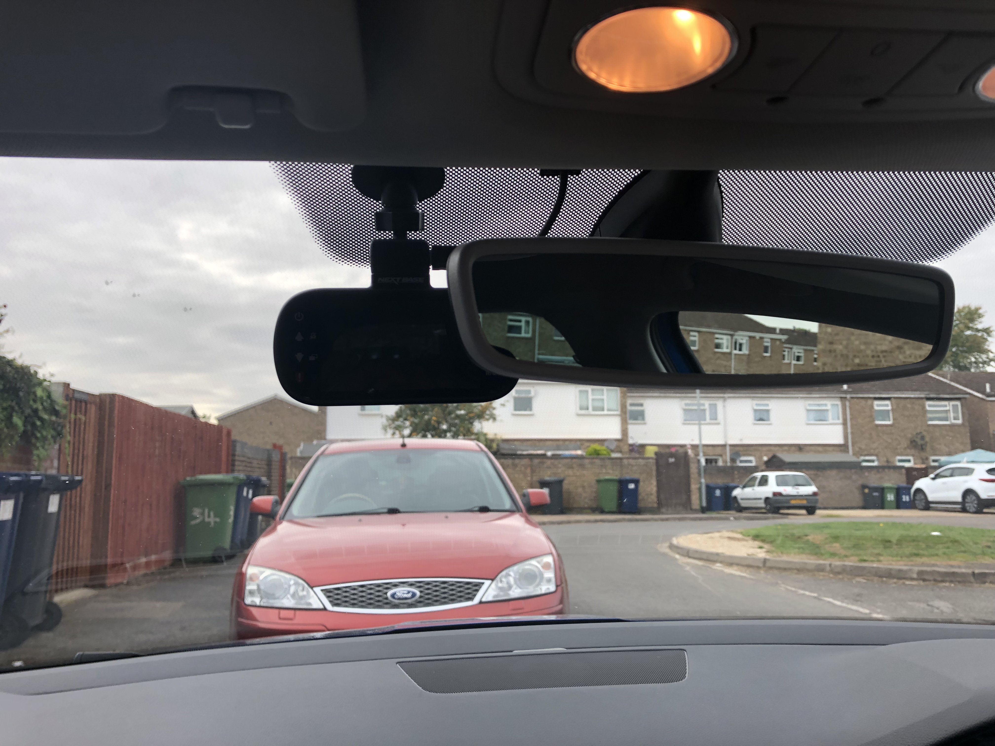

can you please post a photo of the dashcam and where is it located ? Also what model are you using?
 I am also looking to mount one and i want to make it as discreet as possible.
Is this question directed at me?
Aren't the photos already provided pretty explicit and obvious?
And it's a Blackvue DR750-2CH

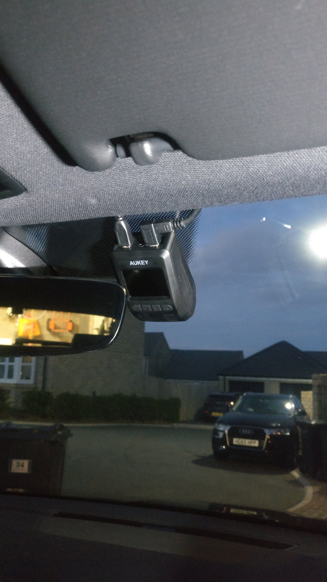

Mine is fairly discreet and i have it so screen turns off after 15 seconds or so. See pics of internal and external.  This is on a mk3 superb but im sure it would be similar in an octy
Thanks Adrian, nice looking mounting!
Thanks spiniflex, i just noticed the two photos of the camera itself, must have missed them.
Thx @trimata its a dual camera set up thats what the 2nd wire is u can see coming from top of unit. Its the Aukey DR02D if you were interested. Very good unit for £100
Is it ok to stick on the painted dot area of the windscreen? I'm using decent 3M VHB pads - just wondering if the glue will bond to the paint with all the heat from the sun.

Yes dotted area is purely as a bit of a sunshade by the rearview mirror, i initially wanted it on the passenger side as i had a similar dashcam on my octy which was mounted the same way.  I couldnt mount it on that side due to a sensor behind it for the auto dimming on the passenger side.
I had it on my octy for 4yrs or more and never had an issue with it.

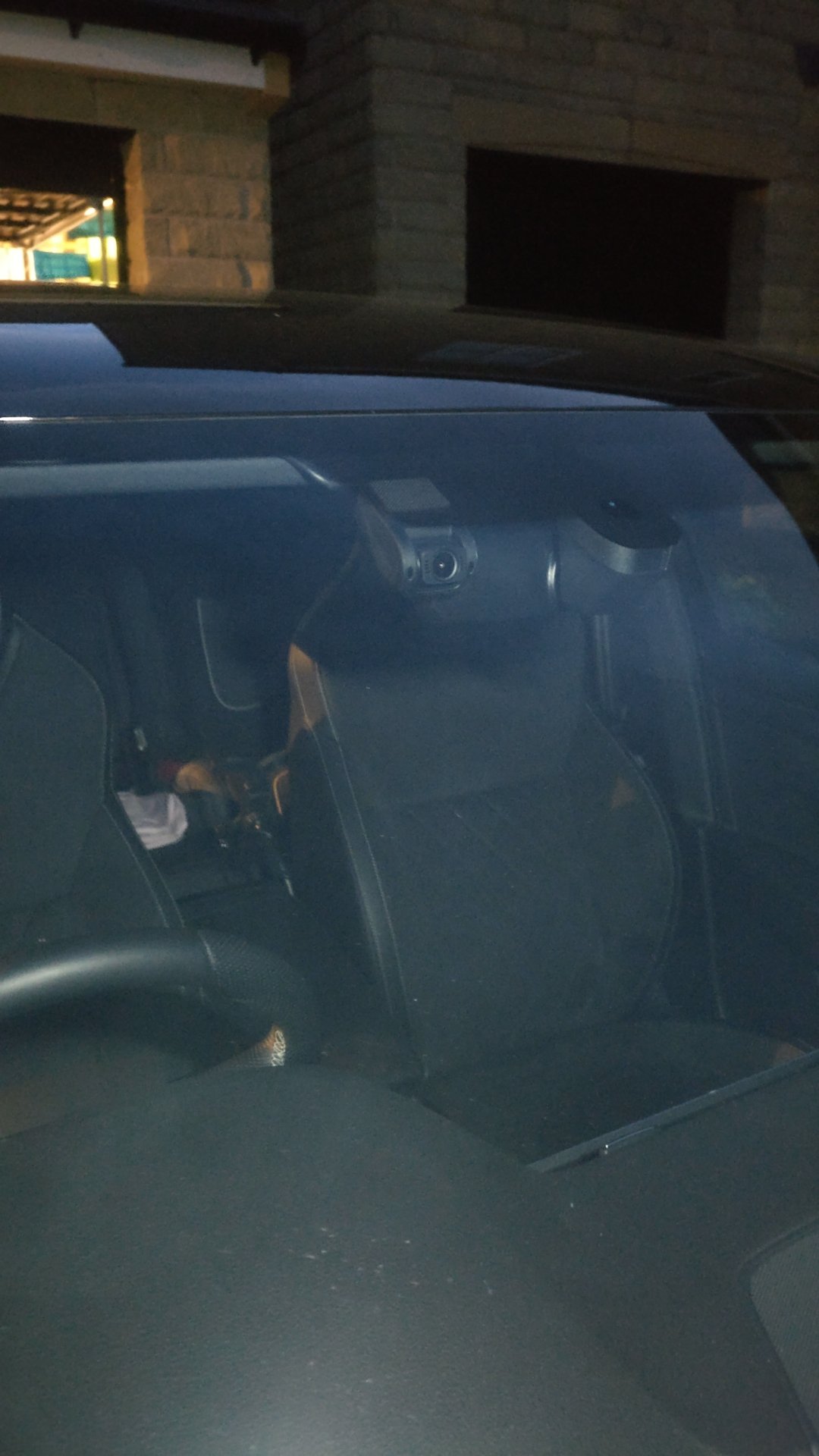

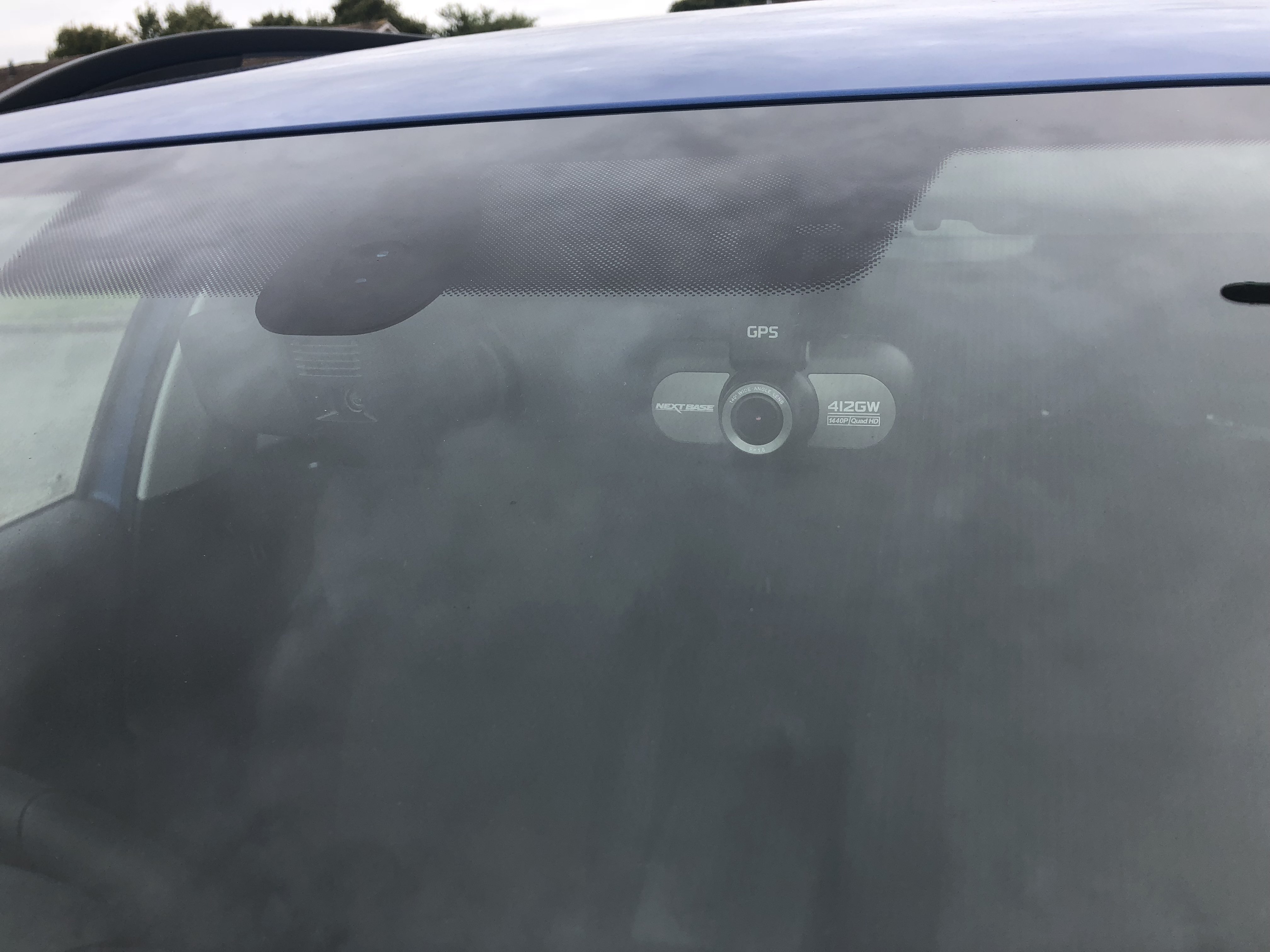

Fitted mine and hard wired it in the other day fitted it higher up using the sticky mound as opposed to the suction cup one. Nextbase 412GW

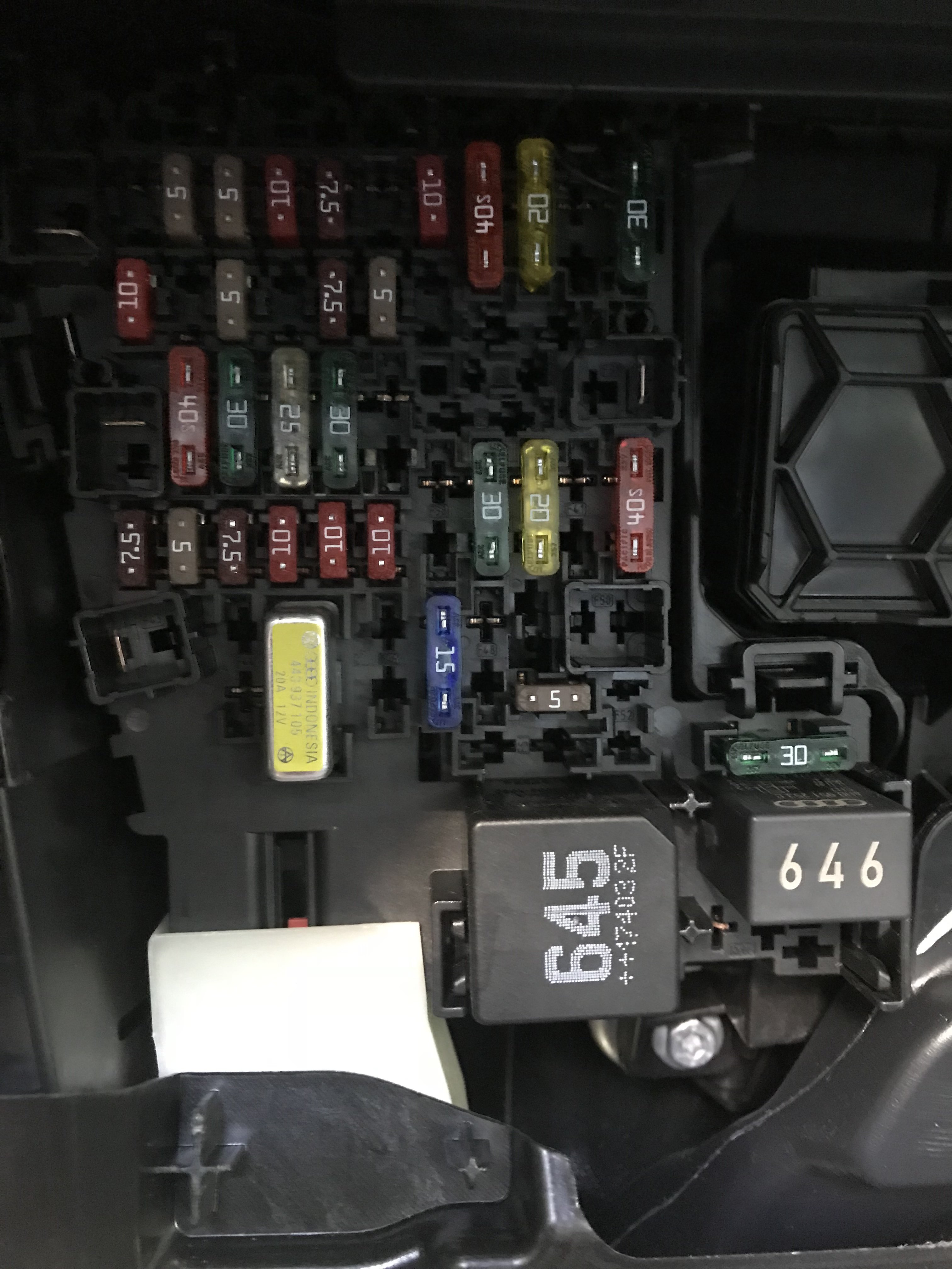

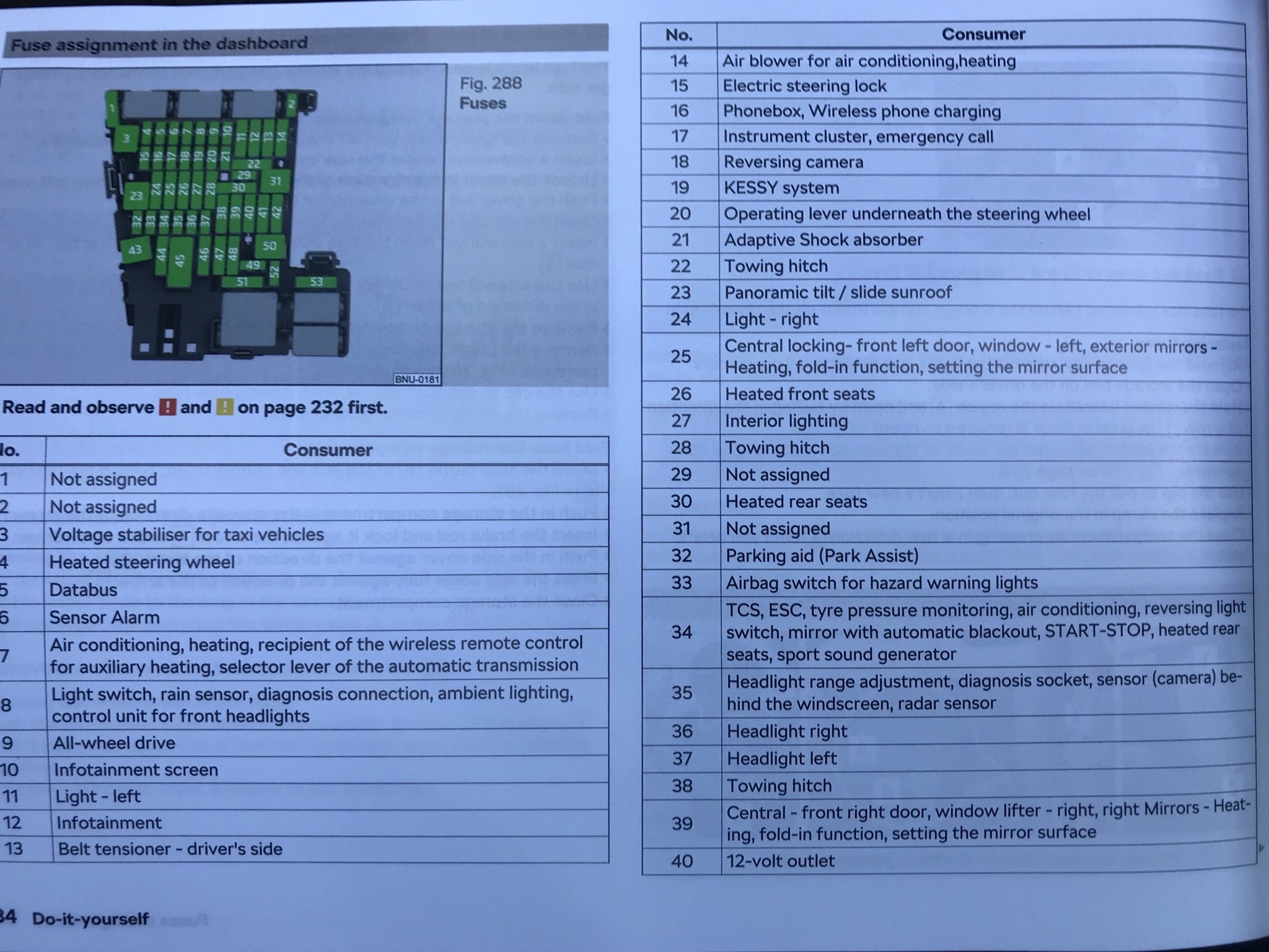

I've got two mini fuse piggy back adaptors from my mk2. Confused what I should piggy back off on my MK3?
I've got a power monitor box to keep my two cameras recording while parked so need constant power.
I'm thinking some of the empty slots are live as they have metal pins?
Any advice please
Edited by JimmyUK
I used the rear window wiper fuse think it’s F47
Unfortunately that's a full size fuse. My mini fuse adaptors are already soldered up and wrapped to my power monitor box so id rather not have to adapt it. Unless I have to use F40 12v adaptor in order to get constant power.
Edited by JimmyUK
like this?
16 hours ago, JohnnyType2 said:
like this?
Yea I have those but for mini fuses.

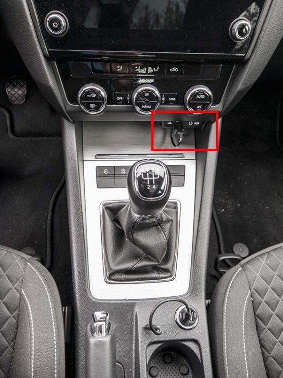

As my car is still under warranty, I didn't want to pull off trim or mess with fuses so I just fed power to my dashcam from the USB socket in front of the gear lever. This socket is powered only when the ignition is turned on (and it stays powered until about 1 minute after the ignition is turned off and the car is locked). As my phone is connected to the system by Bluetooth, (and charged from the 12v socket by the handbrake) this option works well for me. My car is one year old, bought and registered in France.
