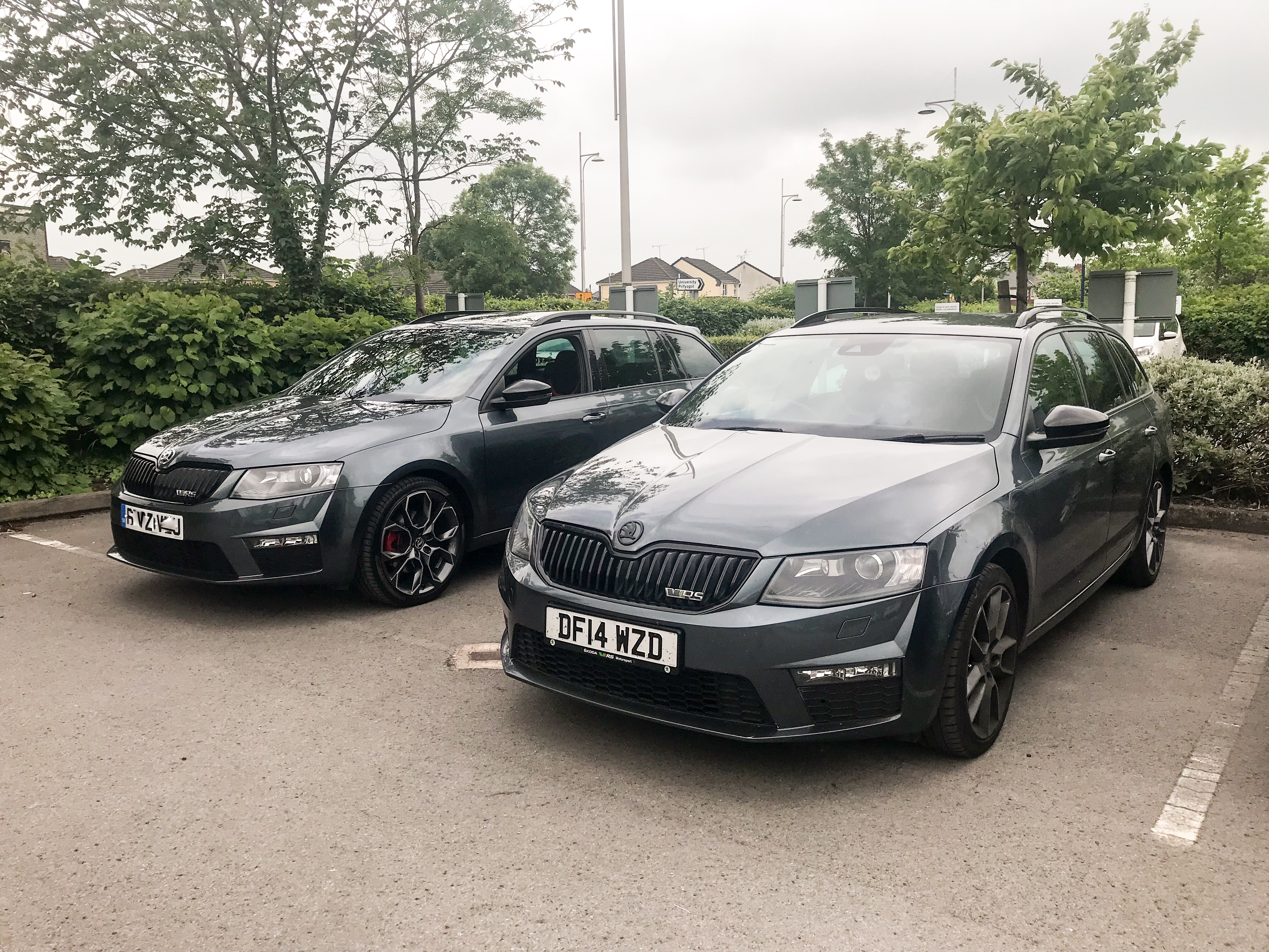

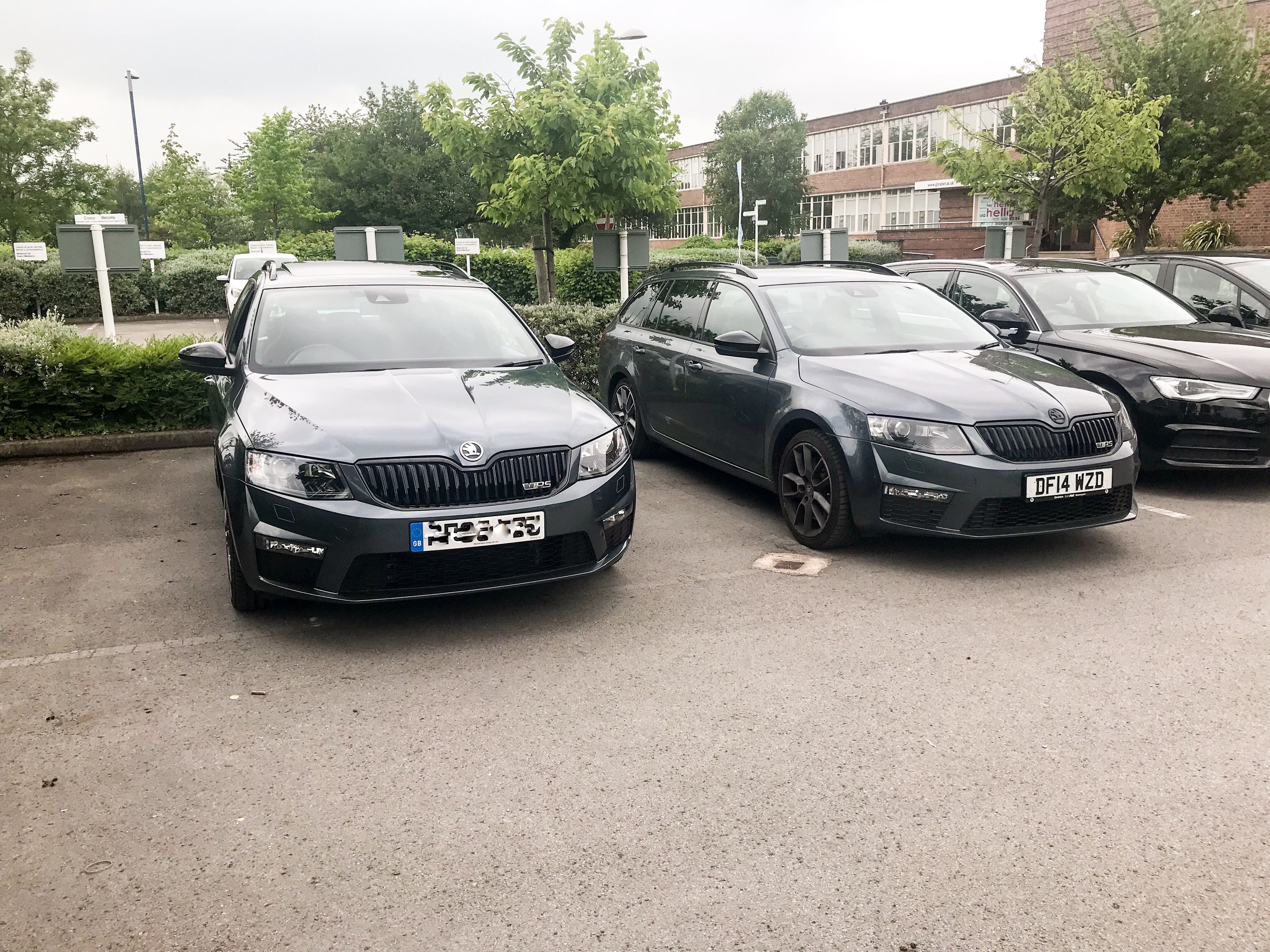

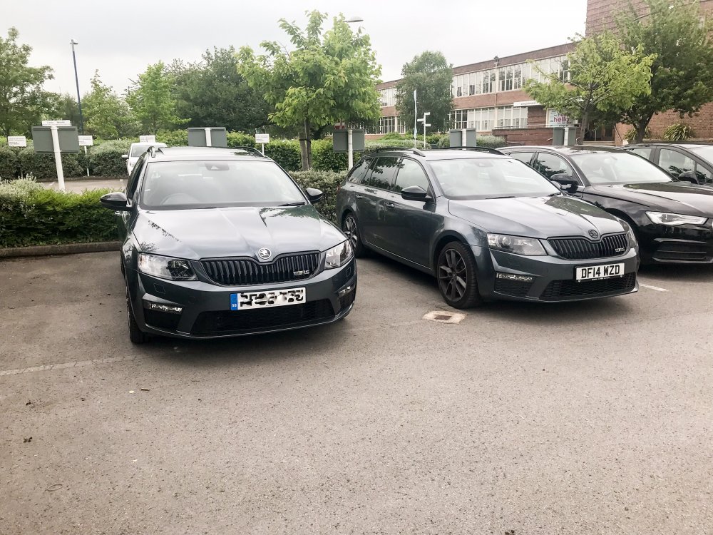

On Thursday I met up with @Fabia_19to do some coding on his lovely Octy and if nothing else I am determined that 19 inch wheels will make their way onto my car at some point. I am hoping to sell my Mercedes shortly and I’ll use some of the money on some nice wheels and tyres.
Obligatory pics of course
I can photoshop number plates, but I can’t photoshop my car to be clean, although it has had a quick wash today. Some more goodies are coming soon :D

Thanks again Sasha, extremely happy with the results and have got a lot of inspiration from your car too!
What other goodies have you got coming?
Cheers
Oli
It’s alright, glad you are happy. LED reverse light bulbs are on their way and I might even get around to installing one of the private plates. Still not sure which, but I’ve ordered a set of each to see how I feel as I’ve removed the one off the Mercedes now it is ready for sale :)
But why this millennial fascination with blurring number plates?
#snowflake
It’s not my car. I have left my plates as they are because it doesn’t really bother me. I didn’t ask the question of blurring plates while I was there so I took the liberty of editing them out.
These 2 look bada** side by side, get an aggressive vibe from them, really nice cars @SashaGrace  & @Fabia_19
Thanks :) The colour is really growing on me. I started off a bit meh about it but the more I live with it, the more I like it and I think the black additions really make it. A Quartz car without a black pack isn’t my cup of tea, but I think every colour should have the black pack, so what do I know haha.
Edited by SashaGrace
Quartz Grey and Meteor Grey are the only colors for me, agreed about the black pack, I think it provides just the right amount of black elements to make a difference and really set it off.
It does, it really does :)
