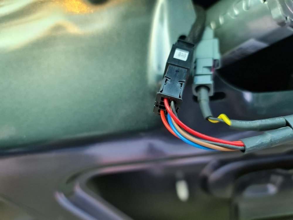

 I measured the cables now.
It has constant power on red and black so it should work?

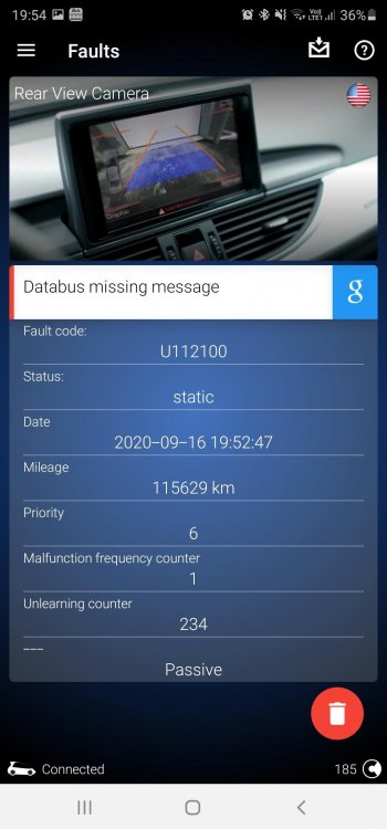

I do think i have an fault code under reverse camera, something about databus error.
I will check the fault codes.

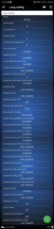

Have you coded Rearview camera in the Park Pilot module?
For me, it was enough perform following coding (my Octavia doesn't have any parking sensor, any park assistant and stuff like that, I just installed the rear camera):
5F Infotainment > 07 Long Coding > Byte 19 enable Bit 4 reverse_camera_low
The tricky point is to connect the camera to the right power source, camera must be always on.
Yes, looked there and it's coded too. :(

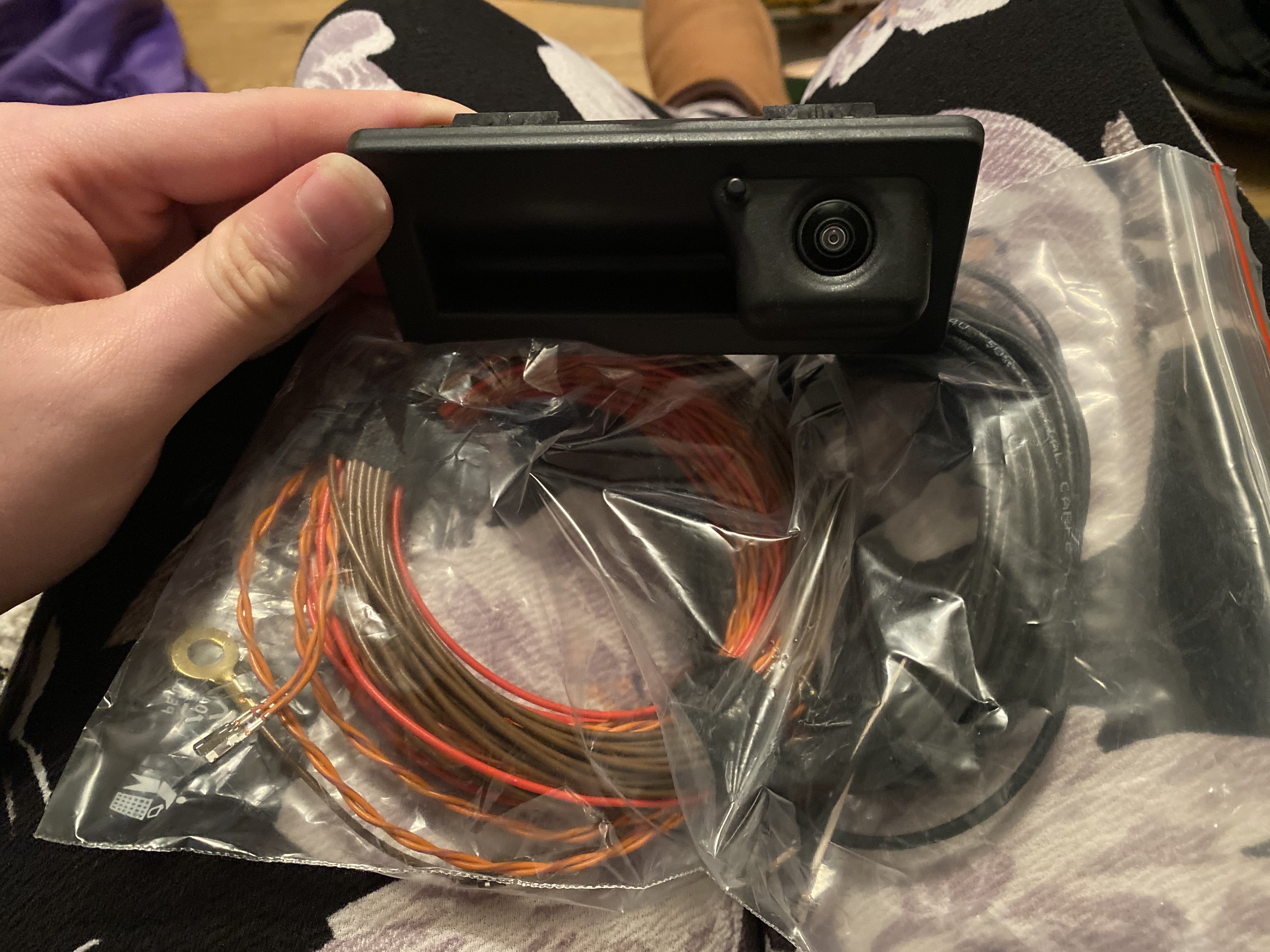

On 08/03/2020 at 14:52, SashaGrace said:
Also got another one...
Sasha where did you get this one? I presume it was to replace the cheap one you had?
Looking at fitting one to my 63 plate , other than cutting a bigger hole looks straight forward. Famous last words
vwmodul.de :)
