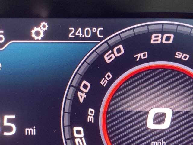

  • Talking of things that are done and working, barring a few things I need to sort, the virtual cockpit is in the car!!!!!!      Here’s how it ca

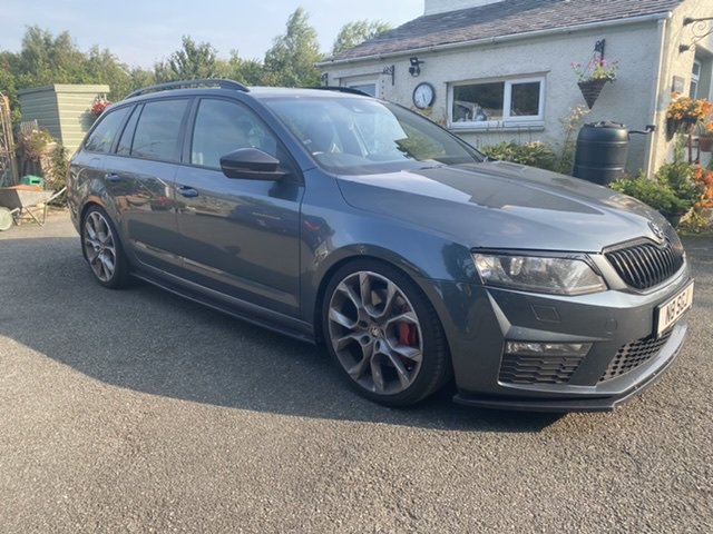

  • My wheels are back!!! Please excuse the dirty car but this week I have broken my Brother’s Fabia and my Dad’s Alfa 159 so I’ve just bolted my wheels on and got moving as I’ve no time today to fit the
  • Oh yeah!!!! It’s finally sorted, a couple of adaptations and coding changes guided by the genius that is @pab567 I have finally got the map mode working and it is awesome  So it’s confirmed that you d

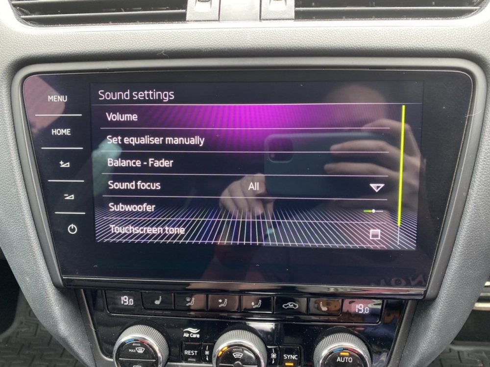

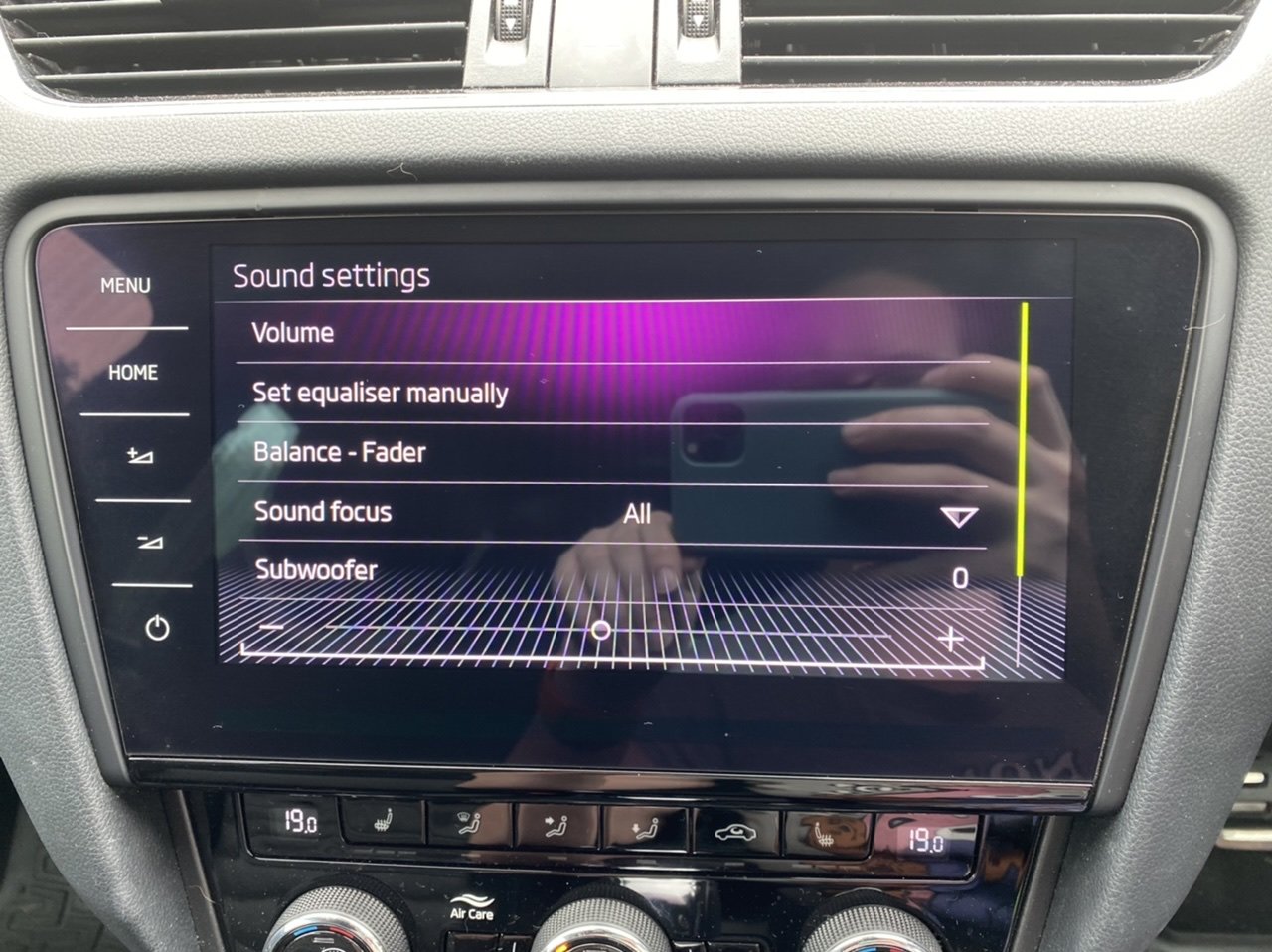

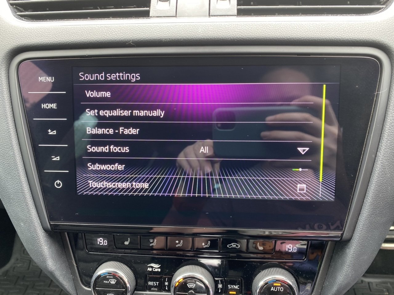

Coding and adaptation for the next mod is now sorted, can you tell what it is yet?
canton
Almost but not quite. CANTON centre speaker is coming as the pins are now active for that but will probably use the SEAT SOUND/Audi Sound System subwoofer without amp for easy fitting and a bit of boost. Just waiting on parts now.

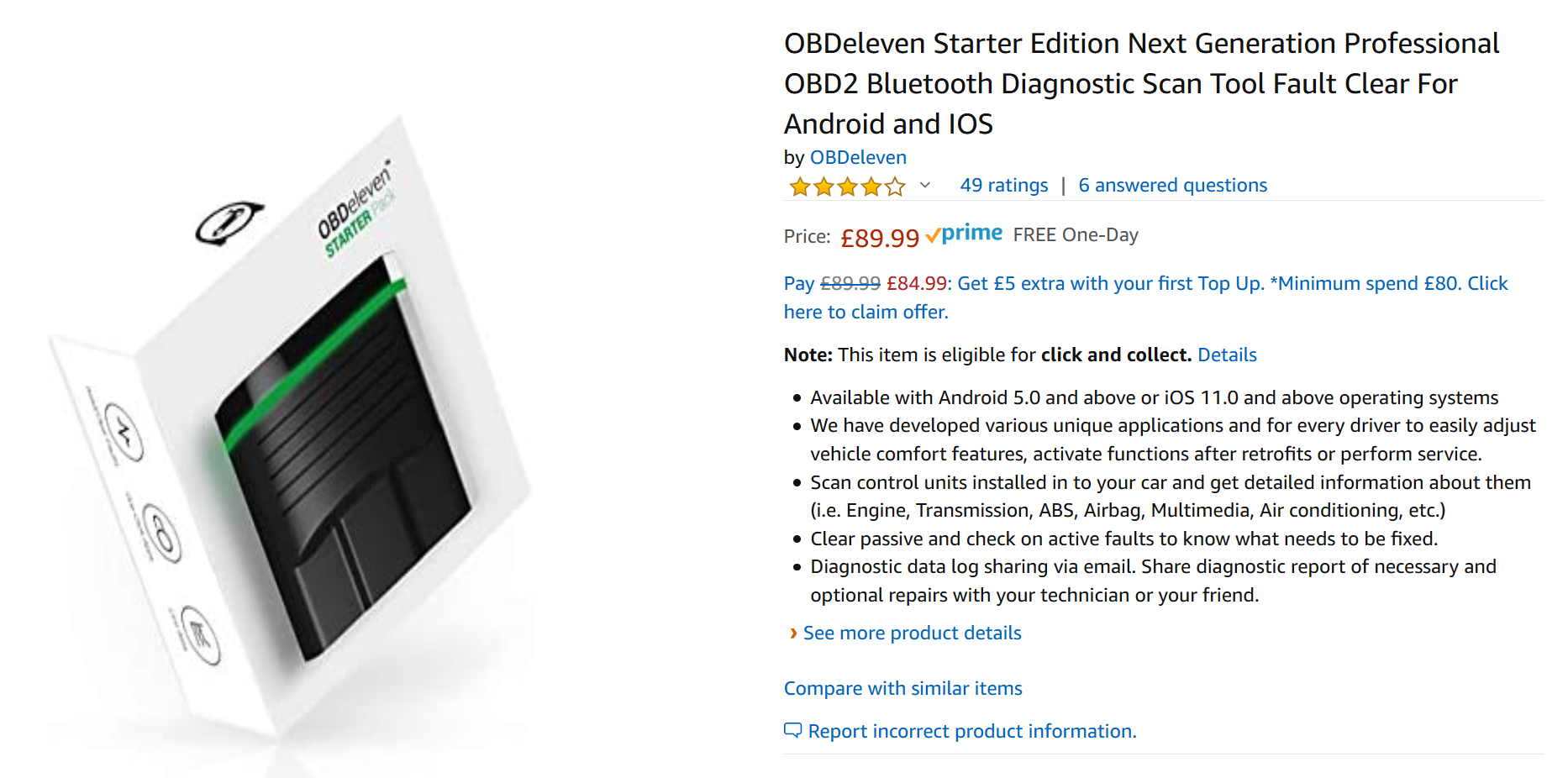

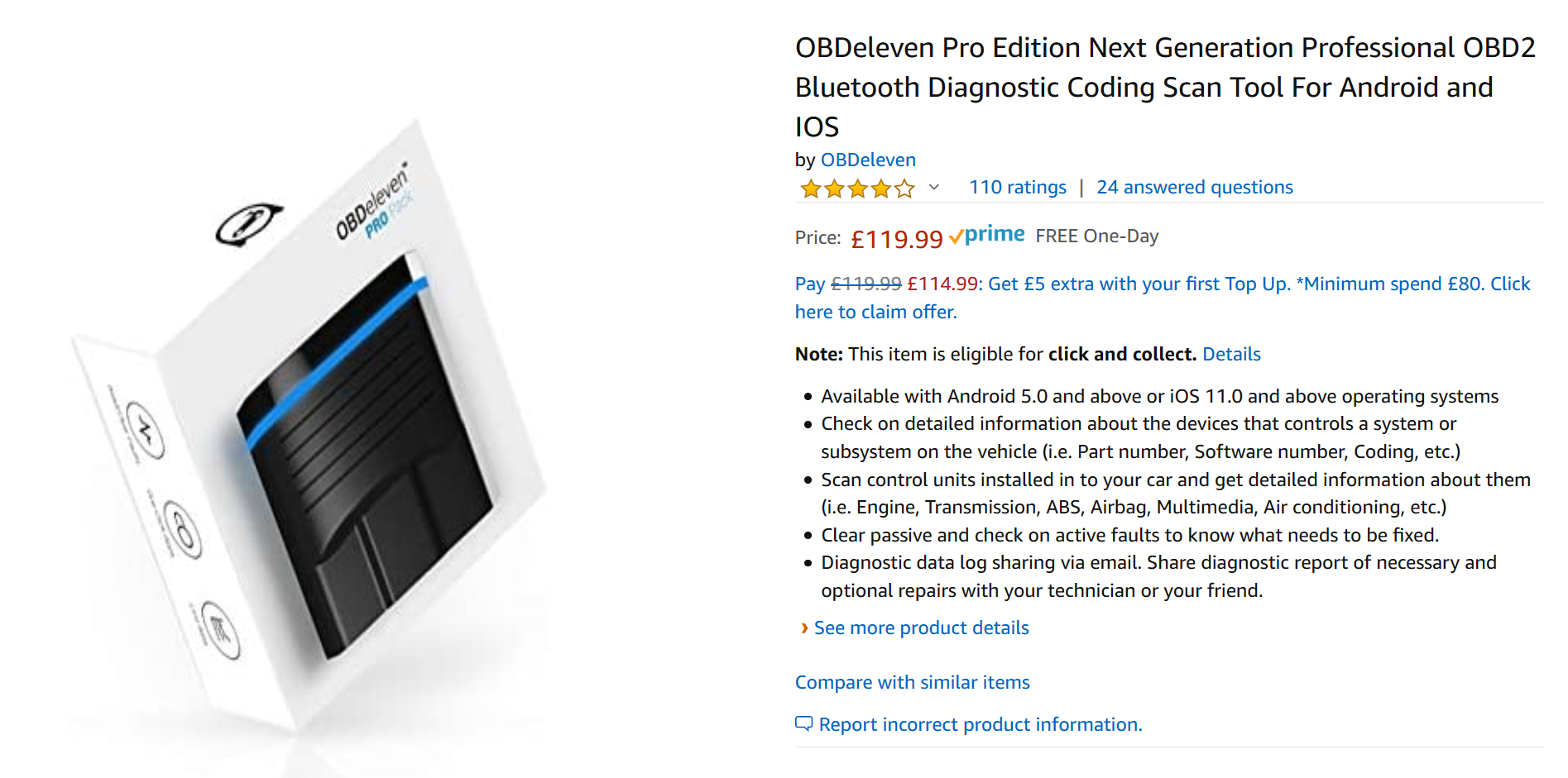

Hi Sasha.
Which variant of the OBDEleven would you recommend? Or perhaps more importantly, is there a variant of the OBDeleven that is not worth bothering with?
18 minutes ago, EnterName said:
Hi Sasha.
You want the next gen Pro version for the most utility.
I don't suppose you know where the link to all thr mods are for the obd eleven? I saw something ages ago  but can't find it now.
Look at the top of this forum. VCDS mods can be done through OBD eleven.
@EnterName Don't know if they got the descriptions and images mixed up on Amazon but you can buy the Pro pack for £86 on their official site. The Ultimate Pack is £120 on their site while the Pro pack is £120 on that Amazon pic you posted.
https://obdeleven.com/en/products-page
IMO the Ultimate pack isn't worth it, it comes with extra credits (which you can earn anyway by opening the app) and a carry case. Not worth the extra cost.

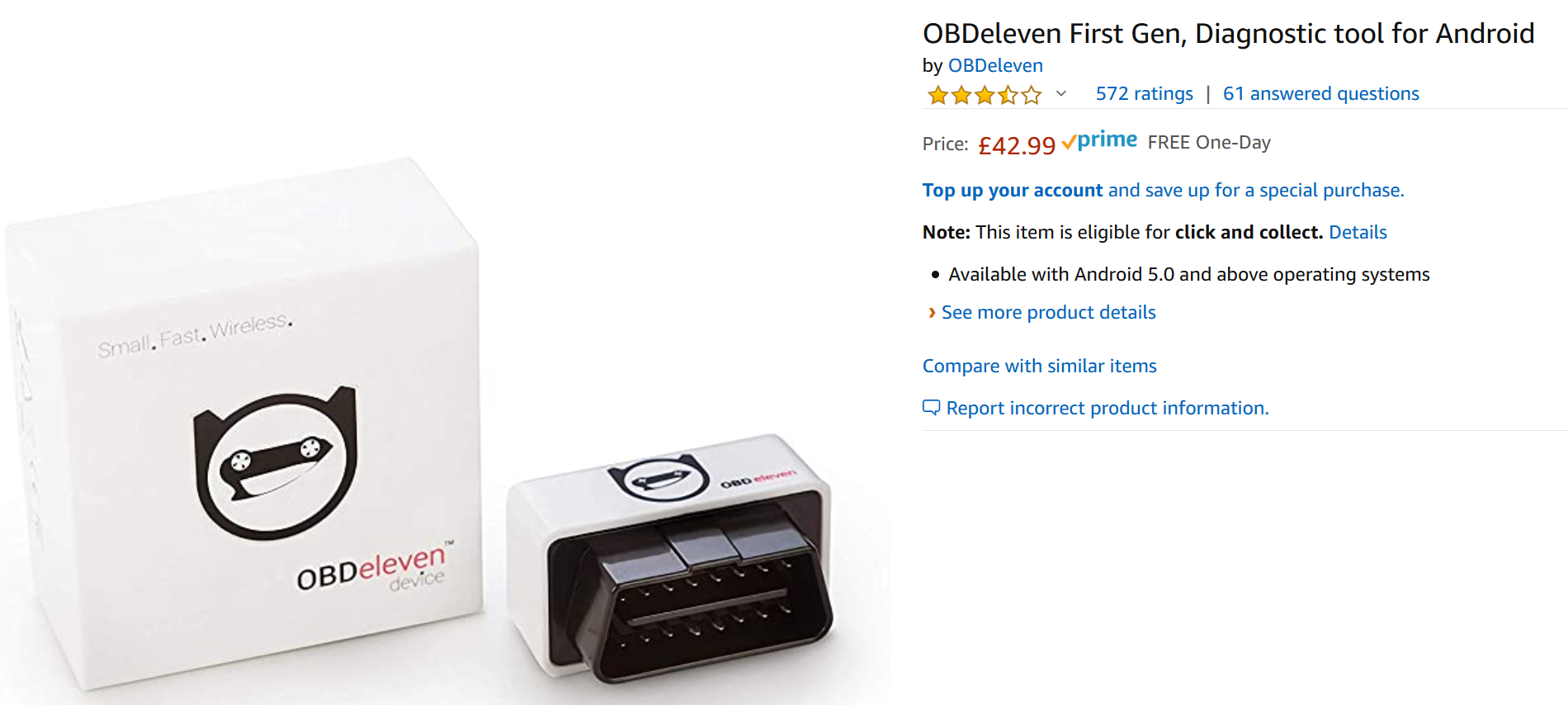

I’m kinda struggling to see where the second gen models have an advantage over the first gen (which is what I have and have had for a number of years now).
Aren't 2nd gen compatible with IOS?
Yes. When I bought the next gen version, they hadn’t sorted out the IOS app other than to use the OBDEleven mini apps. Since then the main app got updated and you can now do adaptations and long coding on IOS.

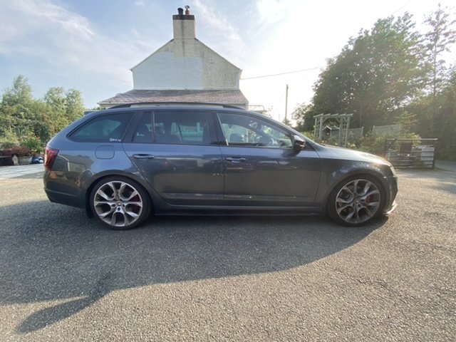

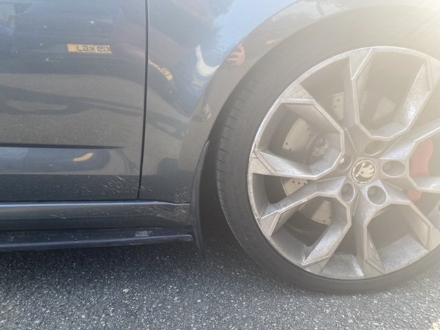

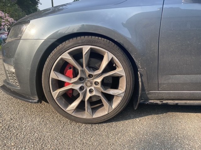

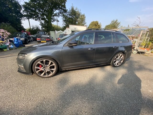

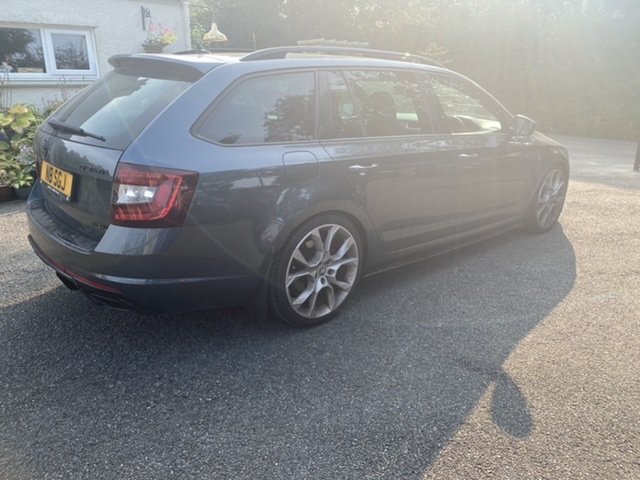

Spent the day trying to beat the heat and straightened the sagging right side skirt, which will never be perfect as the jack point is caved in but it’s much better now and cut the mudflaps to put back on with them. Should cut down on the spray up the sides. When it cools down again it needs a wash, but for now I’m much happier.
