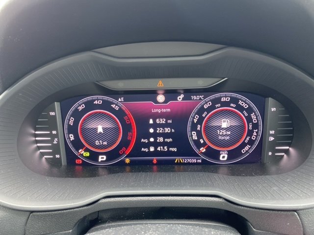

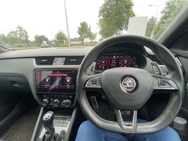

  • Talking of things that are done and working, barring a few things I need to sort, the virtual cockpit is in the car!!!!!!      Here’s how it ca

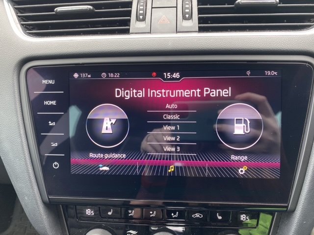

  • Oh yeah!!!! It’s finally sorted, a couple of adaptations and coding changes guided by the genius that is @pab567 I have finally got the map mode working and it is awesome  So it’s confirmed that you d

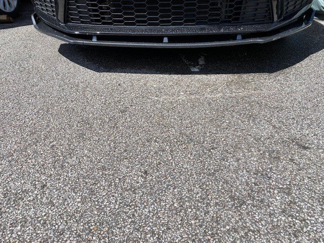

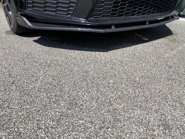

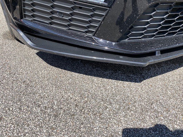

Just for info, You were in a thread ref front spoilers/splitters which covered a number of designs.  I went for a £41 one on ebay which comes in 3 parts.  Fitted it yesterday ad it is still there after a run up the dual carriageway.  While perhaps not as well made as the one over £100 it fits well to the profile of the car, left picture shows the shape best and is a cheap curb clipper
Yep probably wrong thread, but as I was here😁

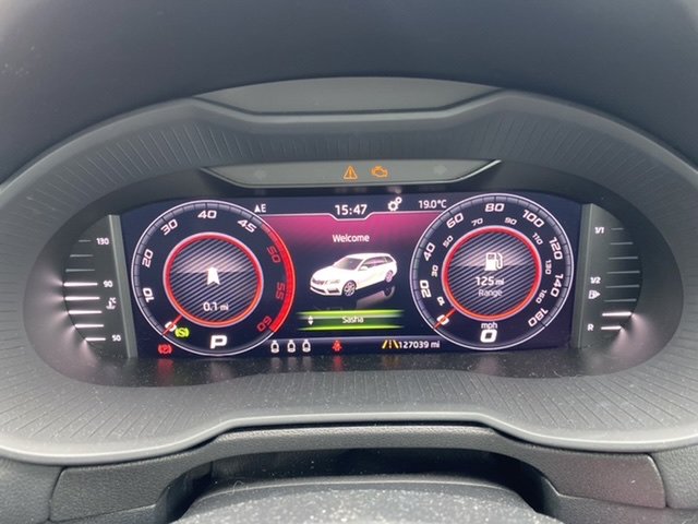

Start up sequence showing the lighting and key personalisation welcome 😊

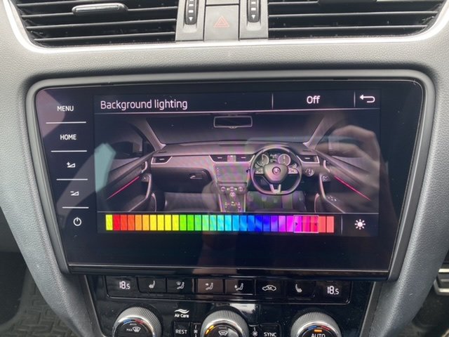

Hi, how did you mamage the 30 colours for background lighting? Is it really playing with the RGB values one by one via vcds?

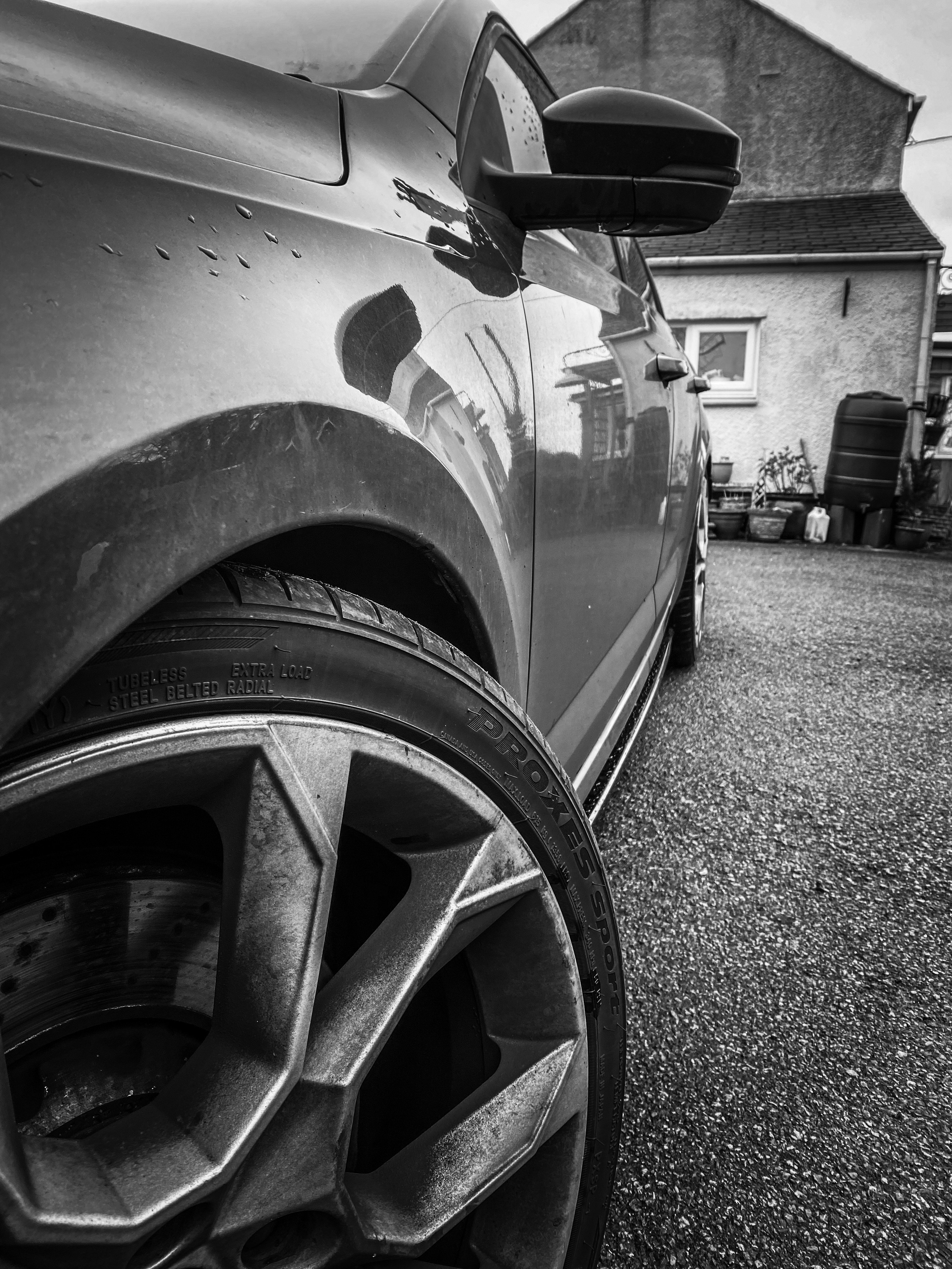

Thanks. As it happens it’s not the level sensor that’s the culprit. It appears to be dataset related but my VAS has packed in so I’m waiting on a new one before I can try and get to the root cause of the issue. So please enjoy a nice side shot Saturday instead.
Loving that shade on the Xtreme's against your metallic grey bodywork. Makes me want to put my RS6 replica's on next week.:emoticon-0157-sun:
Inspired by your photo above spent 5 hours painting my 4 brake calipers Skoda Rallye Green in tribute to my Mk1 Octavia and Fabia Vrs models and put on the refurbished (painted silver) Audi RS6 replica 8.5J x 19” alloys with Michelin Pilot Sport tyres.
