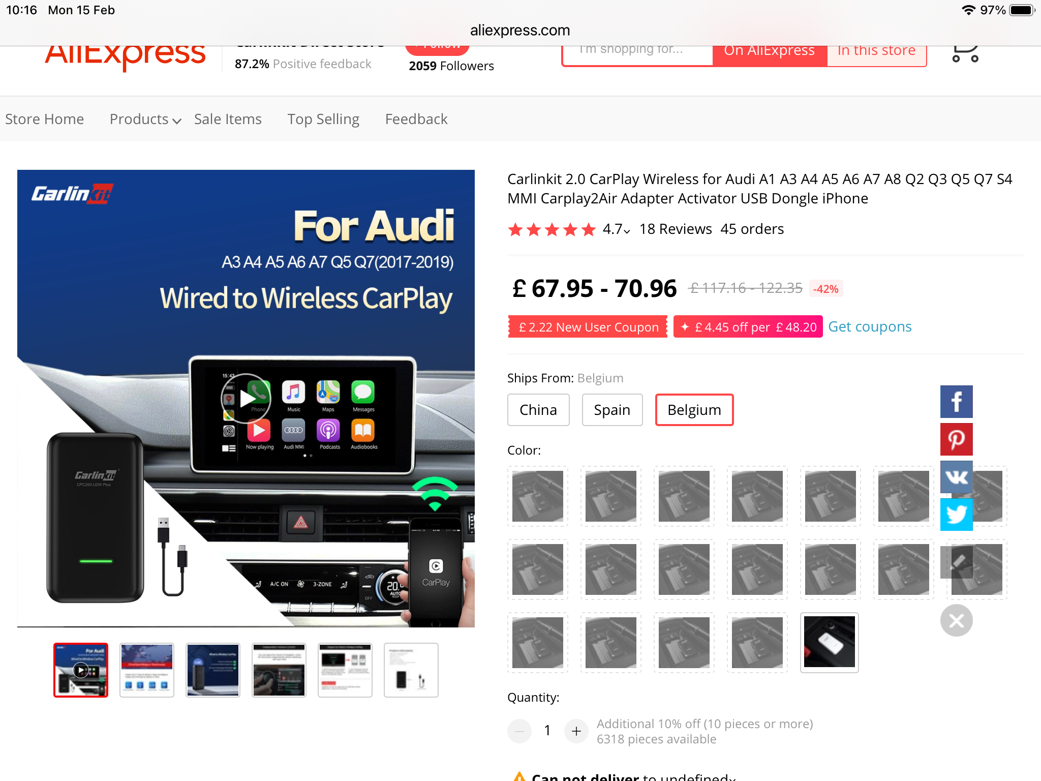

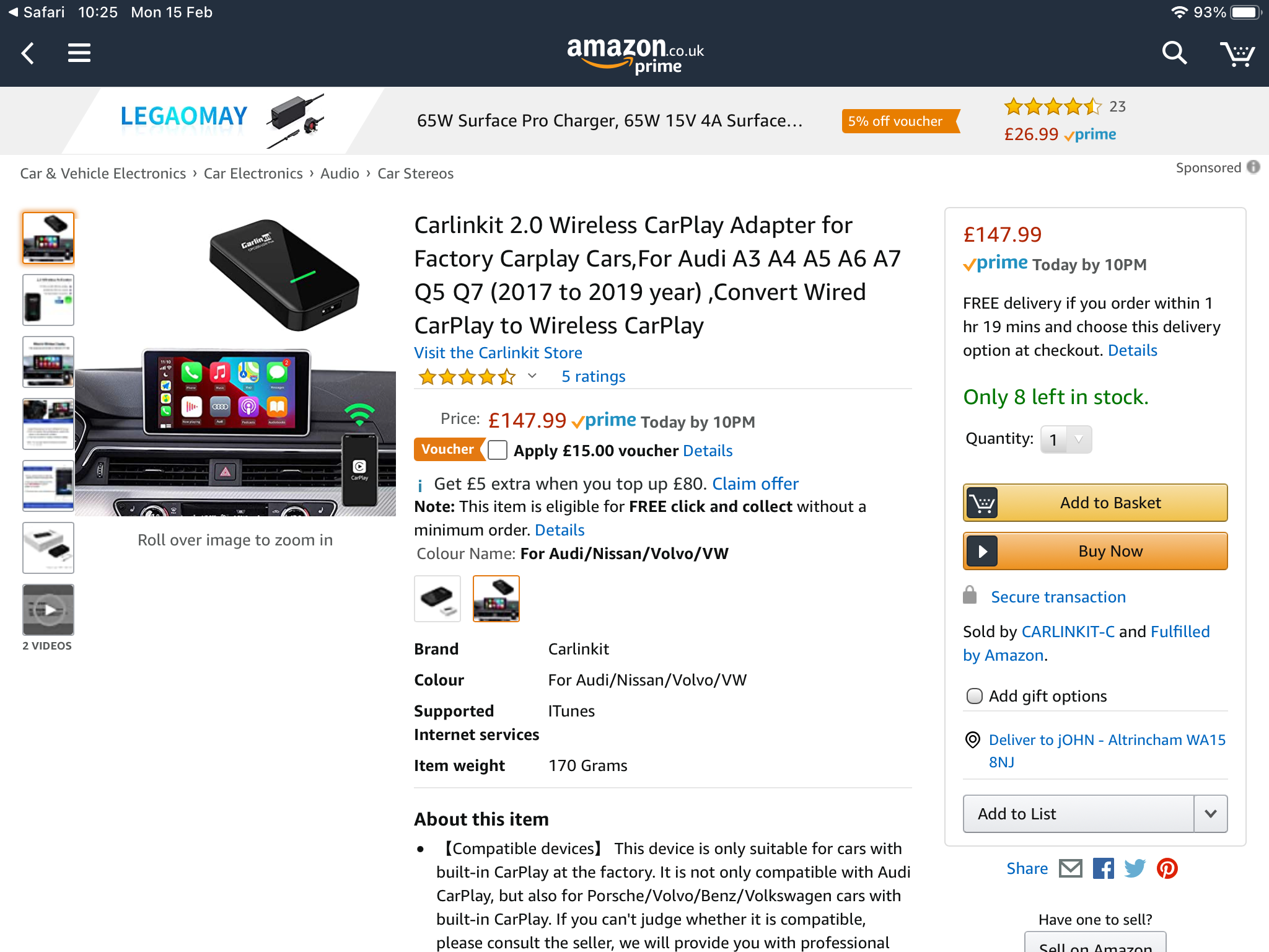

Hi, I am looking at the wireless CarPlay modules from carlinkit but there are very mixed reviews of them. I have looked at the Ali express link and Amazon.  Ali express is only shipping from China  to uk at the moment on 40 80 days delivery . Amazon is 130 with discounts .
do these dongles work the online reviews are very mixed .

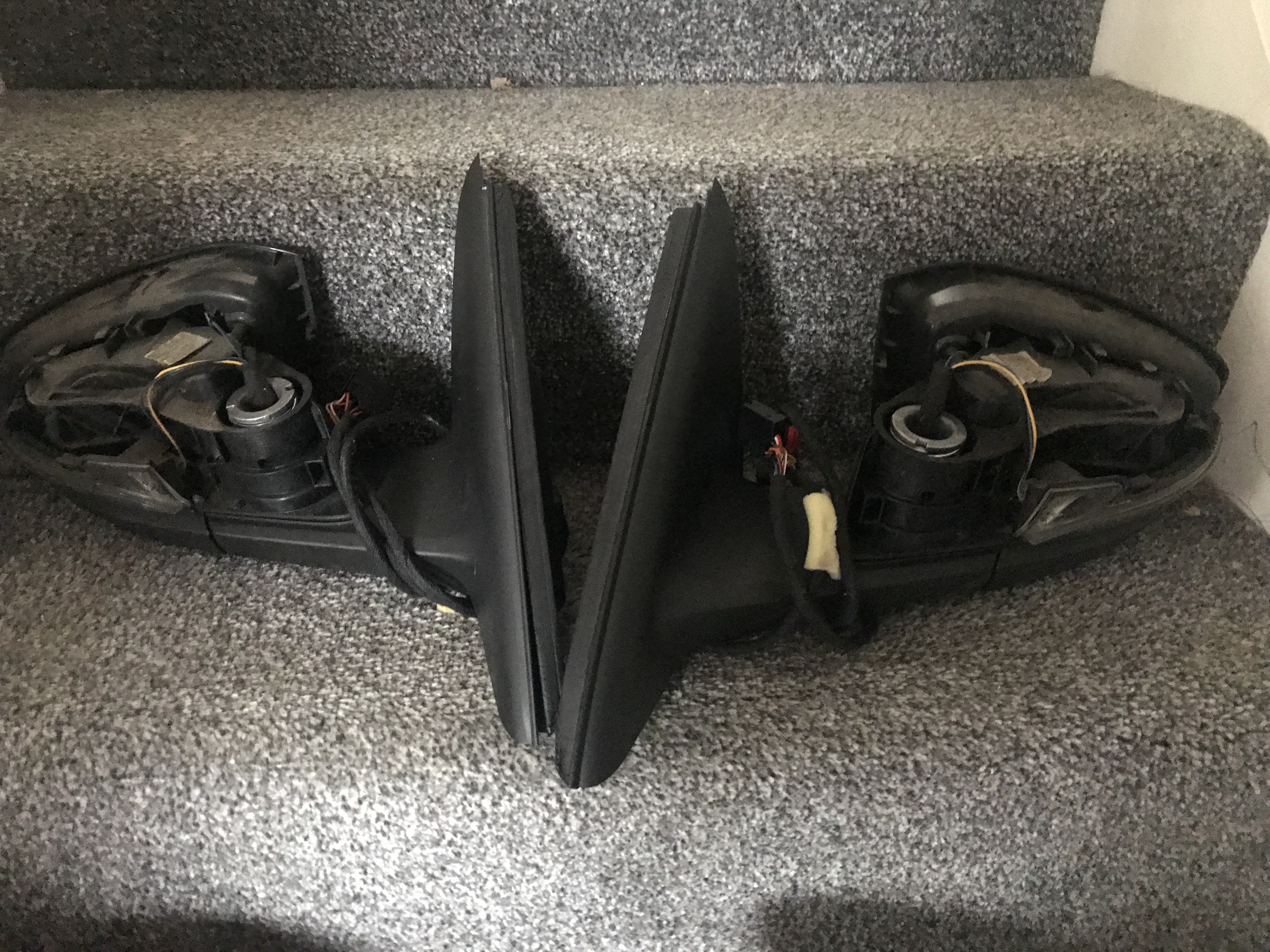

My power folding mirrors arrived today and as it goes I was busy this morning but free this afternoon so I made the most of it and got cracking fitting them. Now I should mention in case you don’t know, I live in Wales and it rains about 377 days a year so some of these pictures show some rain falling, but it cleared up later in the day.
The first job in my case is to change the mirror covers over because, as you can clearly see, these ones are red and mine are black. You need to angle the mirror glass over toward the mount (toward the car if you are doing this with mirrors mounted on a car) and insert a flat blade screwdriver about a third of the way down to pry off the release tab. I didn’t think to take a picture of me removing the red ones and there would be no point in me showing you the black ones as you won’t be able to see, so I’ve stolen this image of a white cap so you can see what you need to remove.
D51-B27-A6-C82-F-4777-B2-F1-BC05474-D8-D
05-CCC570-6318-4-B43-87-BC-5-BC9-F5-B2-B
The mirrors will then look something like this. You’ll need to do the same on the original mirrors and then reattach the covers you want to keep on the folding mirrors.

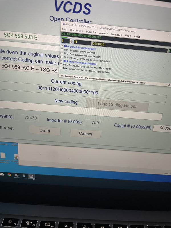

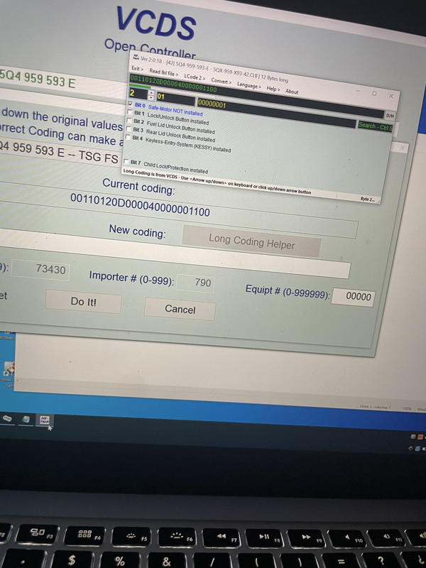

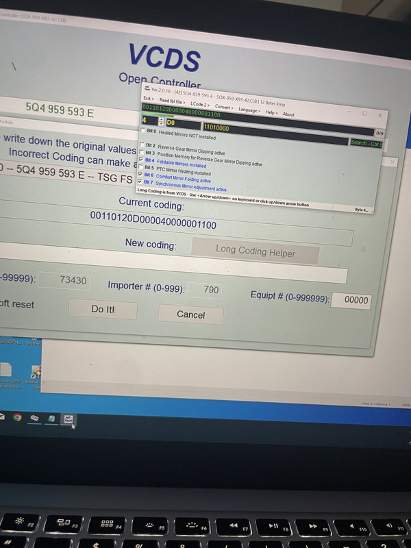

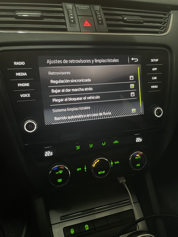

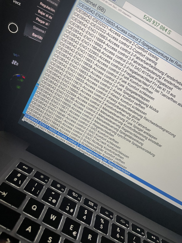

Hi. I need your help. I bought foldable mirrors, mirror knob and dorrs modules. I installed today and I can fold them using the knob, but they dont fold automatically when I lock the car. Well I tried to coding using VCDS but the opcions on my VCDS are not the same that in your post.
I did that:
On 29/11/2018 at 19:17, SashaGrace said:
[09] Central Electronics
[16] Security Access - Code is 31347, click "Do it!"
[10] Adaptation, choose from the drop down channel
[24] - Access control 2 - Funk Spiegelanklappung Modus change to “by look command via remote control key”
[26] - Access control 2 - Menuesteuerung Funkspiegelanklappen change to “active”
But I did find that:
[34] - Access control 2 - Profilfunktion fur Anklappung der Aussenspiegel
[35] - Access control 2 - Signalisierung Spiegelanklappung
I see the opcion on infotainment but I can activate.
Then in the car….
In the Media display
Click "Car"
"Setup"
"Mirrors & Wipers", select the option for "Fold away after parking".
The mirror lights work radomly   and i didnt see those options on modules 42 a 52. My car havent door lights
[42] Door Electronics Driver Side
- Long Coding
-front_field_light --> active
-turn_off_front_field_light_with_folded_mirror --> active
- mirror_folding -> installed
-mirror_comfort_folding -> active
[52] Door Electronics Passenger Side
- Long Coding
