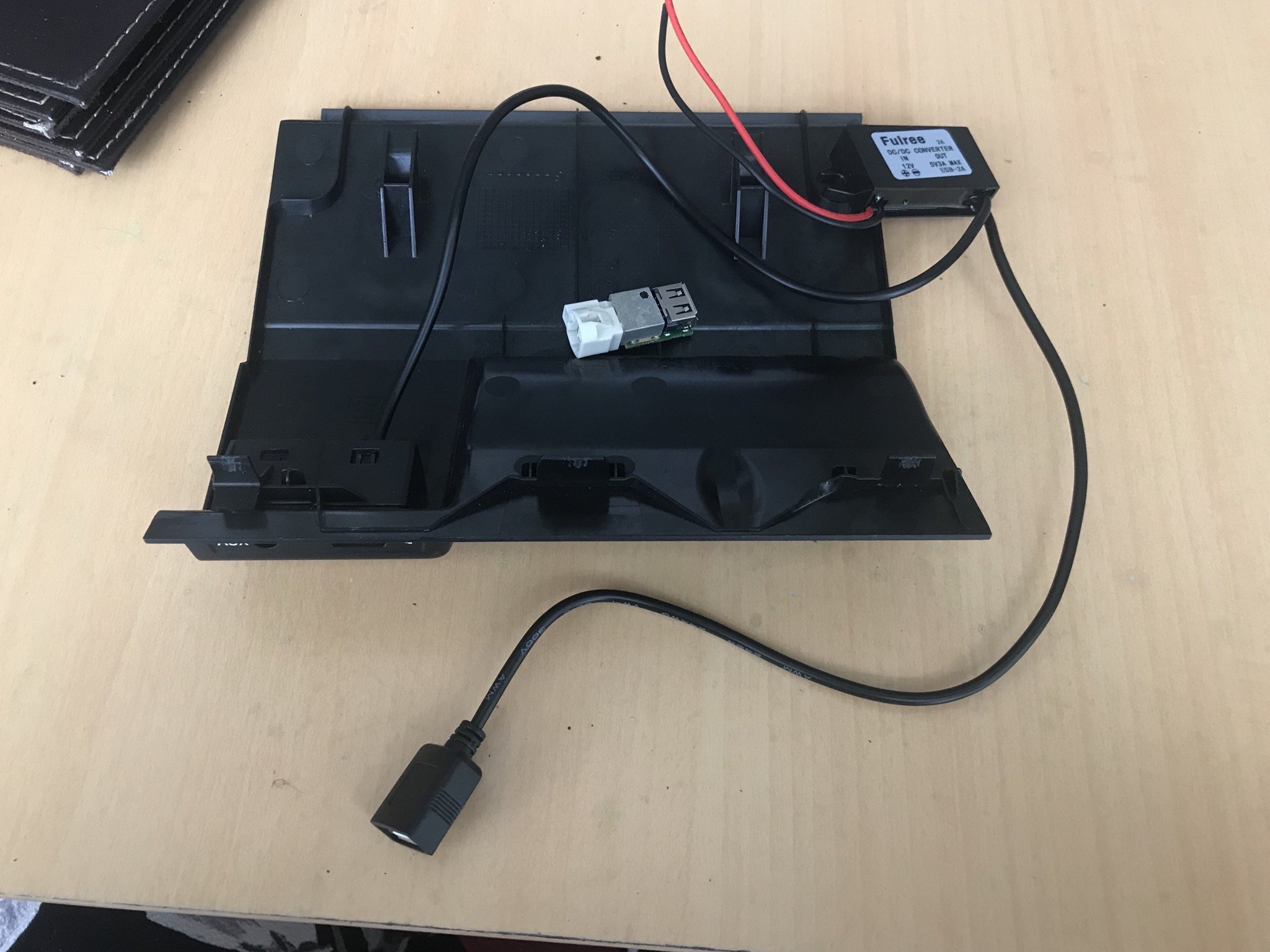

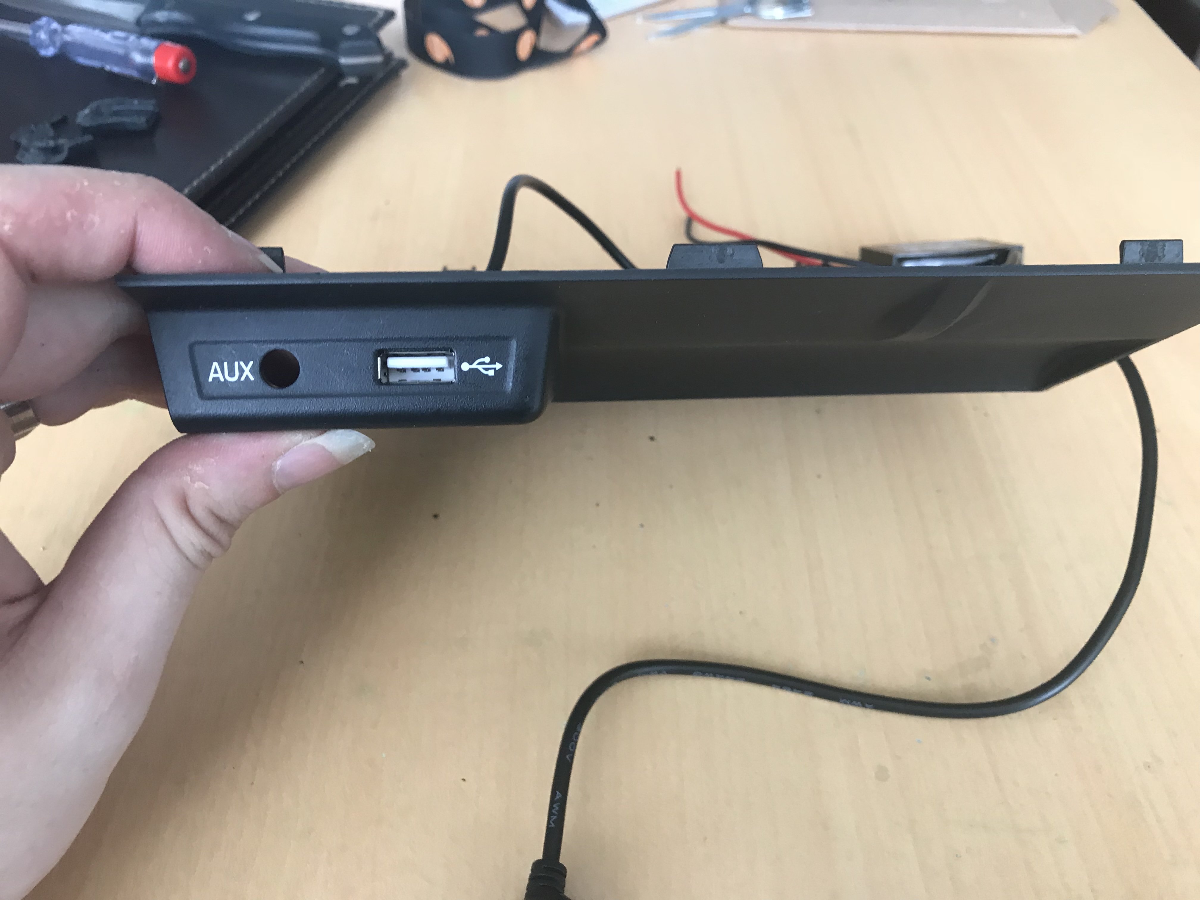

I made a USB charge only socket with a kit from Amazon and the case for the MIB1 USB socket and I cut the insulation off the Amazon USB and glued it into the MIB1 USB case.
Then the CarPlay dongle is installed in the factory USB which is unclipped and it’s all taped down behind the trim so no rattles.
@SashaGrace Thanks! Just ordered the Rear view camera and the carplay dongle! Time to see if i can mount it all as im hoping i can :-) How hard was it to remove the whole "USB" plastic panel? The panel you just sent a picture off. Also i was wondering if you had any pictures of the install process of the wireless charging pad? Im kinda debating just getting a "normal" 12v wireless charging pad and just throwing it down in the small space under the usb socket?

@SashaGrace Thanks! Just ordered the Rear view camera and the carplay dongle! Time to see if i can mount it all as im hoping i can 🙂 How hard was it to remove the whole "USB" plastic panel? The panel you just sent a picture off. Also i was wondering if you had any pictures of the install process of the wireless charging pad? Im kinda debating just getting a "normal" 12v wireless charging pad and just throwing it down in the small space under the usb socket?
Remove the radio screen and pull the climate panel out and then you can push this piece down and pull it out. Clips are tight but it’s not too hard. Installing the Qi charger involves cutting the console so if you don’t want to do that consider an inbay wireless charger, no cutting and it looks factory.
