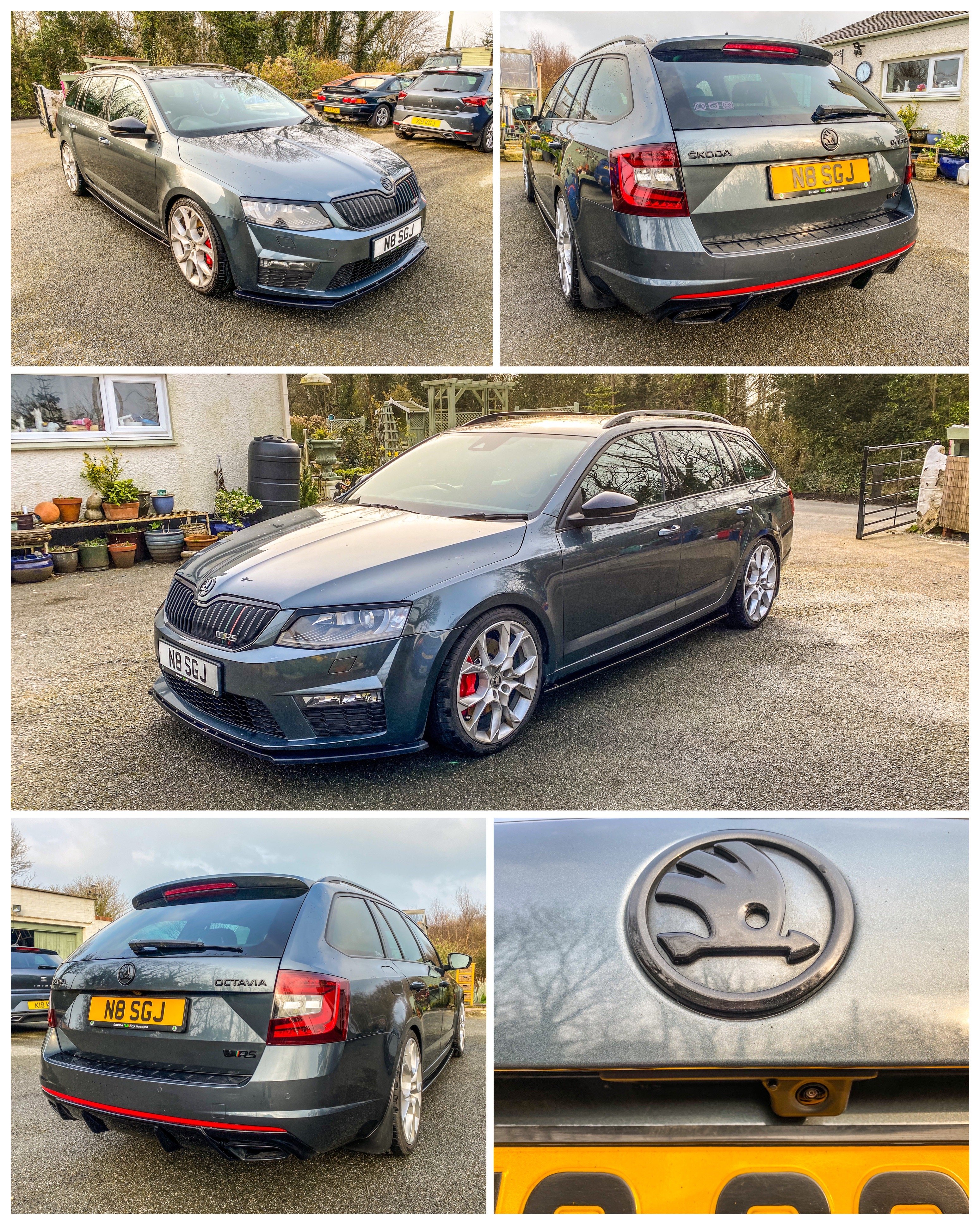

Nice ! Where did you get the oem camera from and did it come with the wiring/plugs ?
Came from a member on here who didn’t want the trouble of fitting it and went aftermarket instead. You can get them on eBay but make sure that (like this one) the end of line calibration has been done. The kit that came with this comes with everything you need.
Deadly, ive the same radio as you so was hoping it would be plug and play with this camera set up :
https://www.ebay.co.uk/itm/New-Orig-VW-Seat-Skoda-Audi-5NA827566D-3V0827566-H-Rückfahrkamera-Set-with-Cable/283687965666?ssPageName=STRK%3AMEBIDX%3AIT&_trksid=p2060353.m1438.l2649
after coding and slight modification to boot handle.. did you have to remove much material from boot ?
That’s the camera I’ve used. You do have to cut a lot of material out, old hole was 75x20mm and the new hole is 105x45mm.
Damn quite a bit alright! Will be nerving doing that to my car lol
Did yoou put anything bar primer and paint on the surface after to prevent rust ? Ive heard on older Skoda's they rusted a lot on the boot handles previously
It’s paired, cavity wax added around the innards of the plate light holes and this. Have the OEM plastic seal on order to compete it.

On 23/03/2020 at 21:58, SashaGrace said:
OEM Highline camera installed, this was a nerve wracking install as I had to cut the boot lid to make the larger handle fit. Pics in the daylight tomorrow :)
Can the coding be done with OBD11?
Yes, there isn’t much to code. As long as you have the pro pack you can do it.
Thanks, what is the pro pack?
The Pro software download to enable long coding.
Ok, I thought is had something to do whit the camera.😀 I have the PRO pack.👍

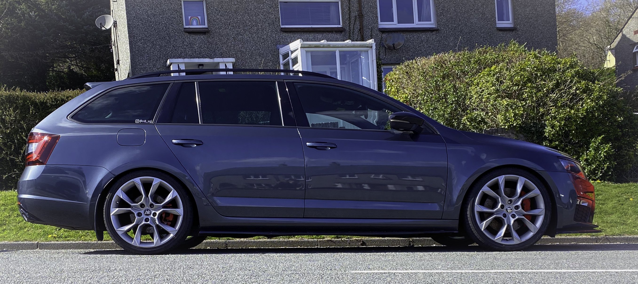

a question regarding your springs, just with you having them for nearly 6 months.
How've you found them to be? Any issues with the drop in ride height? (Speed bumps, that sort of thing) Can you feel a noticeable different in the handling?
Only asking because I know you do like to 'drive' your car
Edited by tunedude
Speed bumps are a bit of an issue with the splitter on the front but I’ve not scraped it yet. It’s a firm ride but the standard setup is hardly forgiving. It corners much flatter and feels much more planted. I love how it sits and no scrubbing even when fully loaded.
That's good to hear. I'm still looking at getting mine lowered but I still that bit hesitant lower doing so because of the potential clearance issues. Certainly the worry I'm having is if it were lowered too much, it would prevent me from towing my bike trailer. That's why I was looking down the coilover route to have the ability to have the rear lowered to where it would still be safe to tow.
I assume the 40mm drop on your car is only 25mm, with the 15mm drop our cars have already.
Yes that’s correct, 25mm lower than a standard vRS. Eibach do a kit that isn’t as low if that helps?
Ideally what you want is an uprated spring that is standard ride height. That way you would keep the comfort as the piston would still have its full stroke rather than a reduced stroke with lowering springs. Thats how you get the jittery ride as it has no movement. However no one makes them off the shelf. I always look at BTCC cars as they have massive movement in the suspension and thet are not rock hard like most people would think. I lowered my last Octy with Eibach but was always scared of speed humps. I am leaving mine well alone as for a standard car it handles well. Just keep it balanced through the corners and the car will handle just fine. Probably not on the track as that is a different drving style to advanced driving. But my car will never see a track.

Do you happen to know what the part number is on that new rear camera you got ? :D
Thanks!
5NA827566D but make sure the calibration is done for an Octavia in the correct bodystyle.
