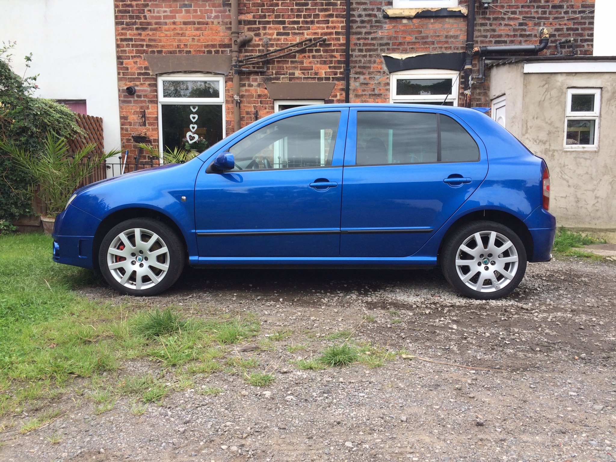

So I’ve got a vrs, mapped to 180bhp with supporting mods for more than that but I’m happy with that for now.
I have 312mm brakes on the car, but standard suspension. To be honest it handles like a boat! I’m looking to stiffen the car up a bit, I don’t go mad when driving or go on track so I don’t need to pile thousands into making it handle amazing. Just looking for something a bit better than standard.
I also don’t want it really low. I’m wanting a drop of around 25/30mm at most.
I was going to get eibach 25mm lowering springs, will standard shocks be okay with these? The front shocks are brand new I should add.
What else can I get to stiffen it up, RARB, strut braces, polybush mounts?
I will be fitting Octavia spiders on in the new year too, any tyre recommendations? Not a millionaire either so I can’t afford to pay a massive amount for tyres haha!

Replace the rear shocks if you are touching the springs as they look past their best the bump stops are perished looking at your picture.
Eibachs work fine with standard shocks but I would definitely replace the rears since you've done the fronts already.
