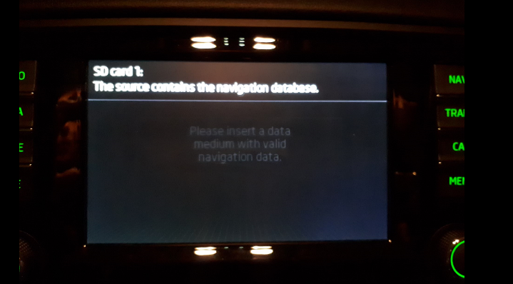

I Tried turning on the engine, put it into the SD1 slot in the glove compartment, I hit the "NAV" button (topright), then the screen says "The source contains the navigation database".

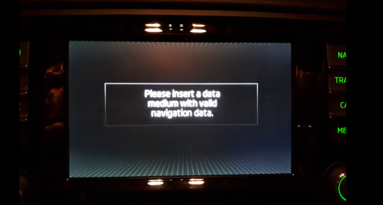

After a few seconds, the screen changes and says "Please insert a data medium with valid navigation data".

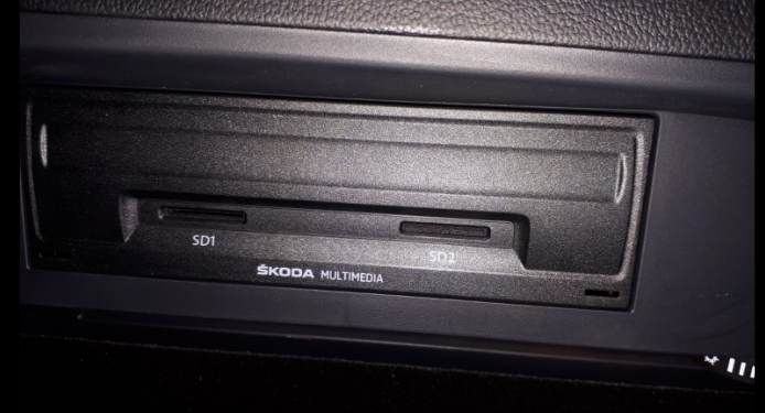

If you can post images of the card and headunit we can confirm.

Hi, see attached photos... Thanks  a lot for your help - much appreciated.
Yep - that's an 8GB card for the MIB1 Amundsen system fitted to earlier Octavias (built before calendar week 22 2015).  You can see that from the date on the card (calendar week 45, 2014), and the fact that you said it was only 8GB in capacity....
You definitely have a MIB2 system in the car - that can be seen by the fact that you don't actually have a CD/DVD drive in the glove box, just a blanking plate.
The dealer has given you the wrong card.  The Amundsen systems will ONLY work with an original Skoda SD Card.  The only way you'll get it working is thus with a genuine Skoda SD card for the MIB2 system - which should be (I think...) 16GB in capacity.
