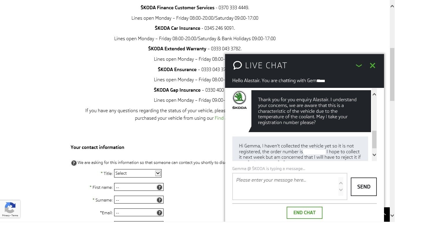

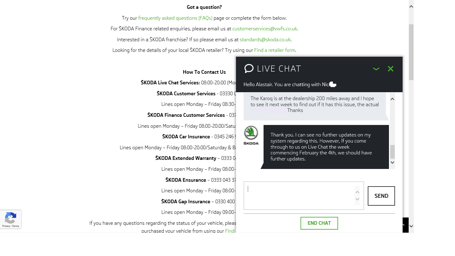

I have used the Skoda chat facility to track my car from order to dealer delivery and have used it regarding the issue as reported by HJ, a reply from Gem.. contained the word "characteristic" and the last contact today via chat with Nic... I have attached.
It will be interesting to drive the Karoq and find for myself what is what, having mentioned my concerns the salesperson said I could drive it with trade plates on rather than register it incase I decide to reject it which they would rather avoid (cough) and feel could be a "messy" procedure.

“A characteristic due to the temperature of the coolant”  How does coolant temperature cause kangarooing?
It doesn't, it happens warm or cold on mine.
Yes that made me wonder which comedian was writing the scripts for the replies on "Chat"
