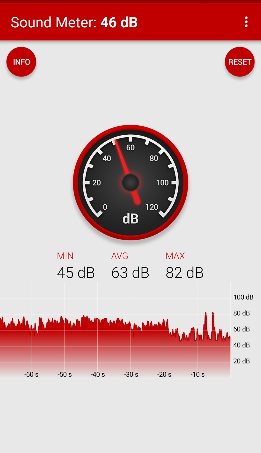

Hi all, If you get your passenger to run a db meter app on their phone what sort of numbers are you getting at a steady 60mph on mway /dual carriage way ?
You won't get any meaningful answers really. Wheel size, tyre make, type of asphalt, phone type, the app, etc. Far too many variables.
Best thing is to record yourself on a particular road, then repeat on the same road when you have done your mods to measure any gains.
Yes sure
My own 06 Golf hovers around the high 80's varying 1-2db (which is obvious quite a bit with 3 being double)
Some premium cars I have hired seem to hover around the low 80s
I'm guessing the Superb will be in the middle somewhere
Here is my car at 60mph on the motorway. 1.4tsi, 17" wheels, low dB tyres, ACC on and I've done a lot of soundproofing to the car. The two spikes at the end are cats eyes, changing lanes.
