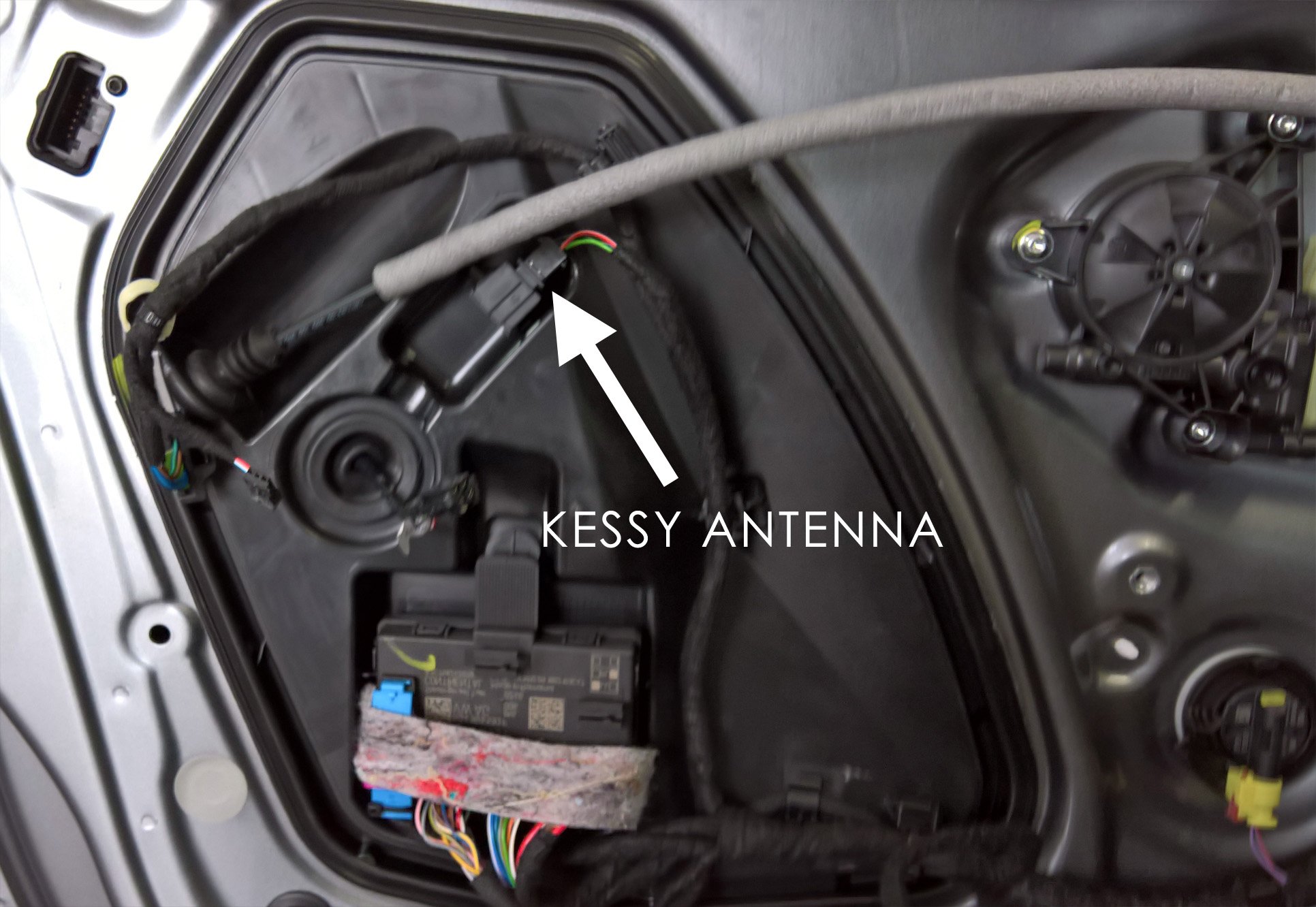

DOH! Follow-up. (No video sorry, I started tinkering and got stuck in and forgot, although it's exactly the same as the drivers side, minus one connector on the window switch area).
I had a KESSY system error that only manifested on the test-drive after doing the Passengers side today
 I forgot to reconnect the antenna. It seems if any sensor is open circuit, the whole system goes down. Drivers and passengers handles failed to work.
This one, as it's not really visible looking down from the top during the final connector check.

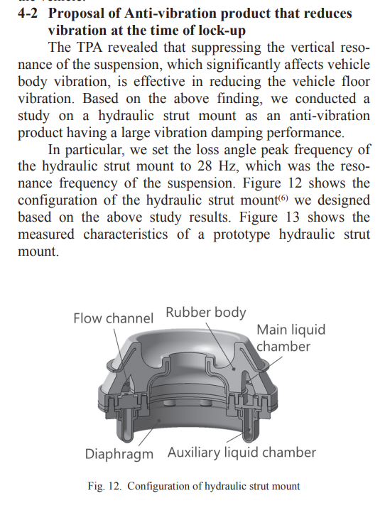

I was thinking, does anyone know if any suspension bushings /  components from the Audi A8,  fit the Superb?
I definitely think some changes to bushings, strut mounts etc could make a big difference.
Unfortunately kits are all about making NVH worse ...
https://www.sparesbox.com.au/part/superpro-f-and-r-enhancement-bush-kit-fits-vw-kit5238k?gclid=EAIaIQobChMI7-nx9sji6QIVJNWWCh0iNQa9EAQYASABEgLLj_D_BwE
Hmmm....
https://www.febi.com/en/car/nvh/
