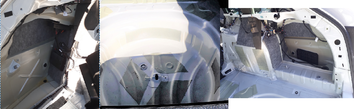

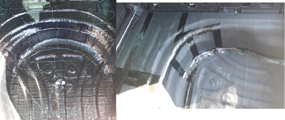

Next on my list was boot floor and the rear wheel arches from the inside.
Starting point is quite plain metal

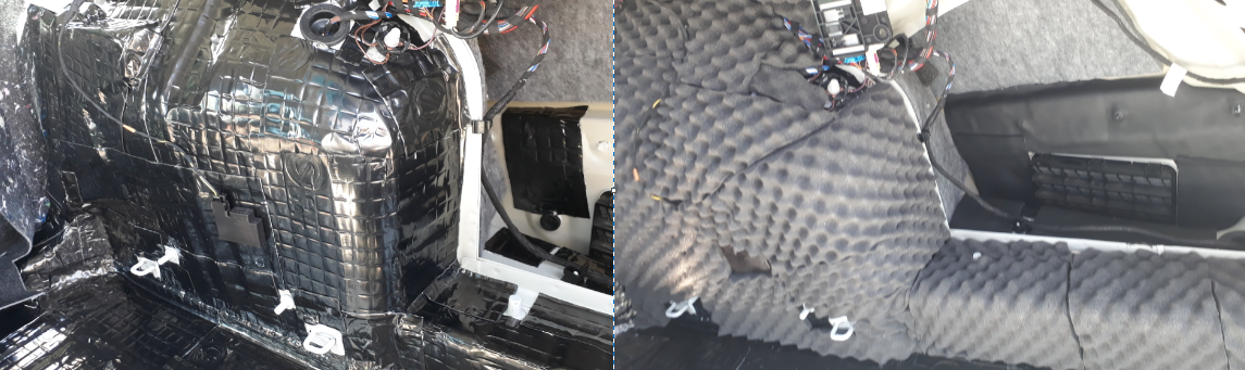

This is how I did the sides. Added 2mm silent coat and then 25/15mm noise absorber where possible and 6mm noise insulation to other places. 25mm on the side of the wheel arches is almost too much. It is now litte tight fit for the boot mid floor but managed to get all back in place.
For the floor I used 2mm silent coat and 6mm isolator. That was also tight fit to get the "spare tyre" styrofoam thing back in place.

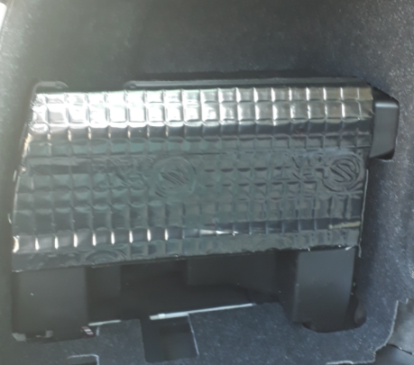

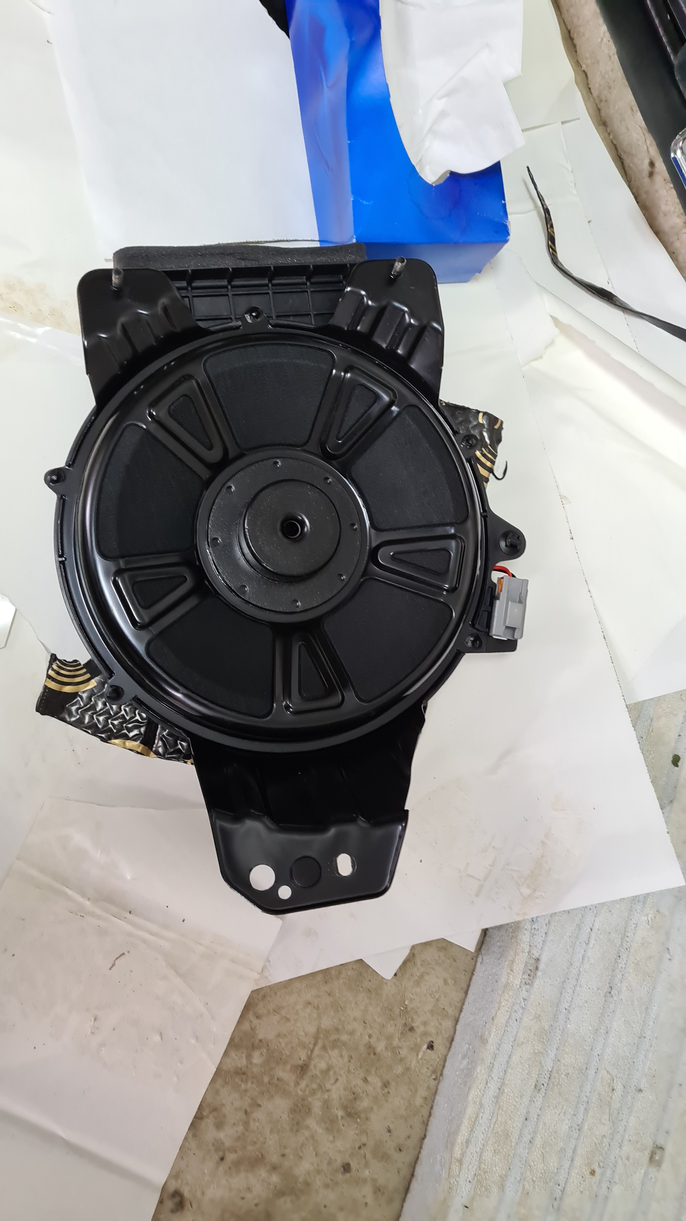

In addition to these I added few pieces of silent coat 2mm to subwoofer. It has a great effect to the low sounds in my mind so thanks for the tip to earlier writers.
Like I wrote this was my first insulation so the overal look and end result might not be professional level but Ii general I'm really pleased the outcome and rear of the car is now much better than it was. Now noise that comes to front seats clearly moved from back to front floor/doors so those are next on the to do list. Maybe hood will have some treatment before those :) It took around 20h total and most diffucult was to figure out how to dismantle all the parts without breaking anything.
Goood job! The only thing I really need to point out, that's really wrong is adding anti-vibration pads on subwoofer. The deeps are not better because you did that, but because sub is not doing its job. The point of these subs is that whole chassis is used as "vibration" device and when you add anti-vibration pads you basically stop the vibration which is creating the sound in the first place. If this was normal sub, the chassis would be stiff and would not create any vibrations it self. I was testing this theory a lot on the Canton sub and I tried various positions of deadening material and more and less and I've realized that it kills sub to add material on there. Just my opinion, if you believe it's better well ok :D . I upgraded sub later and added AMP and it was far superior then. But was a lot of extra work.
Sorry wrote poorly but of course I did not add anything to the subwoofer itself but the subwoofer plastic casing.
That's exactly what I meant yeah... this heavily reduces subwoofer bass because it basically stops vibrations (sound) which is what sub is made for. 200w on this sub is now like 100w.If not less. And deeps are just as deep as the membrane can make. Anyway if you prefer it this way its your choice. I didn't like it at all. It was also not any deeper as before. Just much much quieter.
What made my sub deeper and better sounding, was removing the cover or adding a lot of noise insulation on the cover it self. so it didn't create extra noise. I had same issue in Volvo because where there subwoofer there is battery and its cover. And that fixed the problem. I did actually noise insulation on whole V90.
OK. That's something new. My understanding has been that speakers work always better when there is not anything else vibrating than the actual speaker. At least I had to turn down the sub level couple steps to get it back to same level it was earlier.
At home yes. In cars yes and no. My V90 Bowers & Wilkins sub is not sub at all. Its like a "shaker" that shakes car chassis to create deep tones. The same works with most "subs" in cars.. Except those you buy extra which do have MDF hard chassis. If resonance would be a problem, why some cars have subs in spare wheel? it shakes like every thing... not just air.. You had to turn down sub to get same level as it was before noise insulation? now that sounds really really wrong.... Well whatever suits you :) I guess.
I tested this really thoroughly and my ears found any sort of extra butyl on speaker chassis really bad influence. There is reason why skoda uses plastic instead of MDF on these subs. Its not the price as some people may think. Anyway.

This is B&W Subwoofer (whole sound system is 3700€ extra cost). Looks pretty weird and nothing special. the exhaust of sub is actually turned outside of the car in rear wheel arch.. This was made so air doesn't move in the car, but only chassis of the car. its really strange way of doing it but it sounds awesome...

I did the same to mine when I matted my boot too. The quality of the bass improved IMO. A lot less 'flabby' and one-note-artificial boom.
Hi, I also did this, and I like the sound this way better. Without, it made too much muddy bass vibrations. After covering it became more  precise, did not notice any degradation in loudness.

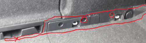

Would you explain the procedure for removing the side trim panels to access the inner arches as per your pics?
It's a job a want to tackle but it looks like a bit of a nightmare as those side panels sit under the plastic panels that support the rear parcel shelf, so it looks like all the plastic panels and C pillar trim come into play.

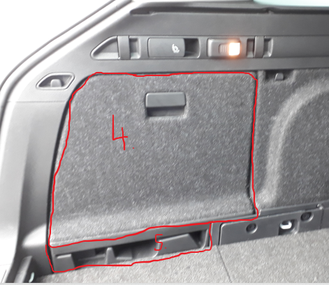

Let's try :)
1. Get some set of plastic trim removers
2. Take out all the floor panels. Usefull tips:
3. Remove the plastics from D pillar. Just get wide removal tool under the part and carefully take those away with it and your hands.
4. Remove side "door" by lifting it upwards and then 5. remove additional plastics under that. No tools needed and then you have access to subwoover.

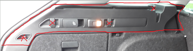

6. Remove the upper part of the side trim panel.
Three marked with X easily removable. The one screw under the hook marked with * see:
After all screws are removed you can the part off. You have to turn it little to get the front end come off between the C pillar and rear seat sidewall. There are couple short wires that you need to disconnect to be able to lift this aside. You can also disconnect the cable that goes to back seat folding mechanism if you wan't but I didn't do that.

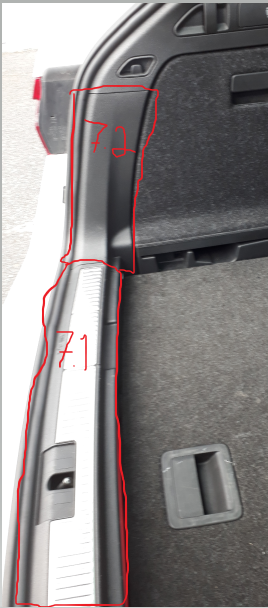

7. Remove plastic trims in below picture. First 7.1 by lifting it upwards and then 7.2. (This I don't remember if there was some screw but everything is well visible at this phase). 7.1. you can only turn aside enough that you are able to remove 7.2.

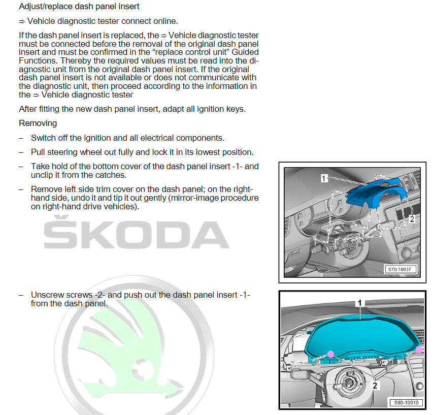

Some photos from my rattle removal from dashboard insert:
After split of the dashboard... Then top of the insert - all plastic connected pieces needs to be separated by tape. Be careful with removal of the 0.0 reset button.
Can someone explain how to remove instruments cluster? Thanks in advance.
This can help You
